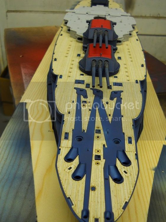

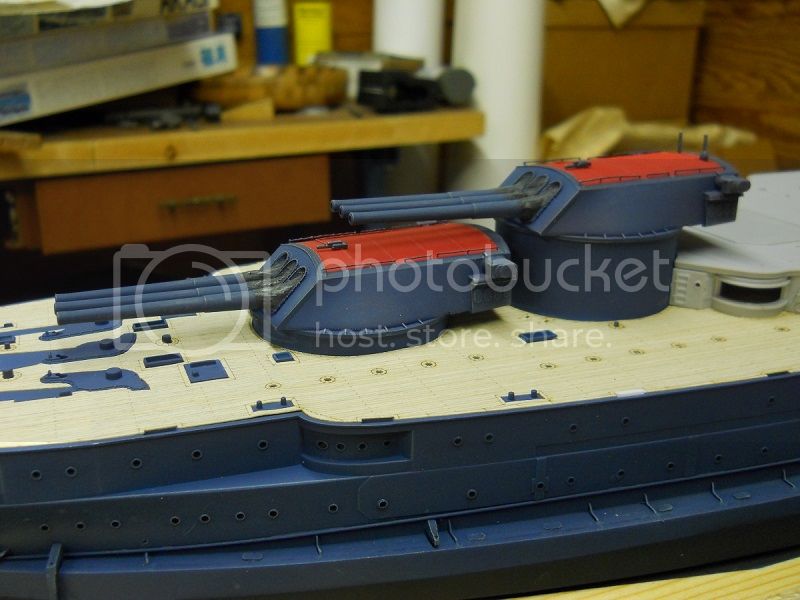

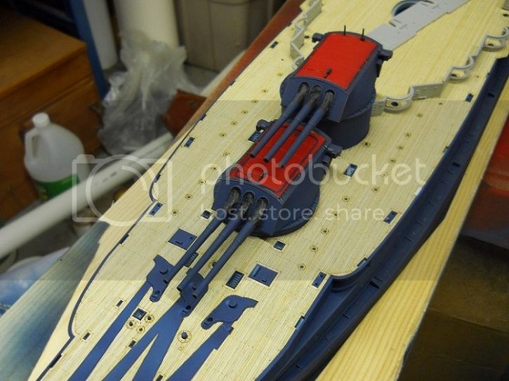

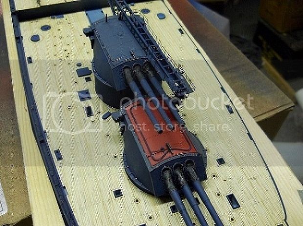

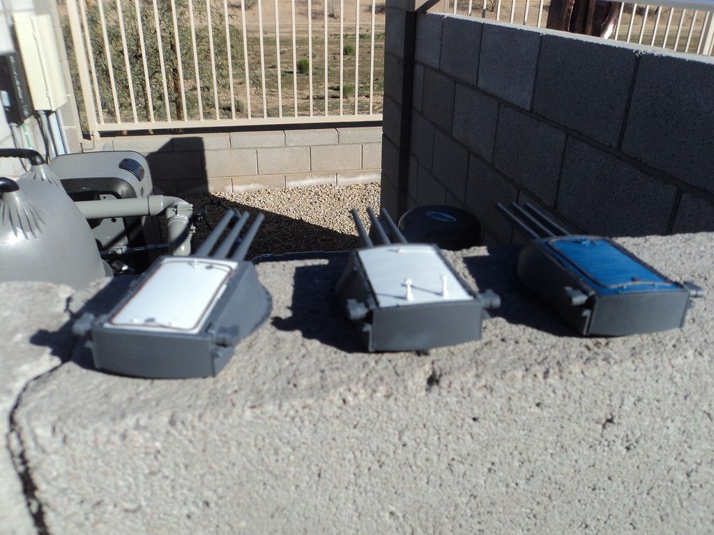

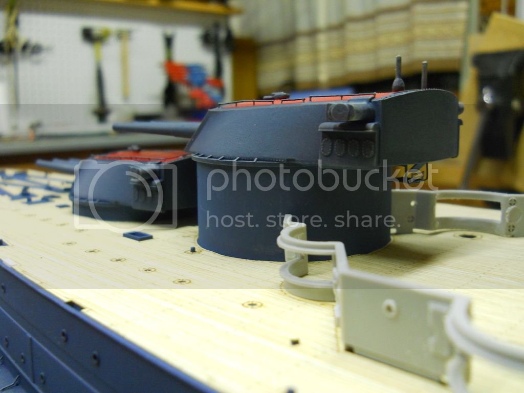

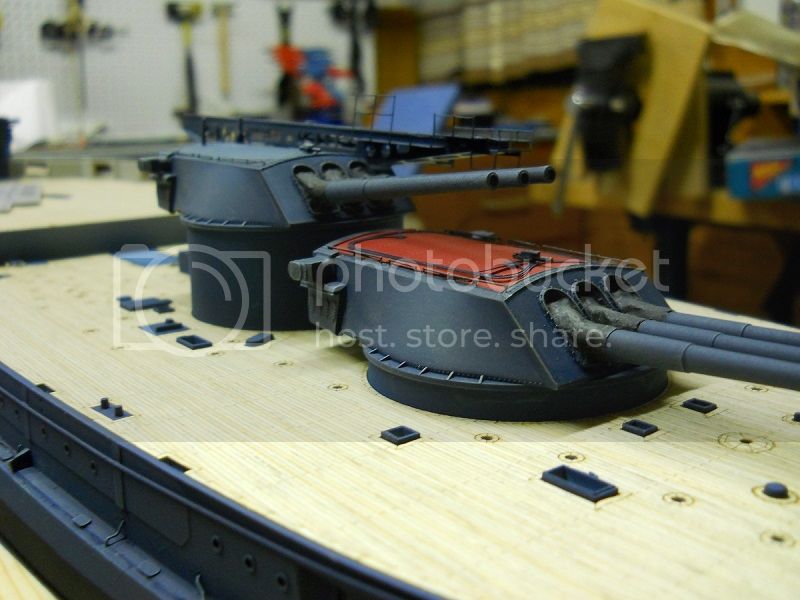

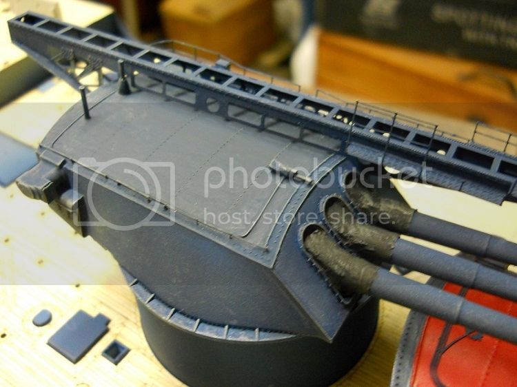

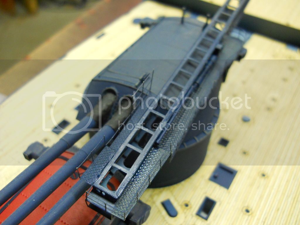

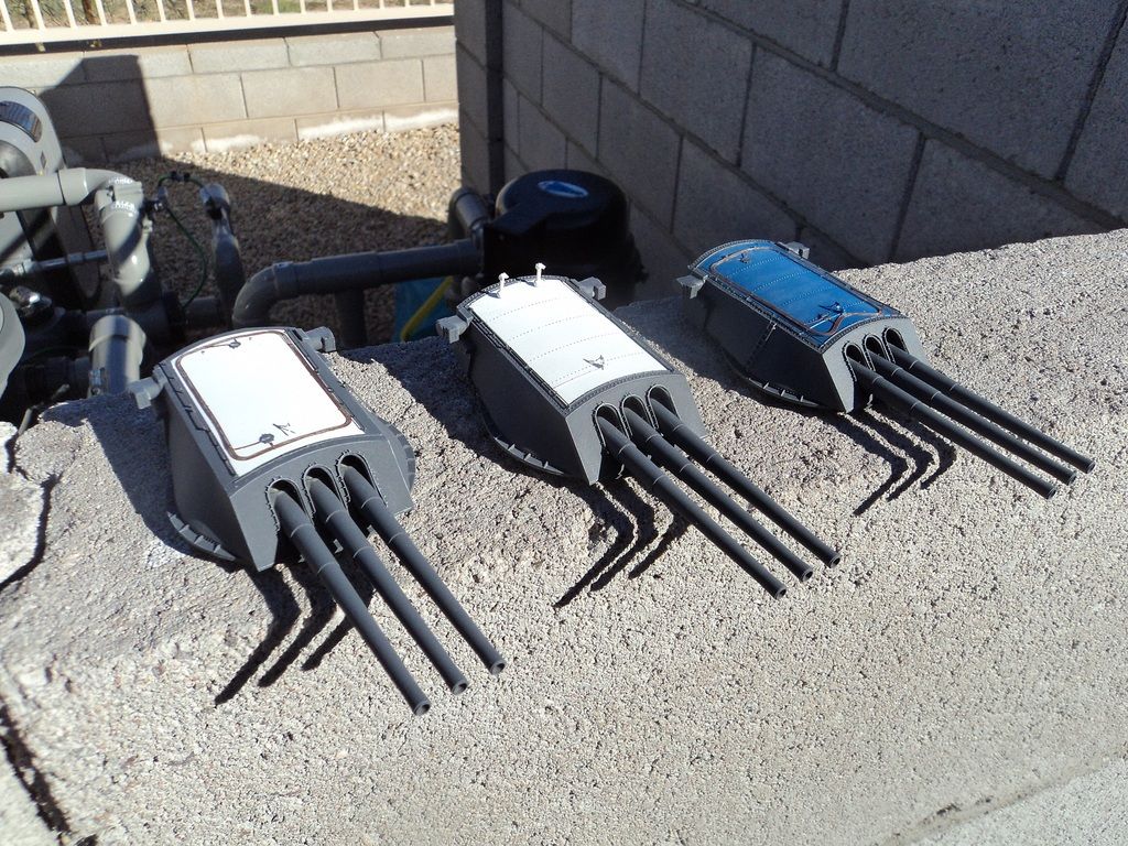

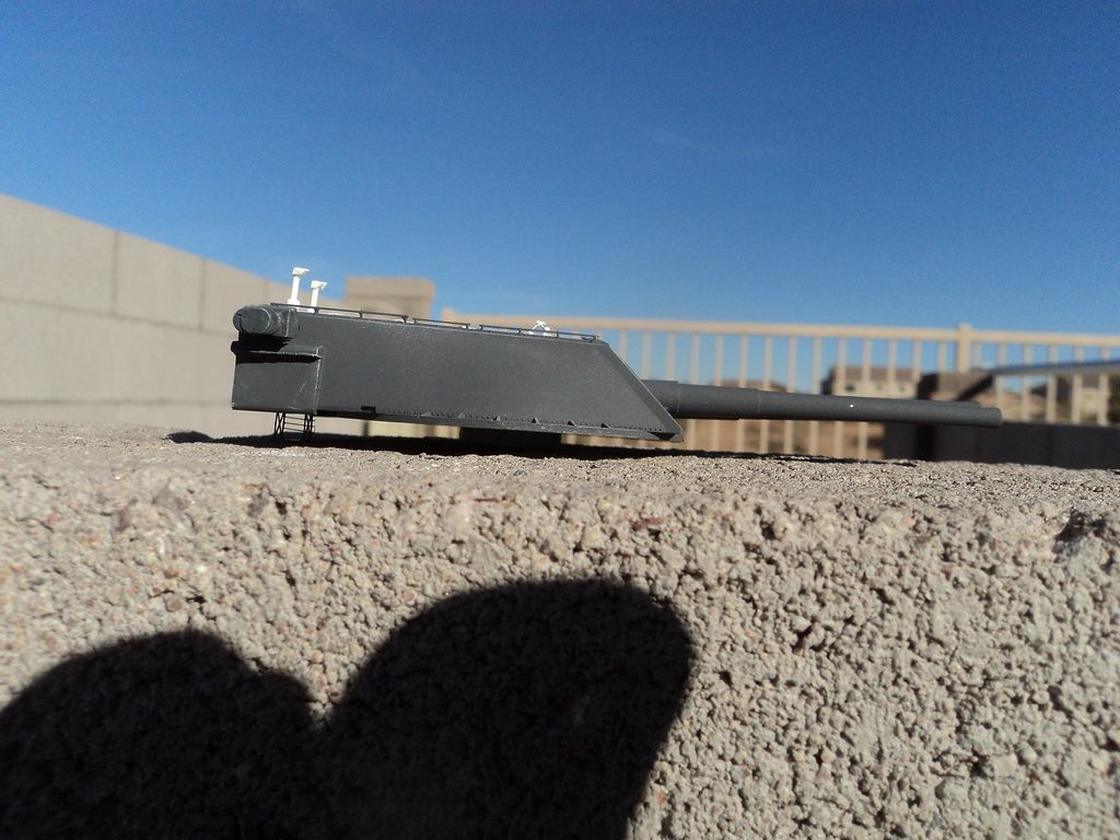

Okay, more work on the turrets. Pennsylvania turrets didn't have the vent access panels like Arizona had.
In the image below you can see that Pennsylvania's are smooth
Whereas Arizona's has the vents as seen in this imgage.
So, to more accurately represent Pennsylvania, I sanded off the vents as provided in the kit.
I also added an access platform for the #2 turret as you can see in the image above.
Pennsylvania was the third ship in Battle Division Two and the turret tops of #1 & #2 were painted white, #3 was non skid grey, although there is much discussion if this is correct, and #4 was painted true blue.
In the image below of the ship in dry dock you can see the top of turret #1 and #2 is white.
I added periscopes to #2. A bit out of scale, but I think once on the model and completed it will be fine.
As seen in the image of the ship at Pearl and other images during this time frame, the "bloomers" are off, so I left them off the model. I was going to use the Master Barrels, but to use them without the bloomers would require cutting the receivers and I didn't want to get into that, so I used the kit provided barrels.

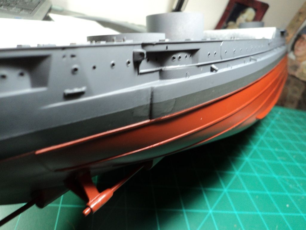

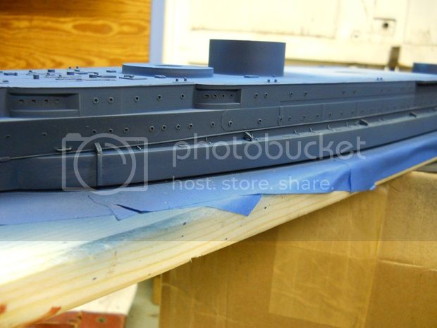

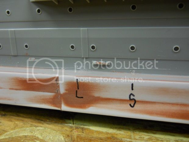

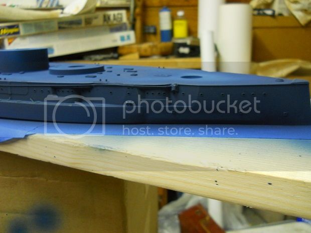

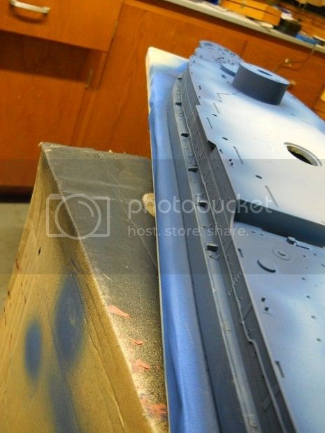

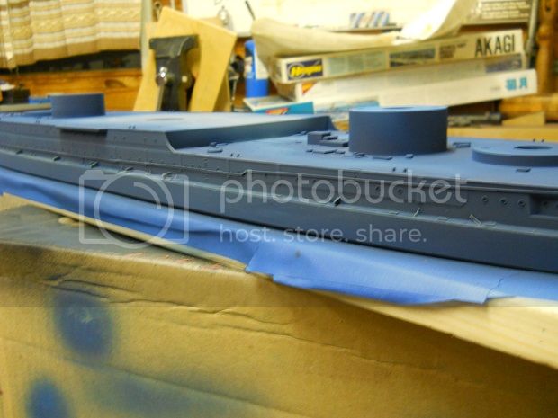

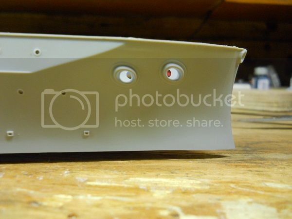

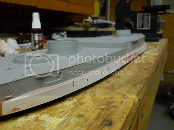

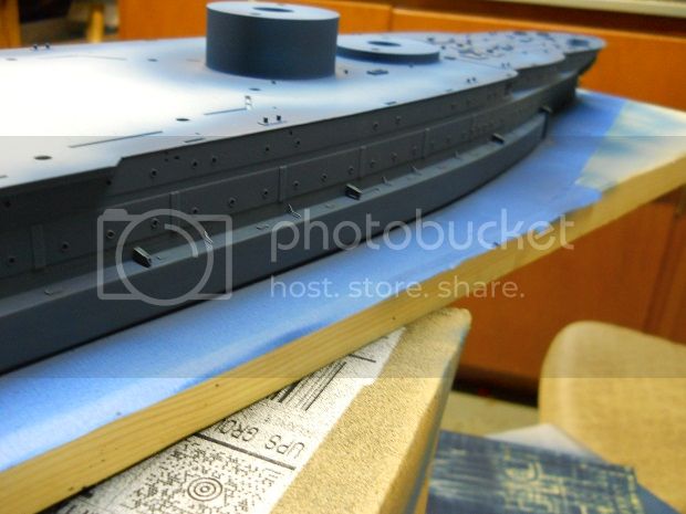

Thanks Dave for checking in and your comments. Accept for the overall appearance the ships are totally different in almost every respect.
The hull is a major difference between Pennsylvania and Arizona. Albeit similar, there are major differences. The most obvious is the way the torpedo blister, or armor belt, ends abruptly rather than being blended in like Arizona. The drawing below shows how it abruptly ends on Pennsylvania.
This is a very noticeable difference. My problem was how to achieve this. The kit armor belt is a little too narrow, so adding 1/16 strip and sanding it aft and blending it forward I was able to achieve. this.
If I did it again, I would probalby use a smaller strip below the boot topping but; I am happy with it.

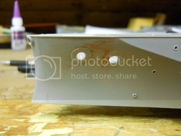

Visible in the image below is one of the two fuel stations as well. One of my porthole rings came off and I need to replace it.
In the image below you can see how the aviation fuel line returns to the hull with the apparatus as shown here.
Now that the hull is done, I can move on to the deck fittings.

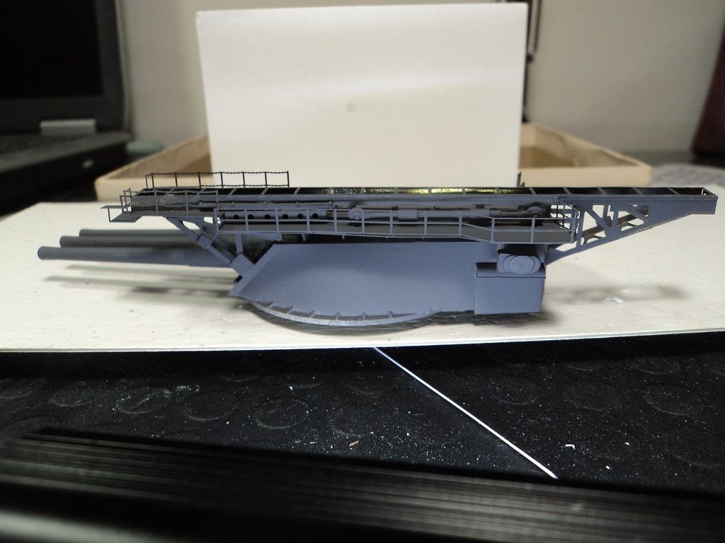

Mark was feeling kind of lonely, so I thought I'd post. Nothing worse than a lonely Marine..
After getting time behind the computer and then ironing out the picture posting aspect I'm ready to go. I guess I'll begin my postings by an overview of my model subject. I am modeling the USS Arizona in 1/200 scale manufactured by Trumpeter. Everyone should know about this model; it's been out(now discontinued) for awhile. I'm not going to get too much in the weeds about the inaccuracies of the kit in as much that I will add/correct any flaws as long as they detract overall. Basically if one can live with the flaw, so be it! One can get really involved in this kit with the corrections. The problem is progressing forward even when you uncover more info on some details you've already completed and moved on..

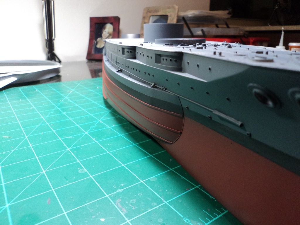

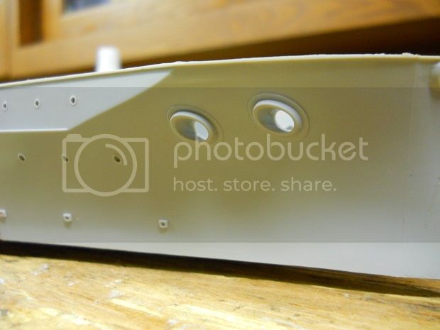

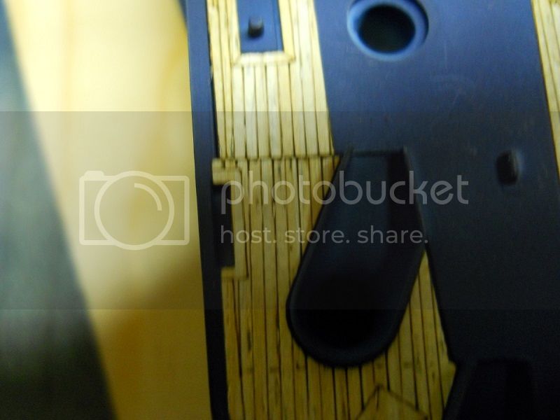

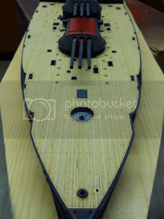

Okay....So to start, I'm trying to put certain points of interest with my progress reports, so it might seem I'm skipping a lot of the assembly. There have been many great builds and I encourage you to look into all modeler's creations.
The Trumpeter 1/200 Arizona when first look was that the torpedo blister depicted on the model wasn't wide enough. Pictures show a wider area with the downspout/scupper covers just falling short(about a scale foot-a distinct edge. The model shows more of an as built look. So I widened the sides. Another rather glaring error is the anchor hawse pipe hole which should have a flange in order to deflect water away from the hawse pipe due to the overhang of the foc'sle. Also the hole go strait though the sides when they should go upward in the track of the anchor.

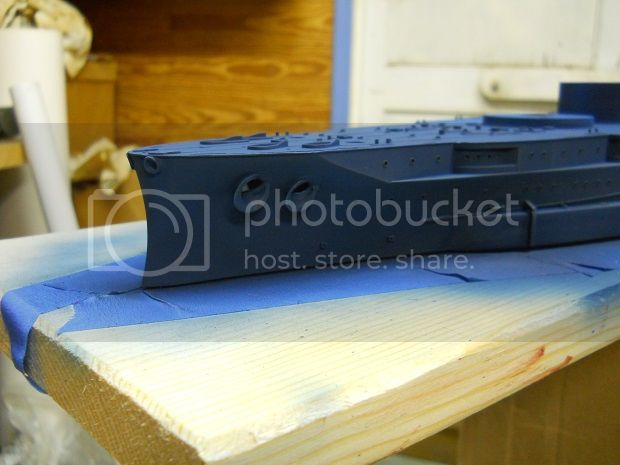

Also to note I added the aircraft fuel line on the port side and scratch-built the six hull staples and down spouts. Finished the blister with access hatches and additional pipes. Eduard makes the hatches and down spout covers, but I had already finished them and installed them when I received the PE set. Their hatches seemed a little too small so I kept mine on..

Hi Randy:
I like the hatches you put on the torpedo blister vice the Eduard ones. I used the Eduard ones and they are hardly visible. I especially like the treatment you did on the anchor hawse flanges. Nicely done. The extra piping on the blister is noticeable and adds interest to an otherwise overlooked area of the ship.
Nice to see your pictures here, I don't feel so lonely now.
