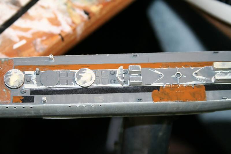

The upper decks on these vessels were covered in Corticene over steel decks, the strips of Corticene were not defined along the edges on the casting- I decided to achieve crisp edges by using the vinyl tape again cut into the appropriate sizes and shapes.
Were the Corticene was cut around bollards and deck fittings etc. I drew a line with a pencil to act as a barrier to the paint.

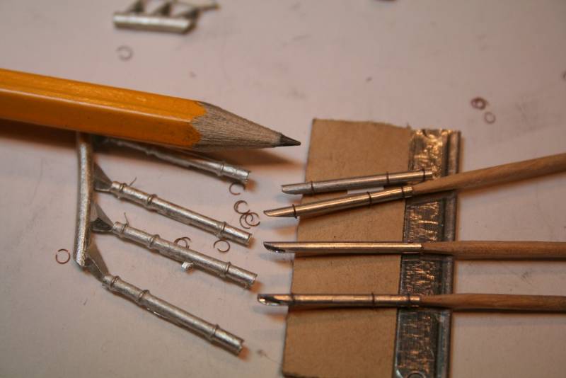

The kit’s torpedo tubes were cast in white metal; these however were not sharp enough for my liking so I elected to make replacements using aluminium tubes with copper wire.
The end result justified the effort...

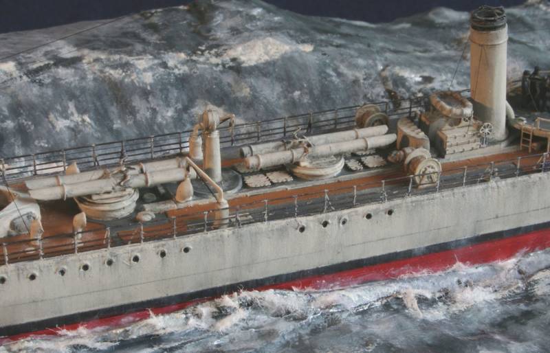

Another excellent built by Jim Baumann!
I've seen it at Telford last year and it has a very dramatic look - just missing the sea spray

VERY beautiful, another one of your fine grey beasts. First time i see this one btw, i would have notice otherwise as Mary Rose is the traditional product you put in children's hair when they have lice
Using some car repairing mastic for your sea you really have nerves, i used to use that to make some groundwork in dioramas, you can smooth it pretty efficiently while it's not completely set by using trichlorethylene but you seriously damage your health in the process.
