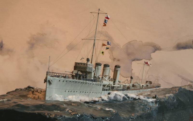

Building the model. . .
. . .was happily a pretty straightforward procedure!
Released around 1999, this White Ensign Models resin kit is now of the ‘older’ resin generation….The kit I built is from the ‘last-ever’ production run.
Nevertheless, the casting was sharp and the original mastering crisp. The kit was designed with a split hull allowing waterline and full-hull options. Although I wished to portray the ship afloat; having decided at the outset that I wanted my Mary Rose to show some lower hull in a long rolling swell-the inspiration coming from the front cover of the Anthony Preston Book, “V & W class destroyers”.

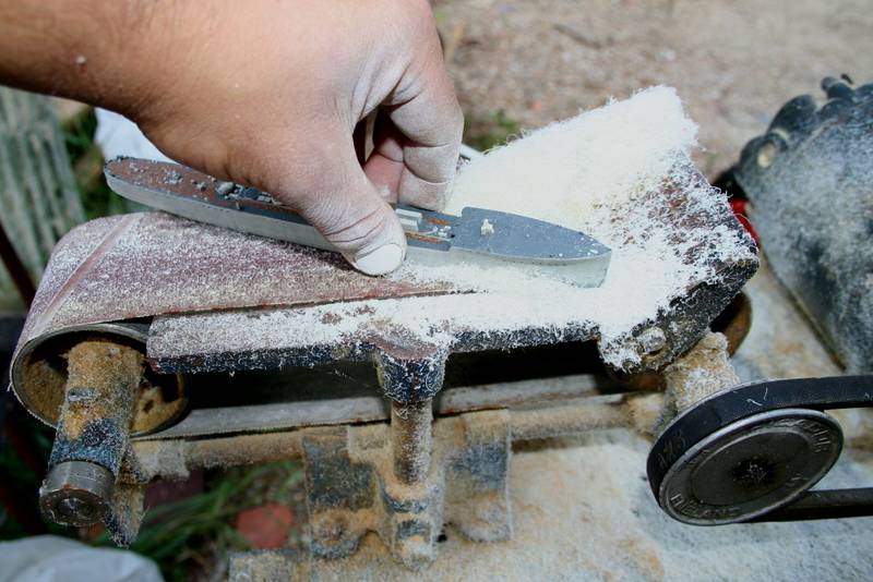

This was the first time I had ever joined an upper and lower resin hull-I was delighted with the excellent fit--requiring virtually no filler and only a slight paring away of the lower hull at the stern. The completed hull was then ground away in the appropriate areas using my belt sander so that the total height above the baseboard was not excessive.
Another excellent built by Jim Baumann!

VERY beautiful, another one of your fine grey beasts. First time i see this one btw, i would have notice otherwise as Mary Rose is the traditional product you put in children's hair when they have lice
Using some car repairing mastic for your sea you really have nerves, i used to use that to make some groundwork in dioramas, you can smooth it pretty efficiently while it's not completely set by using trichlorethylene but you seriously damage your health in the process.
