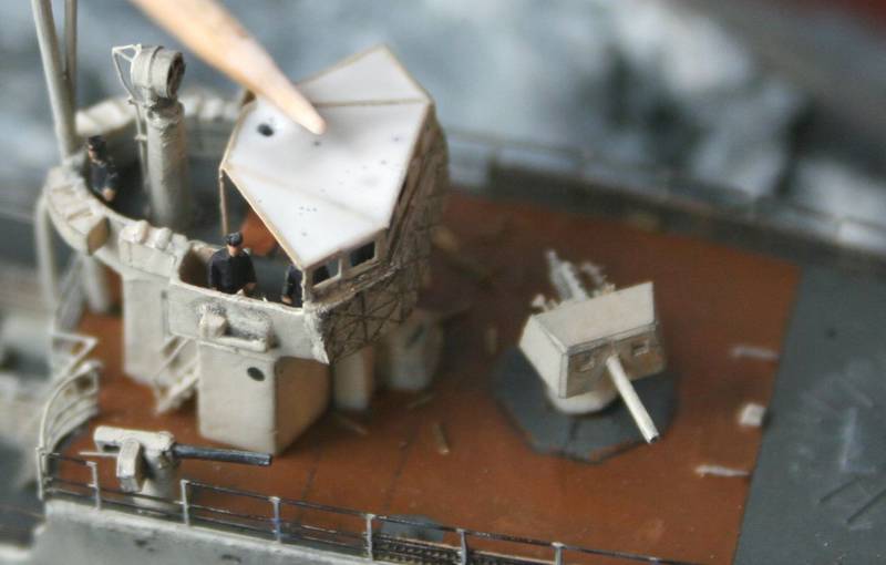

The PE awning frame was installed--in view of the inclement weather I decided to deploy the awning for my bridge complement! I made the awning using white glue to span the frame, when set this was painted in the usual fashion.

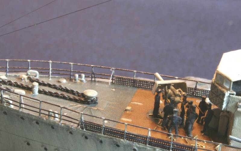

I chose to depict the ship engaging the enemy with her 4”guns, in view of the seas running the crew are unable to operate the stern gun safely. The usual maximum rate of fire was 13 rounds per minute using this type of gun, judging by the shell cases rolling around the deck they have been at it for some time!

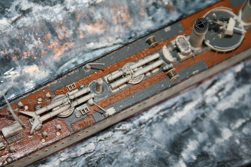

The searchlights were mounted on pedestals-they were operated via remote control rods. These rods were supplied as PE items, I felt they were too flat and fashioned replacements in copper wire.

The spume coming off the wave tops, curling bow wave and flying water-spray was simulated using torn paper and very very fine white fluff (from Tumble-drier filter after white towel wash…!)
