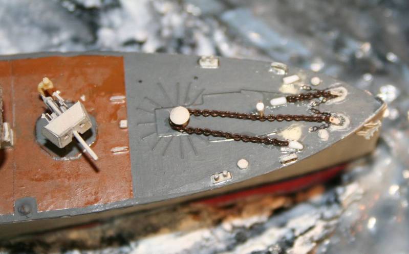

The Foredeck area was altered with a new capstan made of brass tube and an N-scale Model Railway Buffer , Sampson post and new anchor-chain hawse-pipes-the kit layout did not allow for the check-chains.

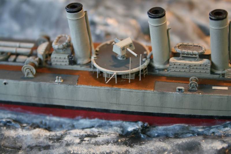

The cast cable-reels looked a bit small according to the Sambrook plan-I made some replacements using the GMM PE reel sides-the drums were wrapped in copper wire. The ‘bandstand’ for the midships 4” gun had support around the edges added using light grey stretched sprue-this was glued on at the base until perfectly vertical; then attached at the top using polystyrene liquid cement, once set the waste was simply melted off using more poly-cement.

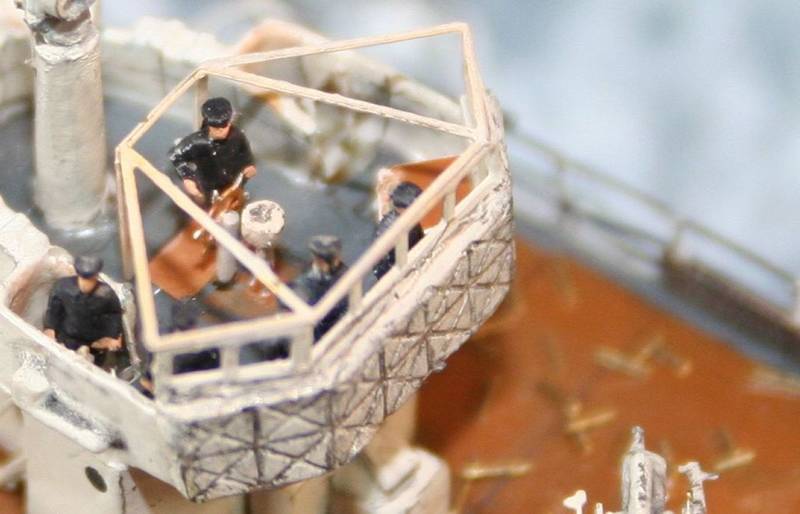

The bridge was detailed with chart-table, binnacle and wheel, officers and a rating at the helm...
(using the excellent resin 3-D figures from L’Arsenal)
