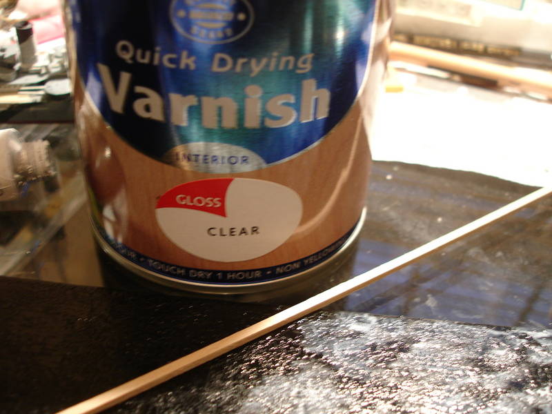

At last I added another coat of varnish which may be repeated as desired, but eventually its down to personal taste as to how you want to present the work - very simple as I have shown earlier, or with more effects - that only comes when you want to try a different approach. Don't be afraid to experiment!
