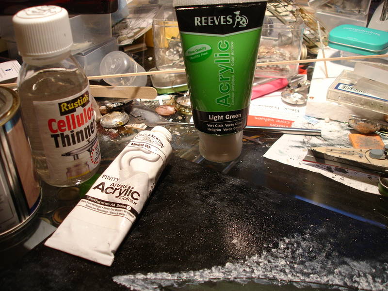

Also to help highlight the model around the hull, I use a green mixed with white to achieve the various shades of thin water mixed with the foam.
