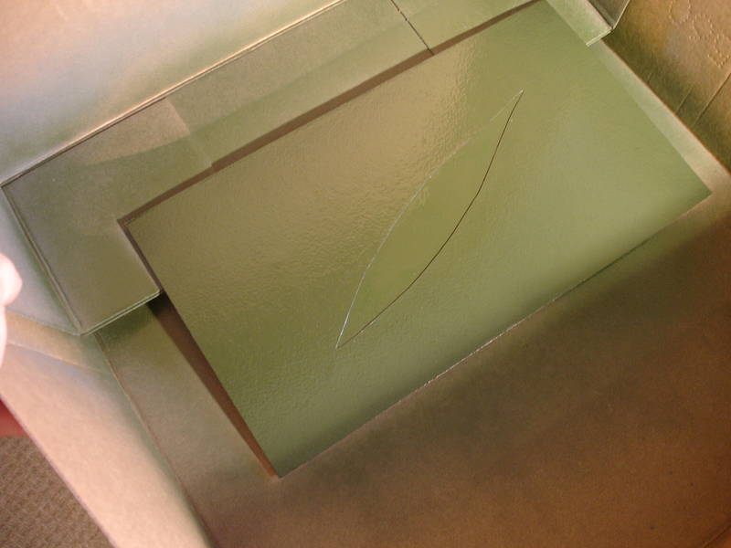

6. I've used Tamiya Dark Green TS-2 to spray the base - in my makeshift spray booth, and there it is - place the ship on the sea, and stand back to see if all is well - if you're happy, continue............

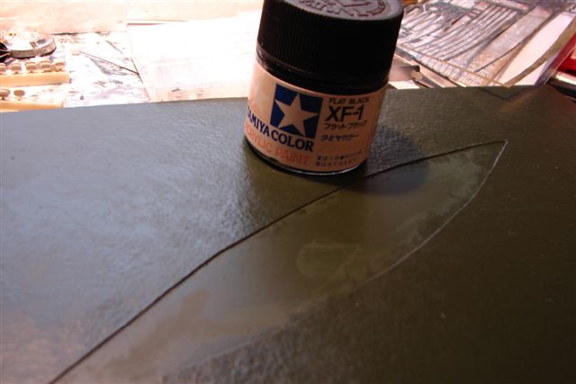

7. We will now develop the texture of the seascape with diluted Tamiya black acrylic.
