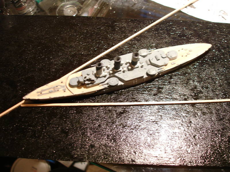

Looking through various books for examples of how the wake and other effects should appear, I have decided to have the ship moving at a reasonable speed through the water and thus create some foam and churn.
I have measured this out with wooden rods, to get the spacing and direction right, as they are easy to manipulate, and came to hand so there they are. I then applied the white guashe which is easy to use both with a normal brush, and some dry brush. The dry brush is exactly what it says, and gets the paint on very sparingly. Its like scrubbing the paint on to make it fade into the surrounding sea I've already painted.
