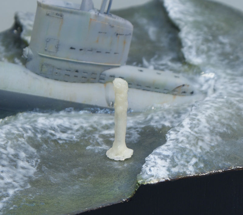

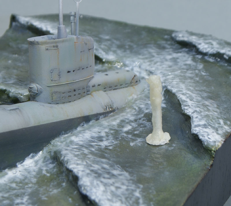

I have been experimenting with bullet splaches, the particular bout I am inspired by, was sunk by gunfire from Mosquitos - so I have been trying to create a collum of water using a toothpick painted white with som glued on cotton and a layer of clear acryllig gel.
The piece is not glued on, but the plan is to use gel to blend it in and some whitecoloured gel to create the foam around the hit - naturally more collums will be made to form a row of hits across the diorame - will it work ?

My inaugural entry for this campaign will also face up to violent water effects, so it will interesting to compare the results.

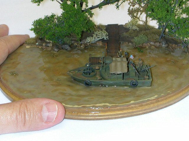

Hey Jan, I did something similar here.

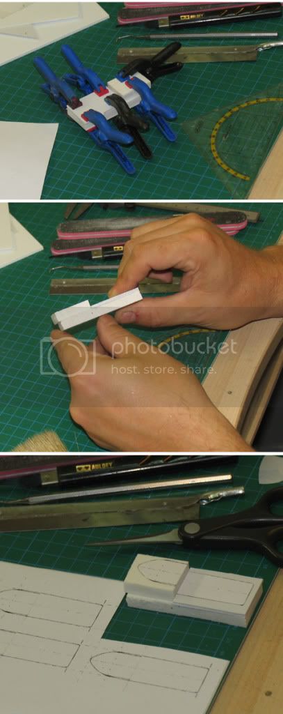

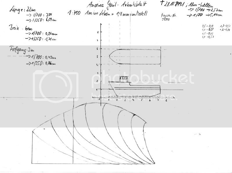

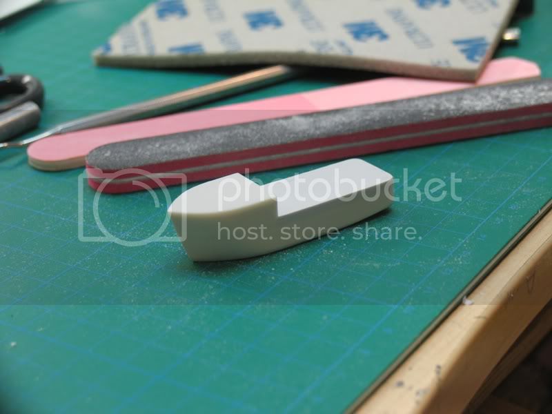

Since my last post, I spend some time researching the subject. Of cause the real Andrea Gail went down in the storm in 1991, and the boat in the movie was just a representation. Originally I was aiming at building the real Andrea Gail, so I tried find reference on the net. An evening’s research result presented me with only 2 pictures of the real AG. I was quite obvious that the real AG in her final configuration was completely different from the ship seen in the movie. The type of ship is not uncommon at all, but the AG was heavily modified by her owner. The available information presented me with too little reference to go for the real deal. So I decided to go along the lines of the movie vessel. Her real name is “Lady Grace”. Google her and the AG and you’ll come up with a whole set of good photos and reference, especially if you follow the links to other forum, which in turn, will lead you to private photo collections. Having such information aplenty, I started a worksheet to note down the dimensions and the relevant scale conversions
Pretty soon it became evident that 700th would be too small for my taste so I switched to 350th.

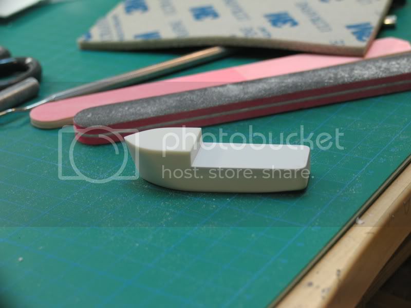

With the main measurements at hand I went to make a sheet “sandwich” representing the main 2 decks: focsle and weather deck. I took a scan of my overhead layout sketch, printed it on a regular sticker, which was then applied to the sandwich.

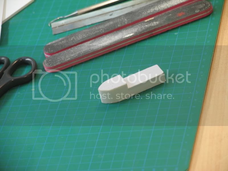

The rough shape was sanded down with a disk sander.
The shaping took me about 2 hours with a good set of sanding sticks and a smooth-over with a 3M wet-sanding pad.
I am quite satisfied with the result of my first ever scratch-built hull so far. Next I’ll have to fill the tiny gaps between the sandwich layers with putty and smooth it over again.
Wow! It sure feels good to be back in the hobby again and I think I’ve had a pretty good start.
TBC…
Guido

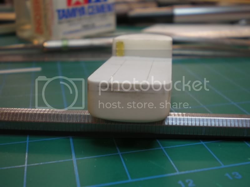

Gentlemen –
Thank you for your advices. So I’ll stick to posting everything here, but please don’t say I didn’t warn ye!

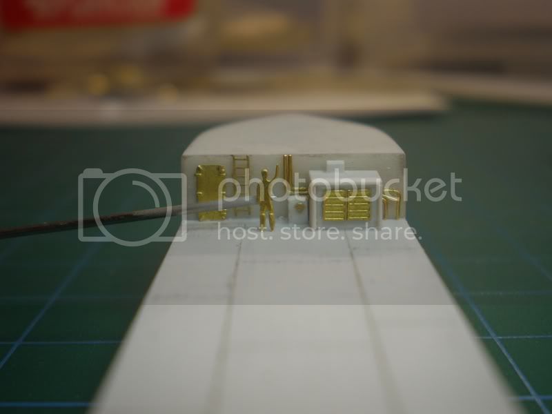

Since the AG will be placed in a seabed, I don’t have to worry about the lower hull features.
To get an even surface I glued a piece of sheet to the bulkhead and applied a GMM WT Door to get a sense of scale. In a next step I scribed an uneven pattern of steel deck panels onto the weather deck (made visible with pencil dust for you) and cut the fishing net chute into the stern. Then the chute is covered up at the deck again, as it is not in used on those swordfish boats.

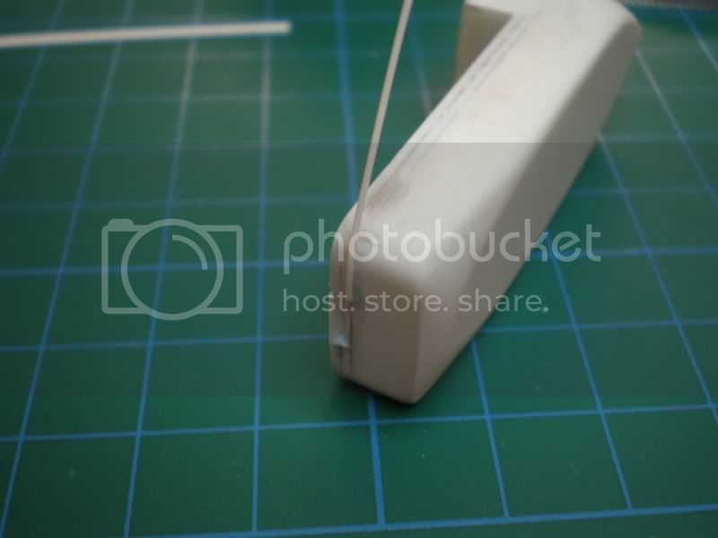

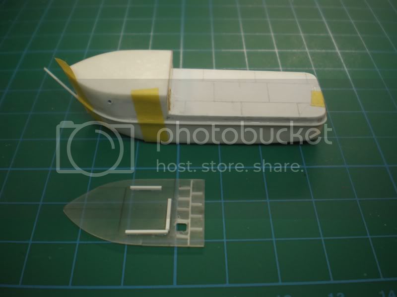

Next would be the bumper guards around the hull. The sandwich structure of the hull provides me with a good guiding line for the lower bumper guard. I attach a .5 mm round strip from Lion Roar on the stern and let the glue cure thoroughly.

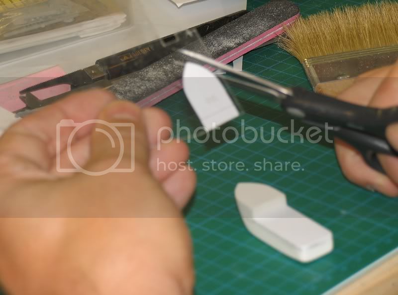

While the glue cures, I start the upper deck construction. I had trace the focsle shape onto a piece of paper, which I scanned and scaled down until the shape was just a bit smaller (about .05mm along the leading edges) than the actual focsle of the hull. This deck shape was extended by the overhanging part into back. Again I printed the shape onto a paper sticker, applied it to styrene sheet, cut it out, and smoothed the edges over.
Oops! Sorry for being out of focus on this one.
Now the fist portion of the bumper guard has dried, so the balance portion can be fixed. Even though this lower bumper guard does not extend fully around the hull on the original vessel I still make it like this here first. It will be cut to proper length later.
Curing time again and I turn back to the upper deck. The cut-out for the access ladder and the various drilling spots are marked down same as the basic shape and positioning stubs of the wheel house are put in place. Support struts according to the reference at hand are being put in place underneath the deck overhang.

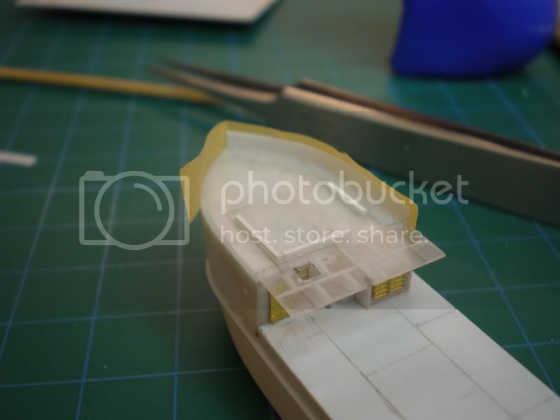

While the starboard bumper guard is being glued on, I use the time to get some detail onto bulkhead. Bit and pieces are being taken mostly from Lion Roar 1/700 PE sets.
See George Clooney visiting the construction site?

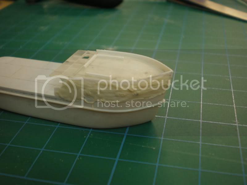

With all this done I glue the upper deck in place. You remember I made he deck a tad bit smaller than the actual focsle deck? The reason being that it creates a perfect little ledge for positioning the focsle’s bulwark. Of cause it is necessary to keep the styrene strip in place using masking tape until the glue has fully dried.
As hardly anything is perfect, there is a gap and a ledge that needs filling around the bulwark-deck seam. I apply Tamiya putty liberally.
This’ll need curing until the morning, so I close for the night!
I hope you like the report. Of cause I’ll be happy to answer to questions and comments.
Guido

Guido,
Yeah, I have several photos throughout some of our previous builds. Attached you will hopefully see my 1/144th scale scratchbuilt PBR diorama. While it may not be the best, it really was a lot of fun. Take it easy.............Bruce

Bruce,
That little dio is very nice. Is it all scratch built?
