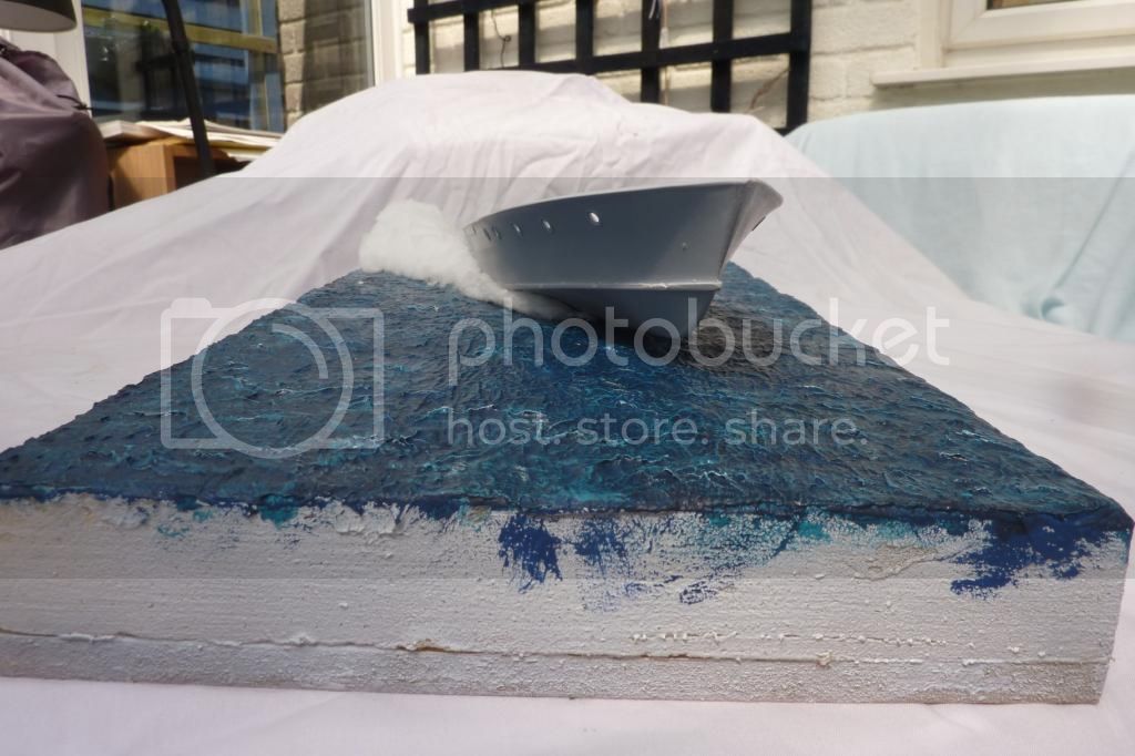

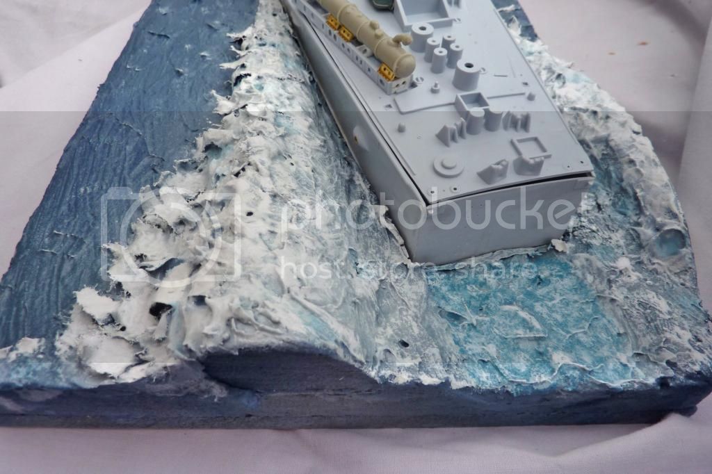

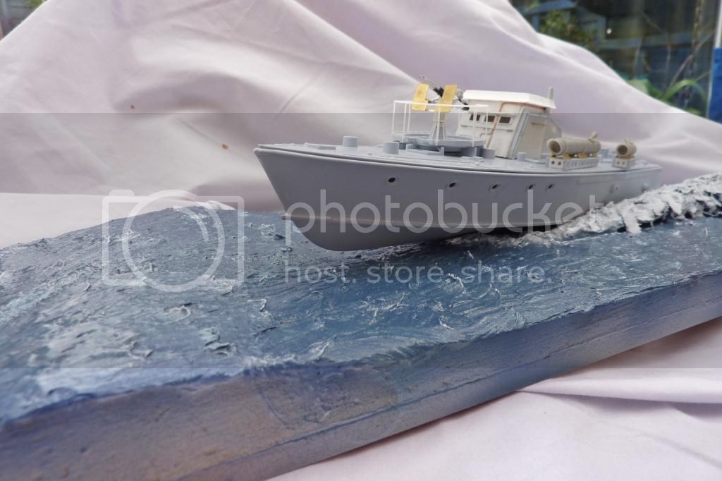

Got up this morning and I wasn't as happy . . . so further touches
The white foam has beeen picked out in pure white
The aerated water from props has been picked out in paler/greener blue
I've used acrylic structure gel to give more bulk  to the foam and tiny wavlets over the sea. Tried it before and it acted like self levelling compound, I guess because of the heat so base and gel went in fridge ;o)
Happier now until tomorrow morning lol
Thanks for looking, hope its looking better
Cheers Kev
Posted: Monday, July 28, 2014 - 08:07 AM UTC
Great stuff Kev,
The wake is really excellent, as is the work on tubes, and all of it really.

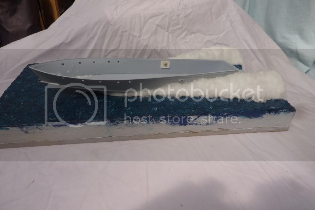

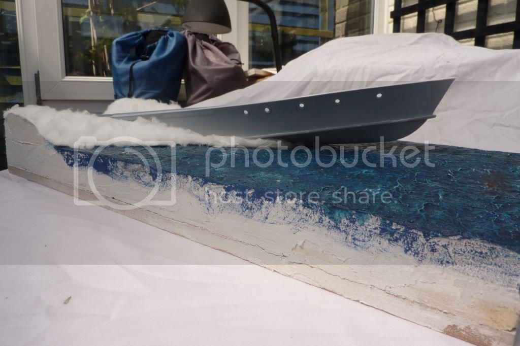

Posted: Monday, August 11, 2014 - 12:53 AM UTC

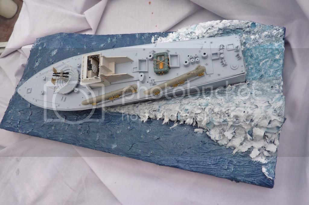

Right here we go again ....

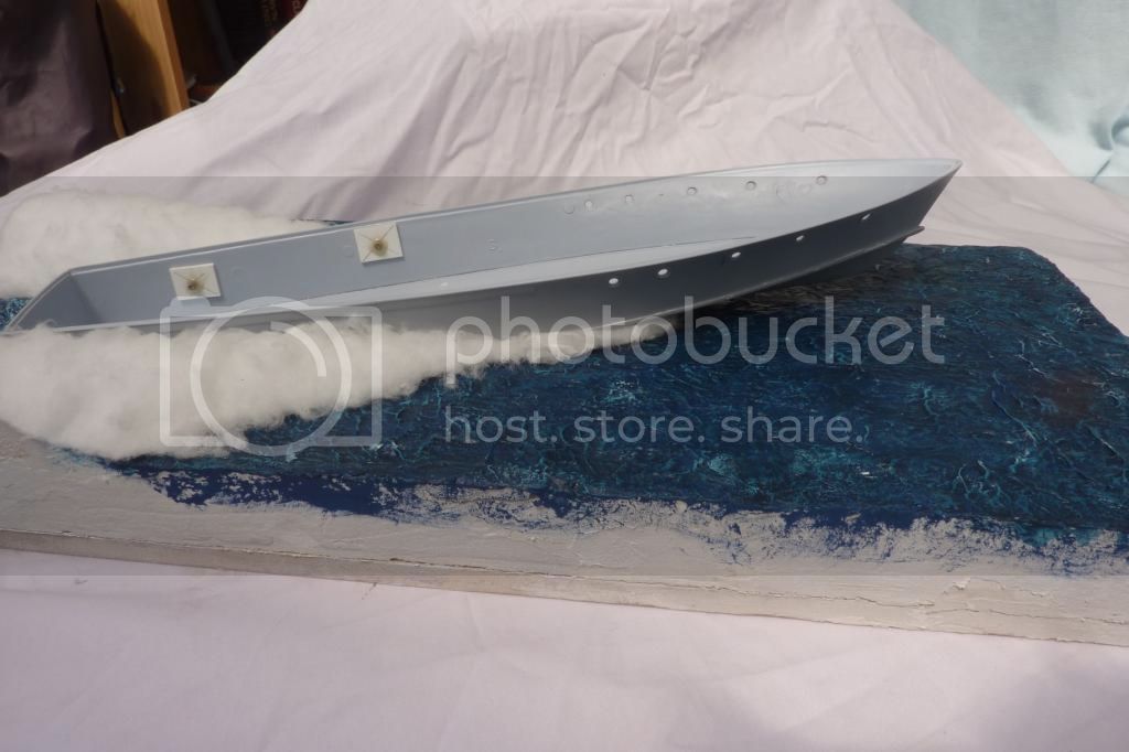

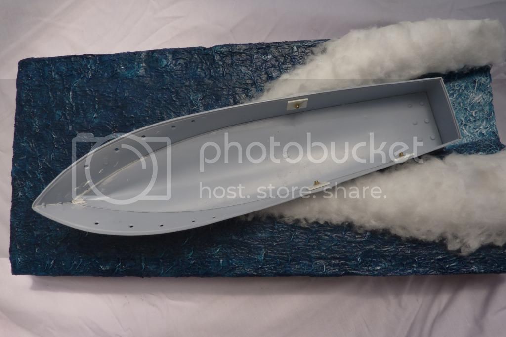

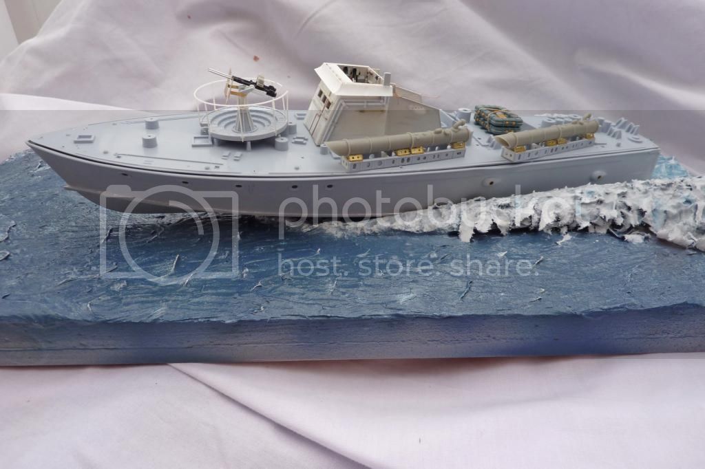

Felt the need to try the seascape using cotton wool
I would appreciate your comments as to which you feel is better
Thanks for looking
Cheers Kev
Joined: January 21, 2008
KitMaker: 2,531 posts
Posted: Monday, August 11, 2014 - 05:52 AM UTC
Hello Kev, I liked your original effort, except around the edges of the wake. It looked a little too 'ragged' to me. The second one looks better I think, more realistic. However, if you combine the look of the second with the first, I think you have a winner.

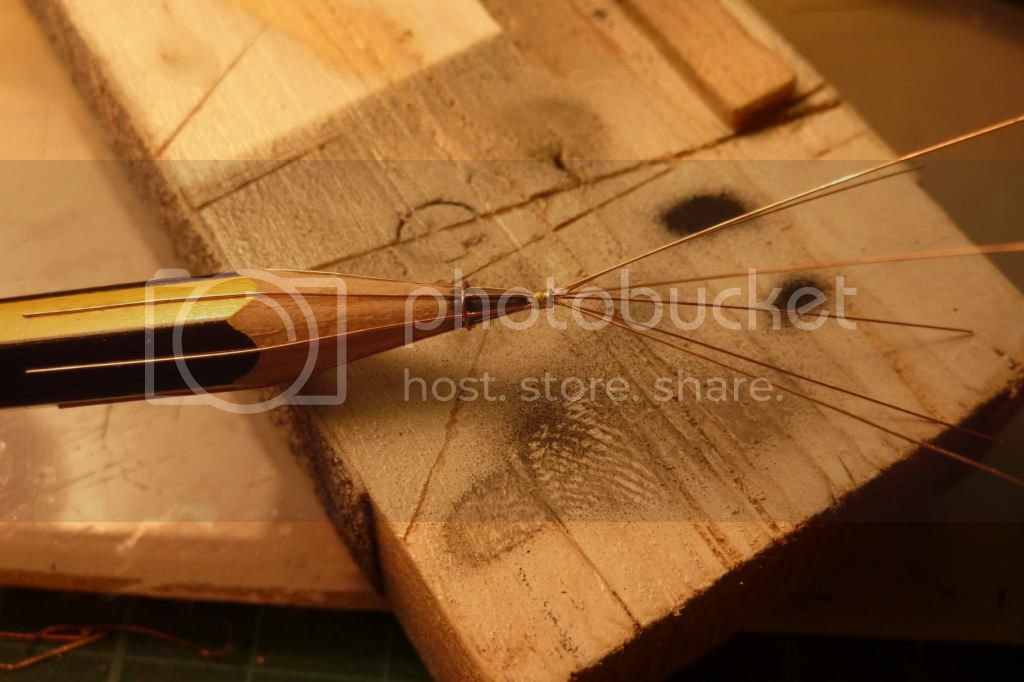

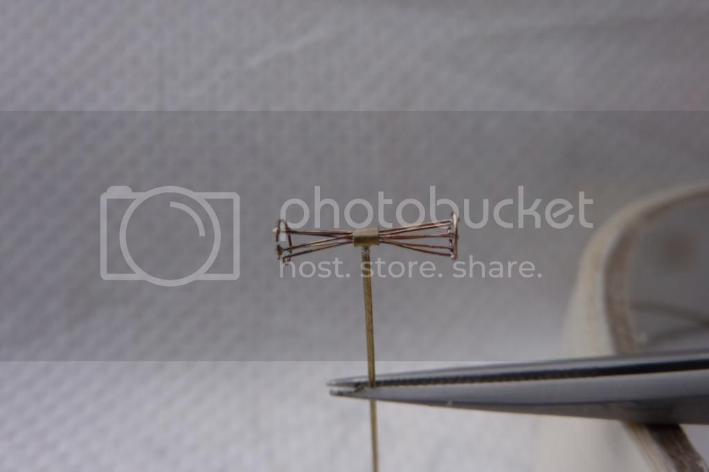

As I'm sure you can imagine the Airfix aerials leave a lot to be desired, here is my attempt at Type 253 IFF transponder
Dimensions 10mm x 2.5mm diameter, made from 0.2mm wire. After trying all sorts of methods I bit the bullet and bought Carrs Solder cream . . . can't wait to try it on some photo etch.
Thanks for looking
Cheers Kev

Then went on to play with the rest of the aerials
Type 242 IFF Interrogator, Type 253 IFF Transponder & the two parts of Type 291U
If anyone is interested here is how I jigged them up
Thanks for looking
Kev

Stunning detail work on the aerials Kev some great tech tips to work with and try out.

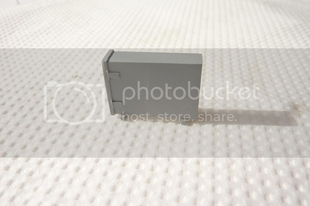

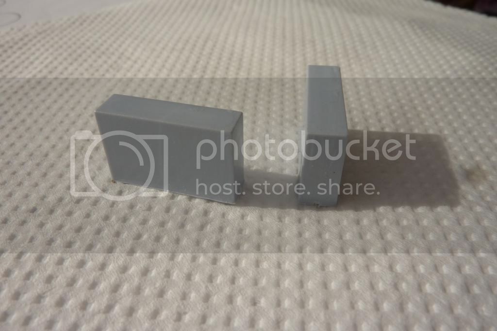

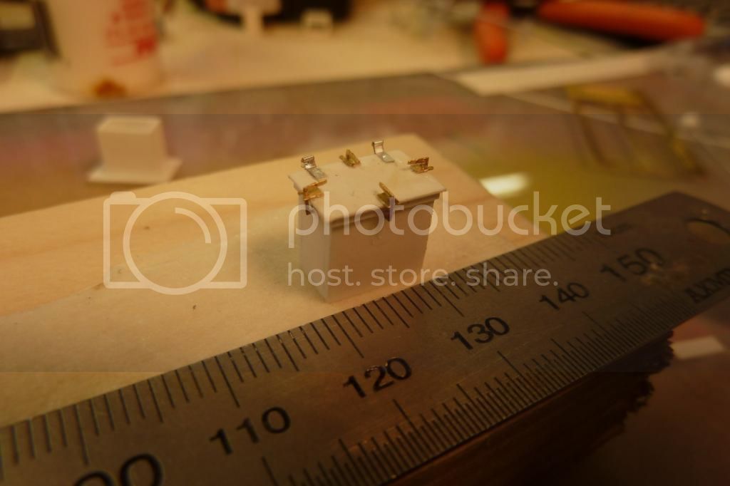

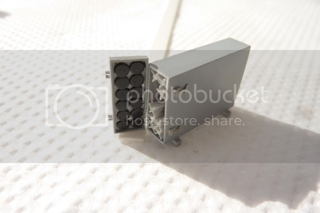

Rocket flare stowage now, the kit offering being somewhat bland !!
Of course I had to, didn't I?
Then I just had to take it a step further
I must admit I do enjoy the scratch building
Thanks for looking
Kev

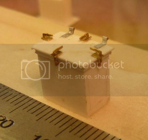

Posted: Wednesday, November 12, 2014 - 01:38 AM UTC

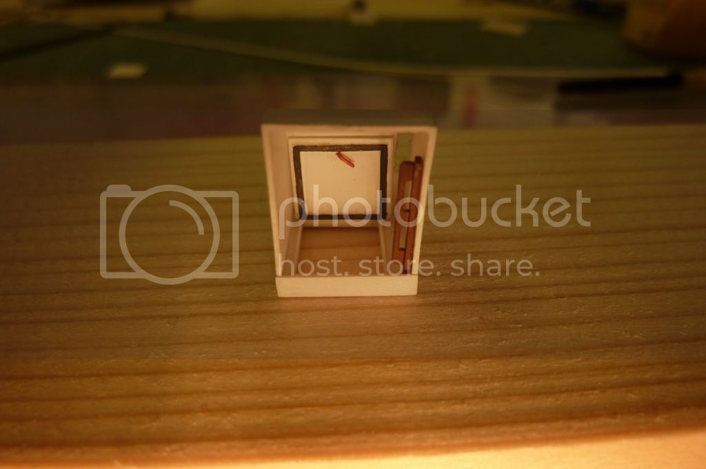

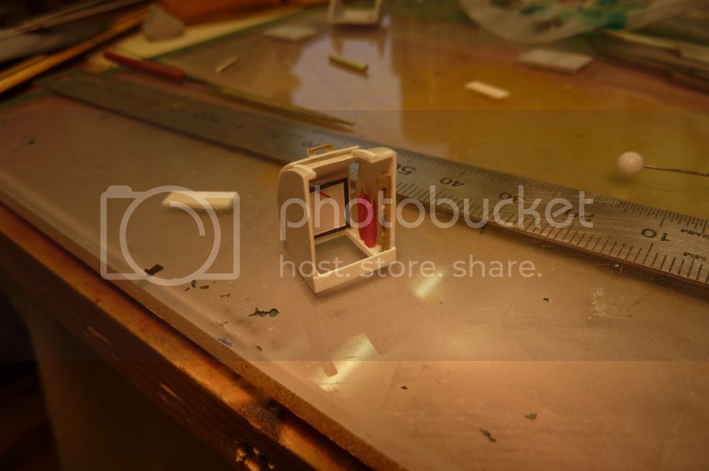

Thought I'd better update the build

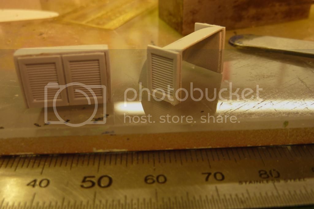

My interpration of the ready use lockers
Crew companionway
Airfix
Home grown
Thanks for looking in
Cheers Kev

Kev, superb scratch-building skills. Definitely a silk purse from a sow's ear.

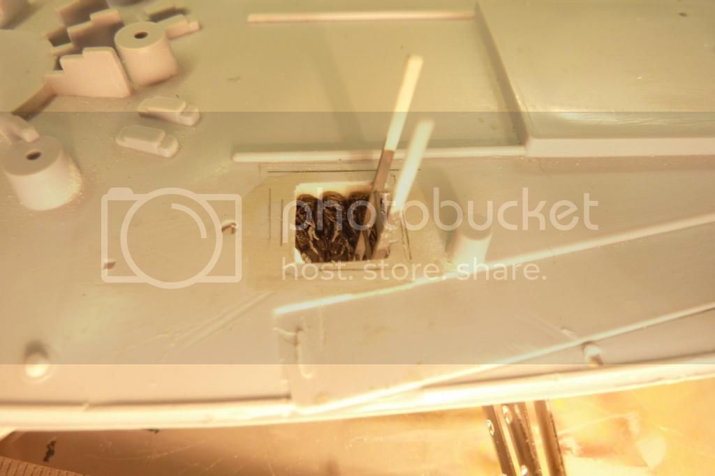

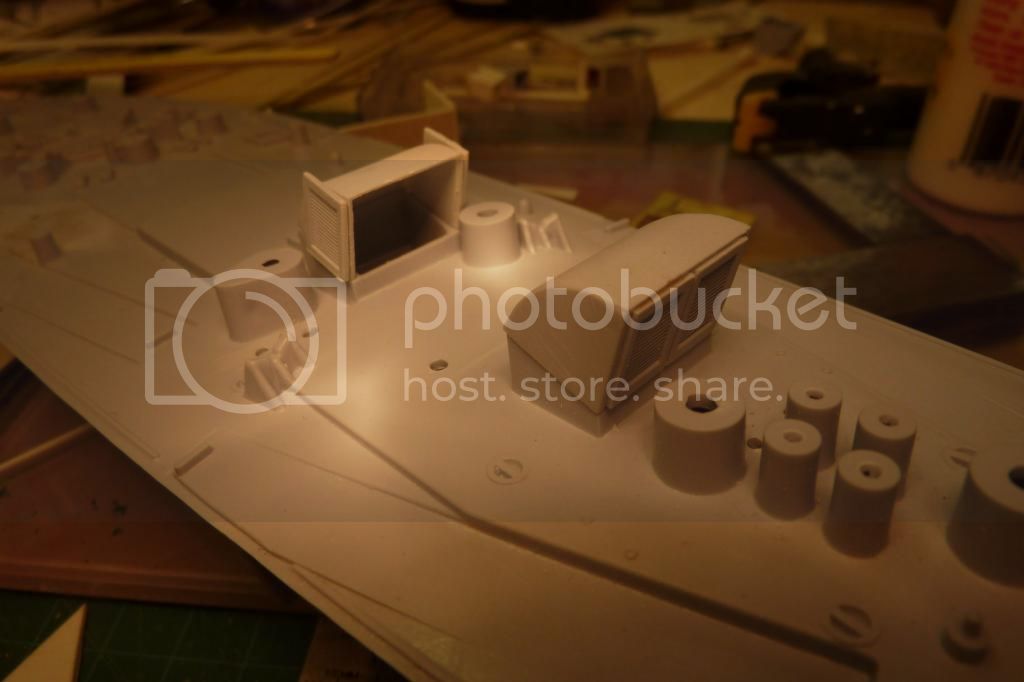

Not a lot Si, so far I've used the hull, deck, vents, gun platform and torpedo carrige but you've got to start somewhere

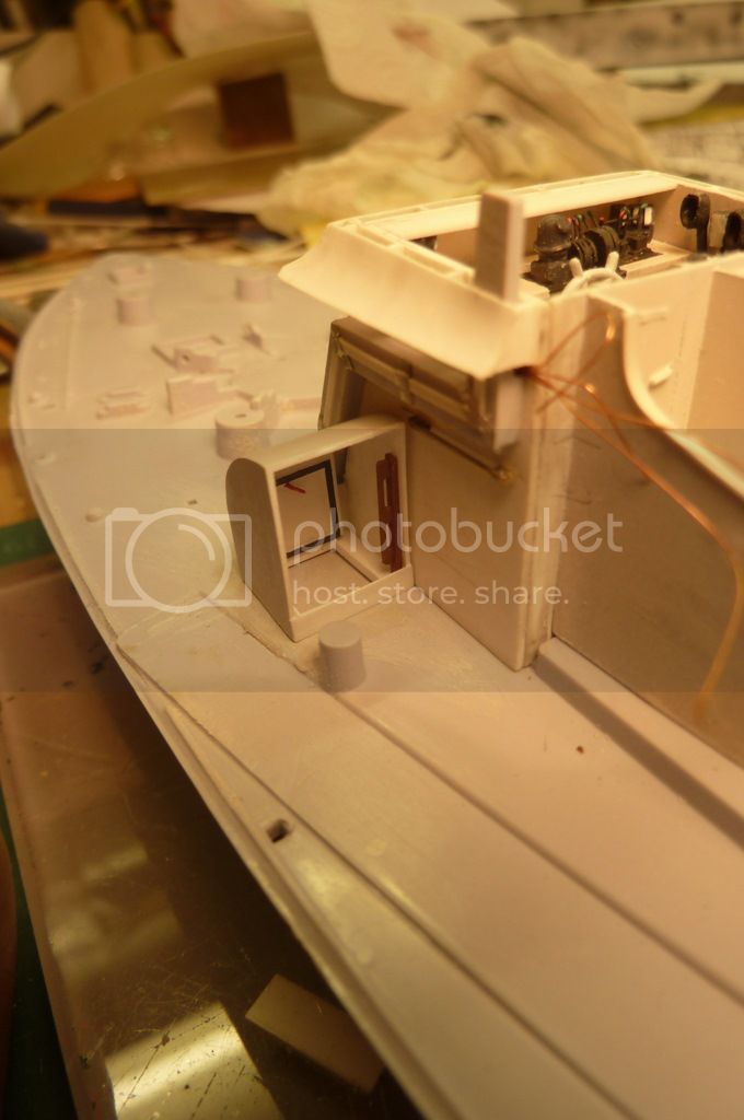

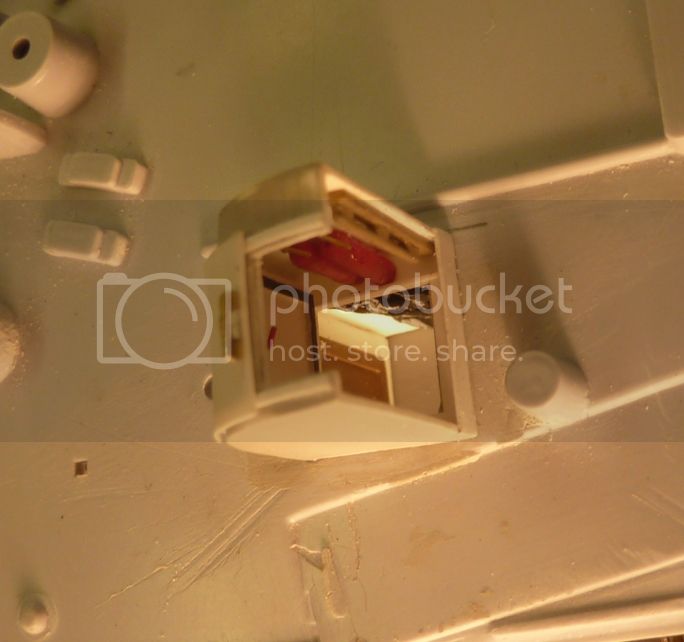

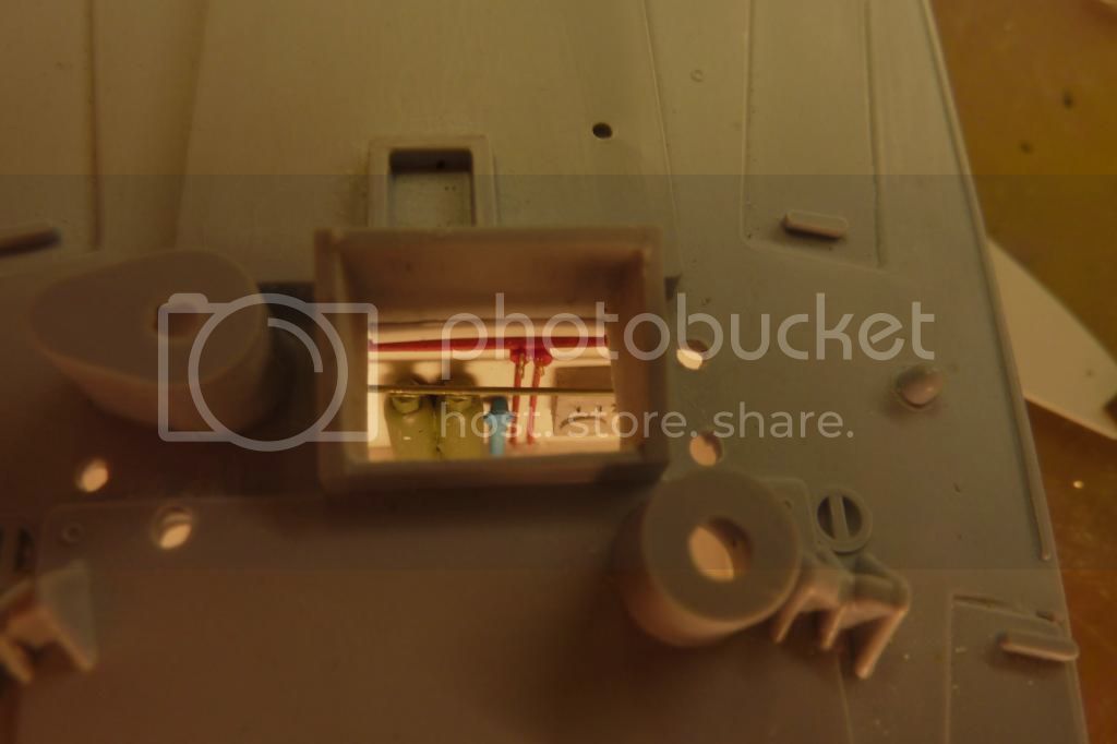

 Engine companionway/vents sorted. I originaly thought I'd have both open, then common sense prevailed
I would of course have to have the space open. The aft one would reveal the engines . . . . not going down that road. The fwd one only reveals the forward bulkhead.
So a bit of creative 'gizmology'and we have
I can't get a pic with the canopy in place. . . . just how much can be seen . . . . not alot
I guess I will now have to do something creative iwo of crew companionway.
Thats all for now, thanks for looking
Kev

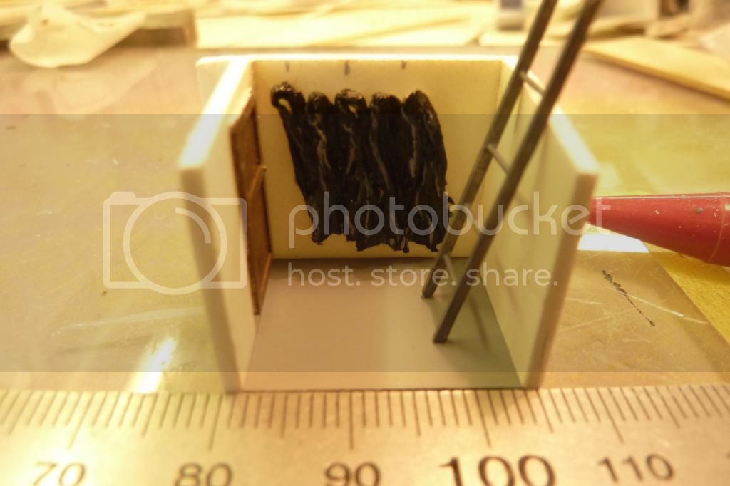

Onto the crew access, adding a bit of detail
Note the waterproof coats are meant to be hanging at an angle because of the angle  of the boat to the water
The ladder is one I had, can't really sort it until pod is glued to deck
Thanks for looking
Kev
