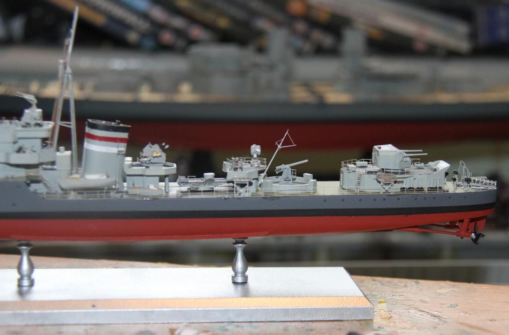

Maindeck railings going on, I don't like long lengths, cutting into shorter sections makes application much easier.
The glue marks will be taken care of with a mist coat of Tamiya Flat clear at the end of the build.
One side finished in four sections.
Once both sides of the maindeck were done, and a few other small sections of railings. The Pennant numbers have bee taken from the Hawk decals sheet for British & commonwealth escorts.
just the rigging to finish now.

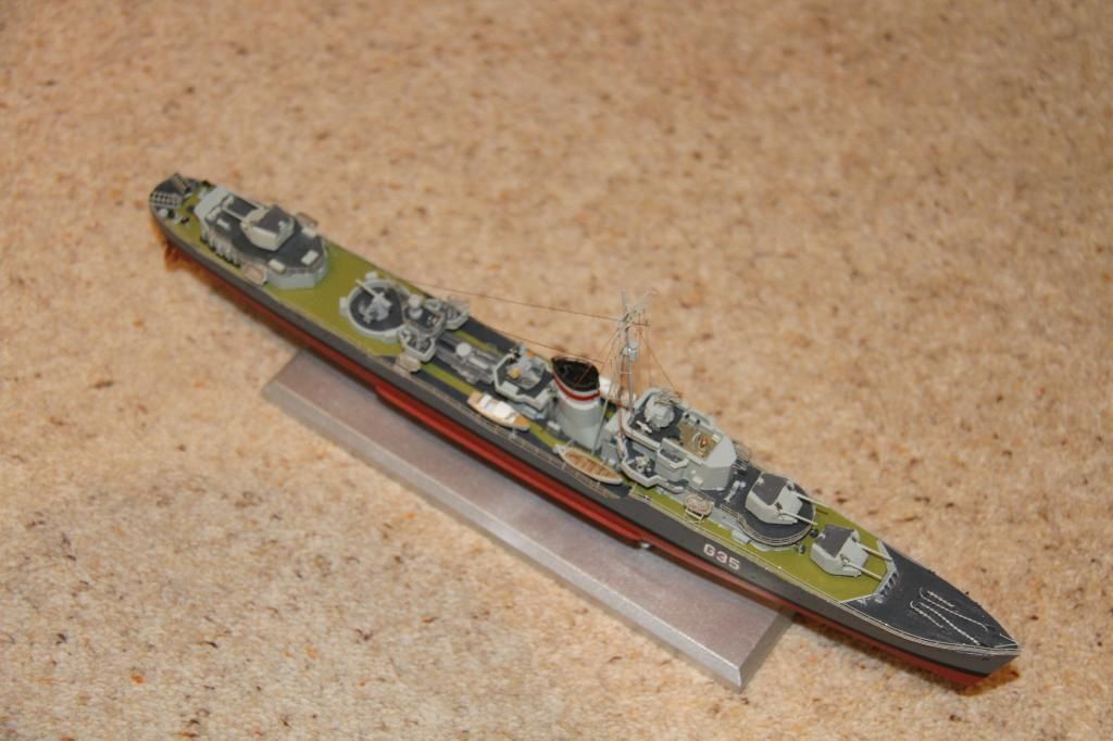

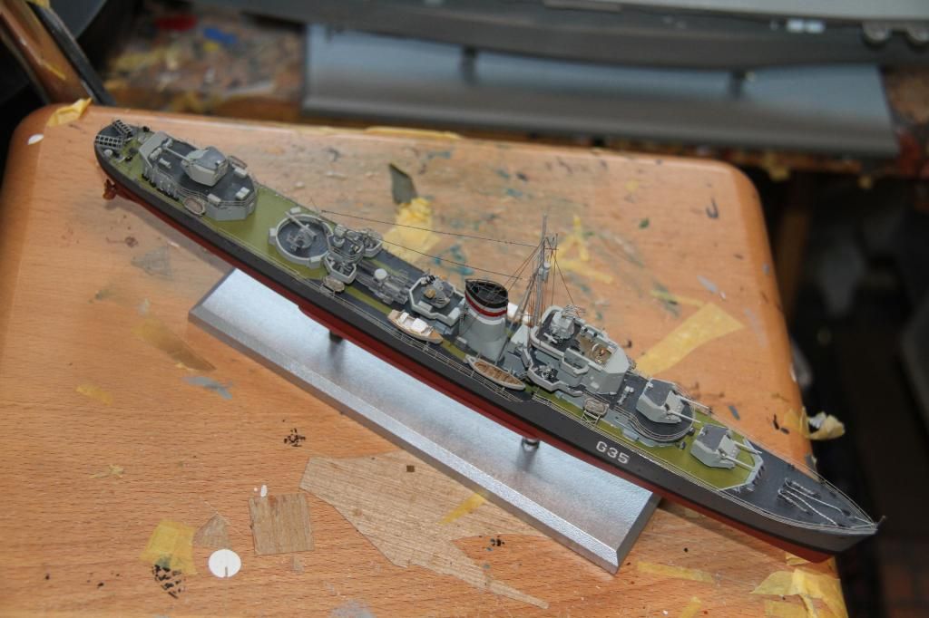

Posted: Sunday, November 30, 2014 - 01:24 AM UTC

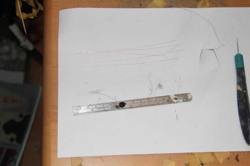

The Final push,
straightening the copper wire to use for rigging.
From what I can see from the photographs of the Mclass the rig is fairly simple, so I have added some stays to the foremast and a couple of aerials.
All done
Or so I thought, till I looked at these pics posting them, I have forgotten to refix the Type 286 scanner. Will do that & take another shot.
All done

How do you straighten the stuff?

Posted: Tuesday, December 02, 2014 - 01:52 AM UTC
Hi Keith,
Thank you, I started with copper wire because I had it around, and had just had a disaster with a lycra based thread. Works for me.
Hi Joe,
Thank you, straightening is quite simple, a firm but not hard smooth surface, and a steel rule, just roll the wire back and forth under the rule, and it will straighten. The great thing is, if you bend a section trying to fit it, just roll it again.

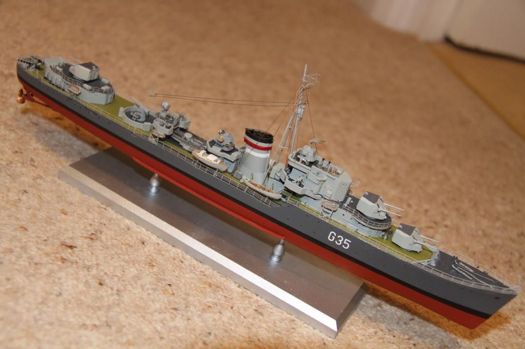

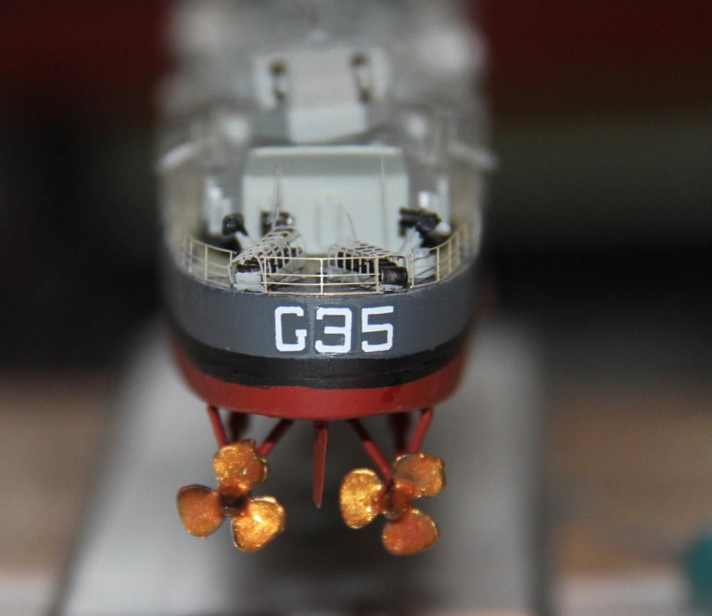

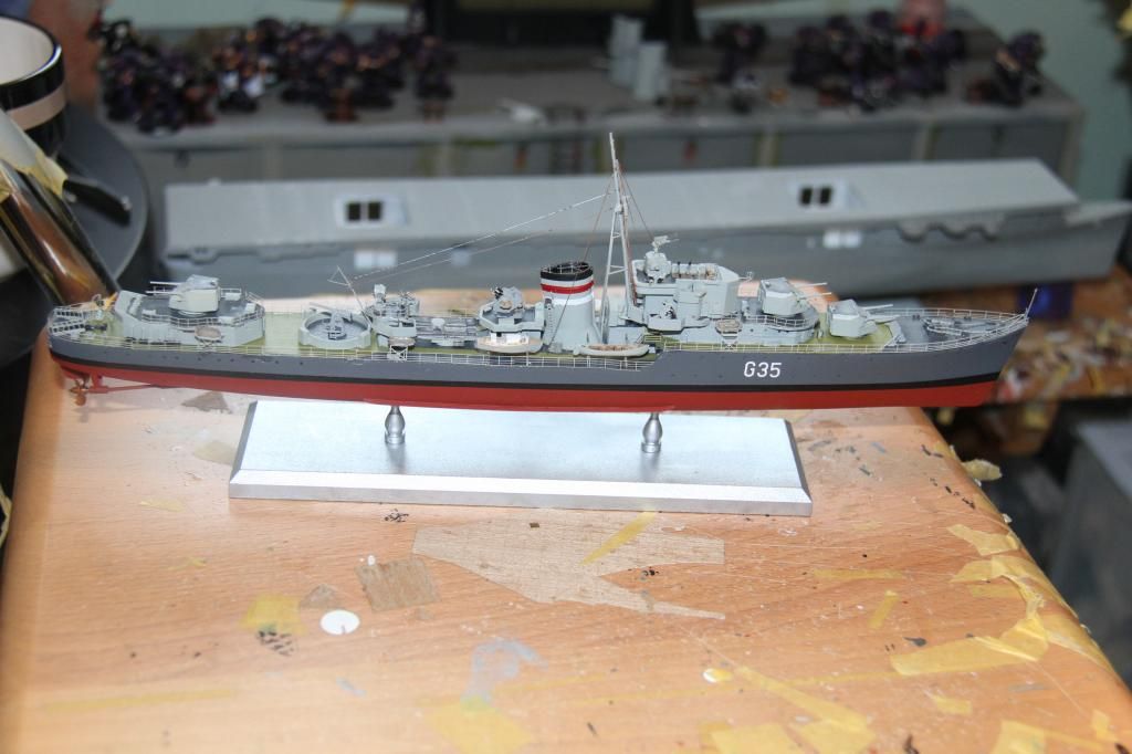

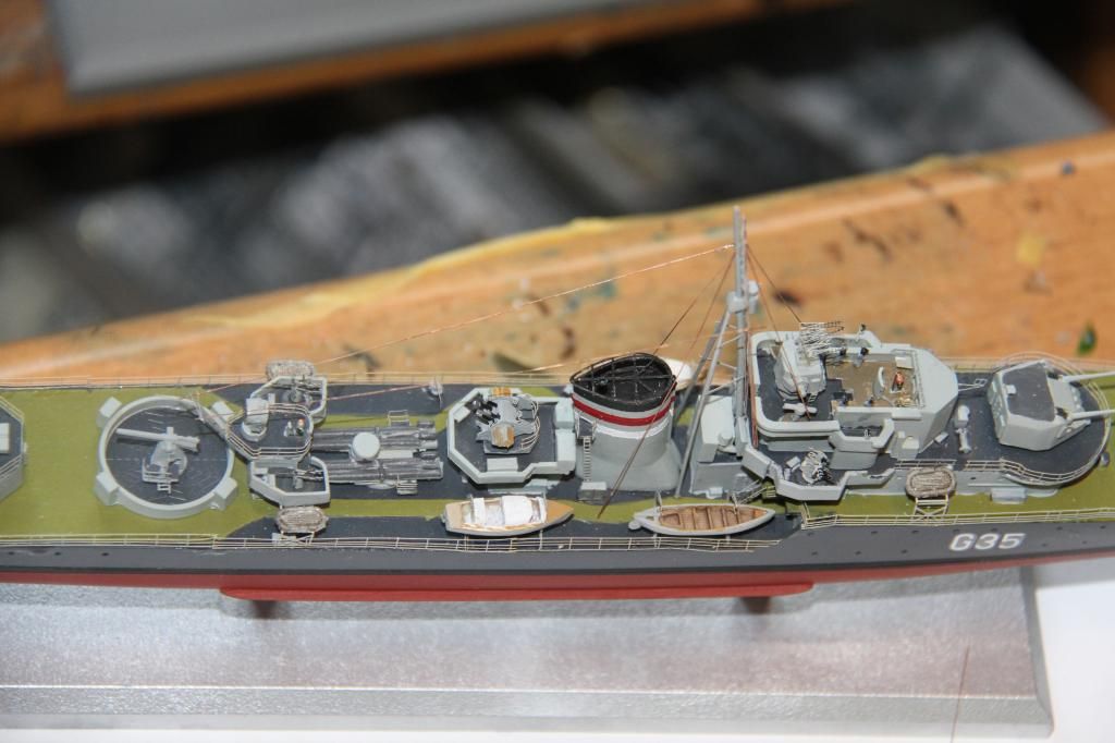

Finally got some pics with the Type 286 refitted.
Done! Finished,
HMS Marne, September 1942, part of the Fighting Destroyer Escort of PQ18.
Thank you, it is one thing about this site, everyone is great at passing on tips & "how too's"
Welcome Joe & good luck.
Hi Mike,
It is the Dragon CVL 22, USS Independence, building that over on the Battle of Leyte Gulf Campaign.
Done! Finished,
