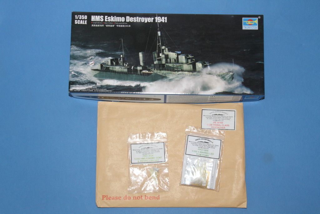

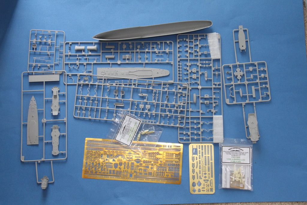

Another ship that took part in the Bismarck chase, under the command of Captain Philip Vian, flotilla leader of the 4th destroyer flotilla. Cossack along with 4 other ships of the flotilla made torpedo attacks on the Bismarck on the night of 26-27 May.
The Trumpeter tribal has three issues, not enough sheer on foredeck, German style ships boat sand an eight barrel pompom instead of a four.
The latter two are an easy fix as I have some WEM four barrel units and their boat set. The former will take a little more fixing, but it is not beyond the with of man.
Here is what I am using.
A bit more detail of the parts.
Plan to get started tomorrow,
Cheers.

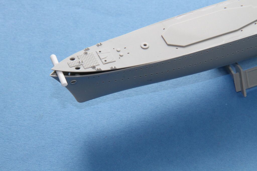

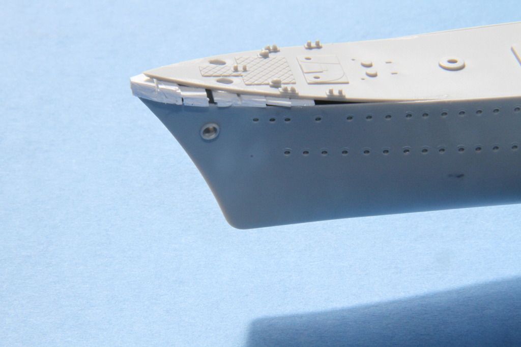

Sunday's update.
Piece of plastic rod inserted to get the right angle on the sheer of the fo'c's'le.
The structure on the new bow packed out with laminated plastic strip.
Packed round with filler.
Will attack with files and sanding sticks next time at the bench.
Cheers.

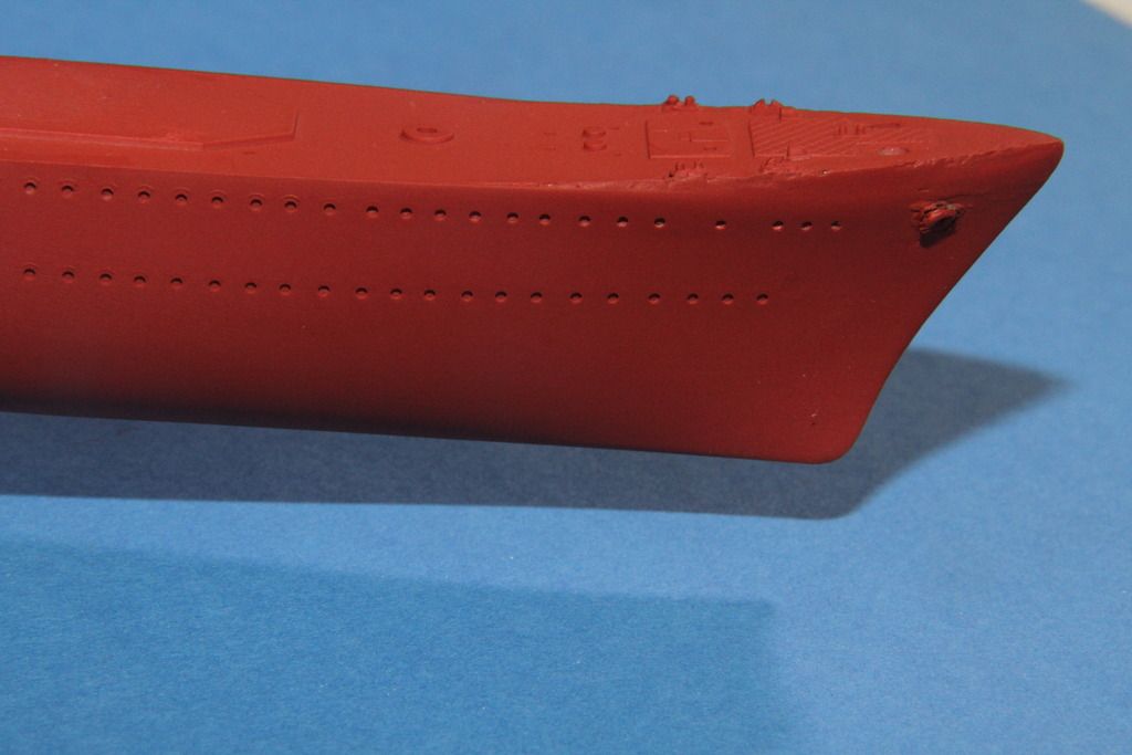

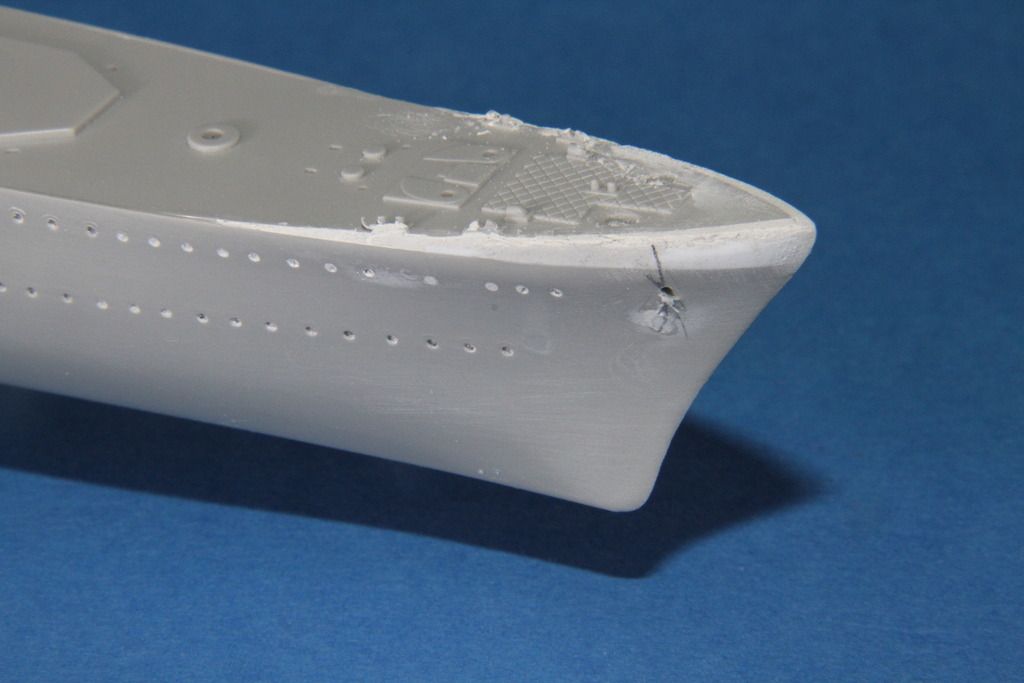

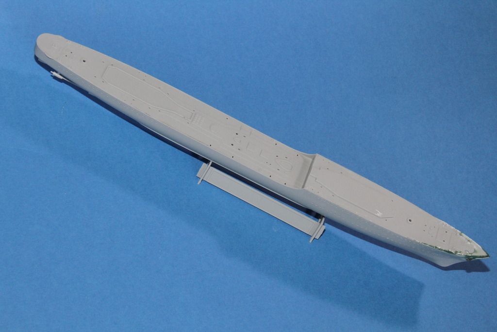

Posted: Saturday, April 16, 2016 - 02:28 AM UTC
First sand down, the moulded on reinforcing ring around the hawse pipe was removed at the same time, and the holes plugged with plastic rod.
Bit more filler, and the plug in the old hawse pipe has been sanded and the new hawse pipes drilled and filed.
About done, I think, the green filler is Citadel "Liquid green stuff", great stuff, the reinforcing rings around the new hawse pipe has been added (copper wire rolled around plastic rod, and shaped with the above mentioned liquied green stuff.
The shafts and rudder also added.
A coat of the usual Halford's red primer. created a little bit of a knuckle, but I think I can live with that as the sheer looks about right to me, hawse hole needs a bit more work. After that masking and a coat of black for the boot topping.
More tomorrow (I hope)
