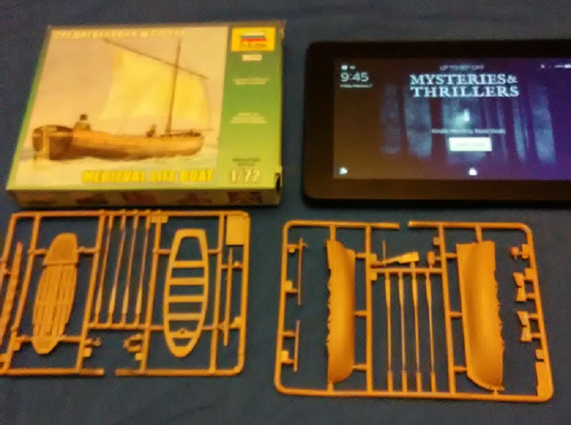

Hi Guys,
Here's my start photo for the lifeboat. Sorry about the photo quality. The camera in my phone really sux. I'll use my camera for progress shots.
Thanks

Interesting John. I never seen a medieval life boat before!

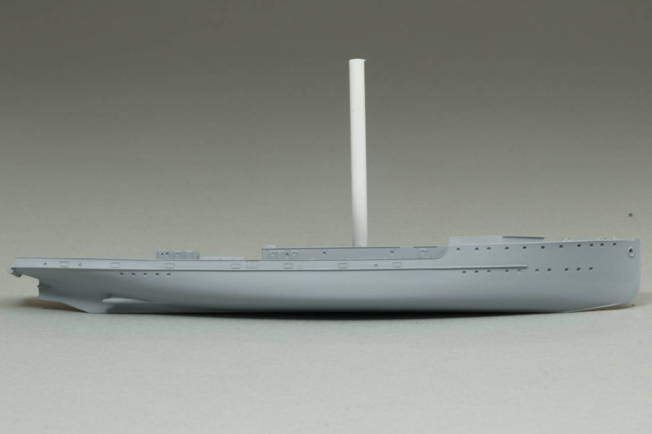

I have made a start on the minesweeper.
The hull came into two halves, top and bottom, if wanted to do a waterline. I have gone for the full hull though there was a fair amount of work since the bottom was marginally wider than the top.
In between sanding and priming I got a few other bits underway.

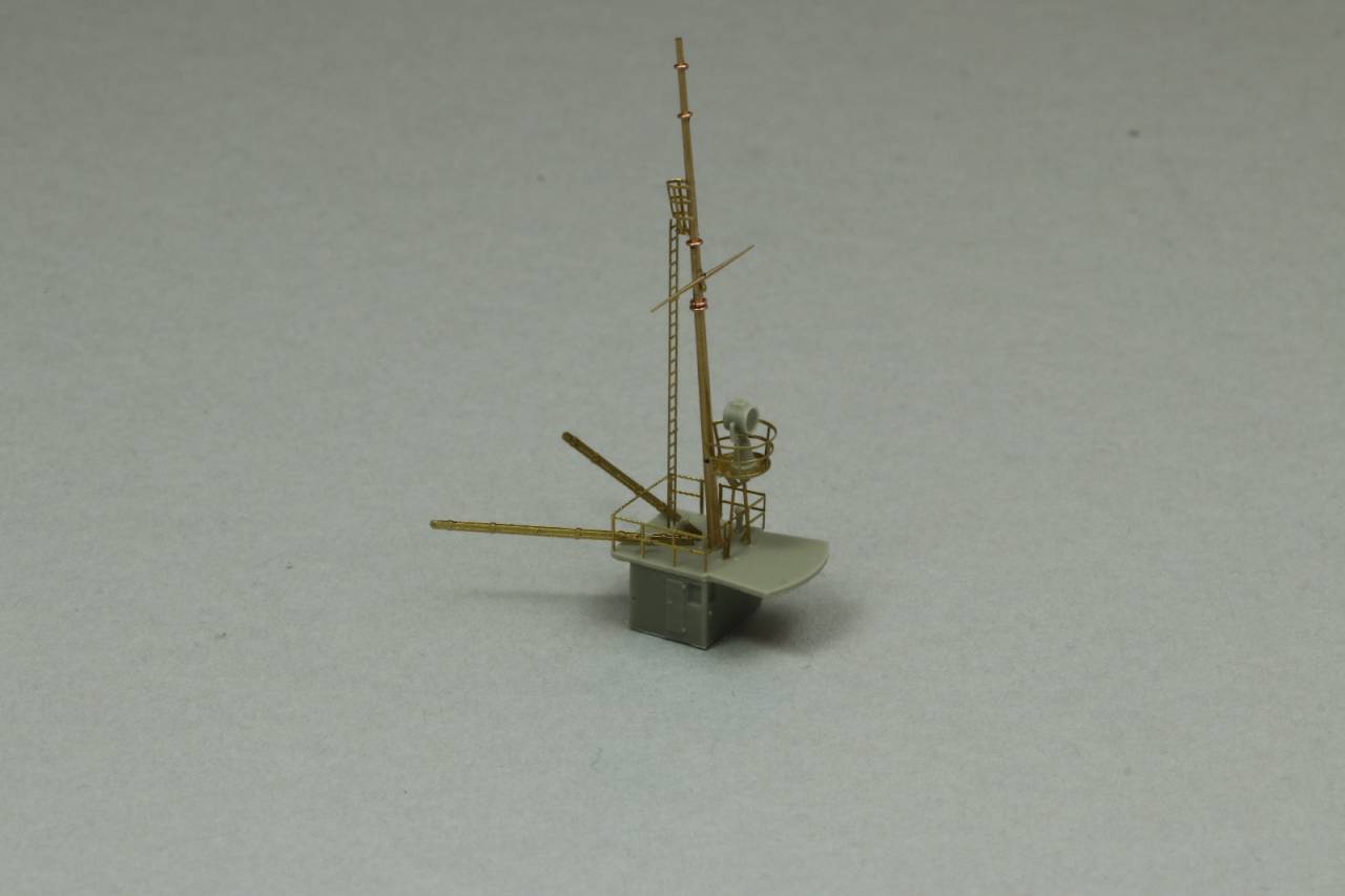

The rear mast and gun deck. With Combrig kits you have to provide your own masts. Fortunately Master released a range of brass masts and spars so they came to the rescue. I added a few rings for interest.

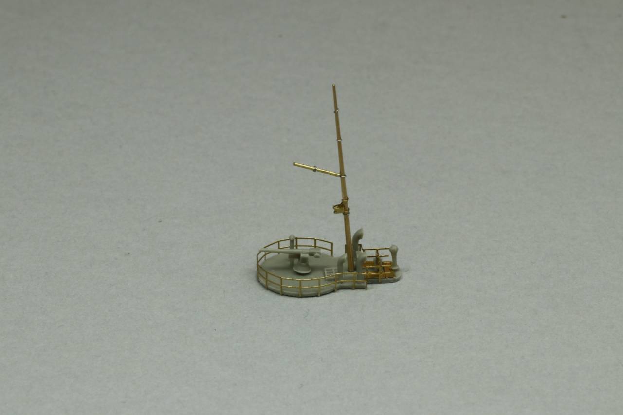

The mast and boat cranes atop the wheelhouse.

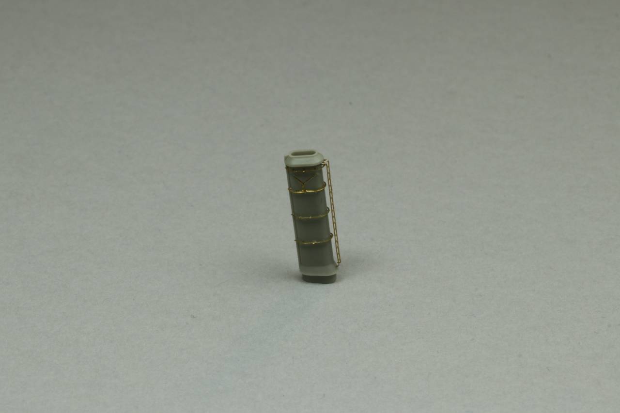

and the funnel
A drawback with kit is that most of the detail comes the photoetch which is unfortunate. Though nicely detailed it is over sized and poorly designed e.g. the hand rails for the ladders are part of the railings which means you have to be very precise with the location since you have glue the individual rungs of the ladders in. I have taken to cutting the handrails off and forming ladders without that issue.
A question though - does anybody know what colour I can use for WW1 Kreigsmarine boats?

Michael,
Very nice PE work.

Thanks Mark, It is the make or break of this kit. Hopefully I can keep it all in shape.

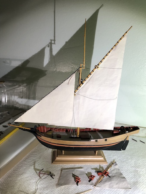

Up-to-date photo of the Heller 1/150 Tartane.
The sails are made of 'japanese tissue' using the vac-form sails, which were supplied with the kit, as patterns.
Still to do:
install 'mizzen' mast and sail,
install top sail on main mast (I'm not using the 'rafee' sail, or 'sky-scraper' sail that came with the kit),
install cannons (8 in all),
install anchor,
finish rigging,
make a better base,
write up a short 'bio' of this type of craft.

It's looking great Richard.
I have never built a Heller kit. How has it gone together?

Richard,
Those sails look wonderful, nice job.

Re: Heller's 1/150 'Le Corsaire'
The detail is nice on the parts, but there were many small seam lines to be cleaned up, nothing too big though, just a nuisance. The biggest issue is a slight cork screw warp which runs from bow to stern - although it's not that noticeable if you don't look too critically.
There were only 4 blocks (pulleys) supplied for the two masts to raise the spars. From what Ive researched on the internet, the shrouds have large double pulleys, which I've cobbled together from spares from my last ship build.
The instructions are ok, but there is only a rudimentary drawing for the rigging - coupling this with the lack of online resources for tartanes, I'm going to have to improvise a bit. On the other hand, 1/150 scale is a little small for detailed complete rigging job. I suspect that earlier issues of the kit were more complete.
I am cheating a bit by using elastic thread where I can - this keeps the rigging nice and tight while not applying too much pressure on the plastic parts to distort them. I use EZ Line which i've used before for rigging biplane aircraft.
I hear Heller is re-issuing at least one other 1/150 saling ship, the 'Capricorne' and I'm tempted. The 'Nina' caravel looks to be a nice kit as well.
If I were to give an overall rating I'd give the kit a 7 out of 10 for quality of detail, ease of assembly and the novelty of the subject. Marks off for the instructions, the seam lines and the 'twist'.
I like kits that are a 'type' rather than a specific subject, that way I can improvise a bit with colors and so on.

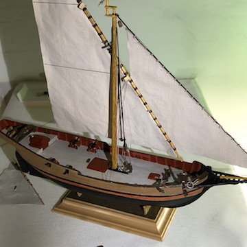

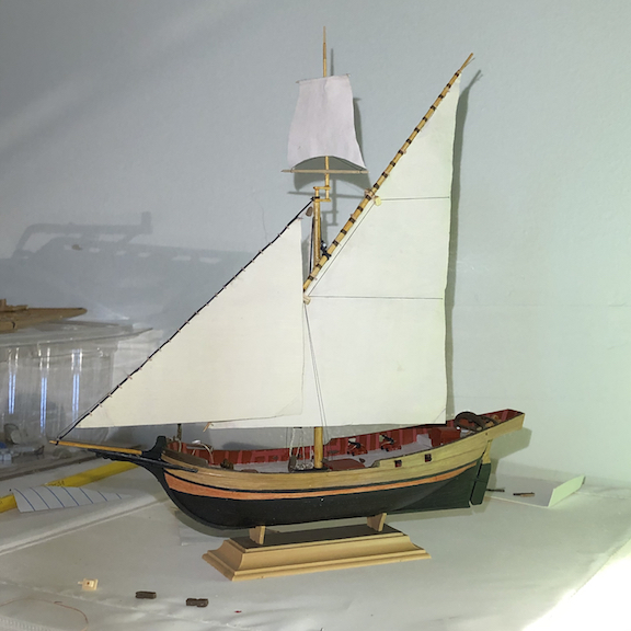

Tartane update.
Here are two new photos:
installed 4 cannons, added topsail to main mast, done some rigging, installed anchor.
I'm going to simplify the running rigging because the model is too small, but hopefully will 'look' right.
Still need to install another mast and lateen sail and all that rigging. Whew.
