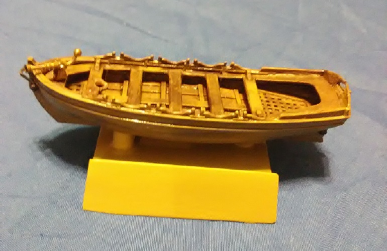

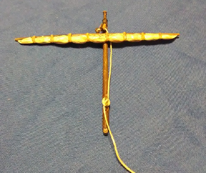

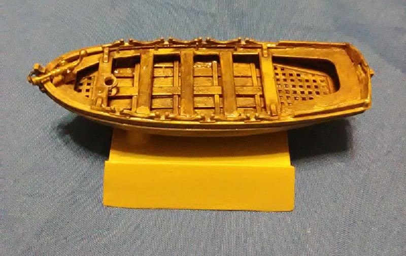

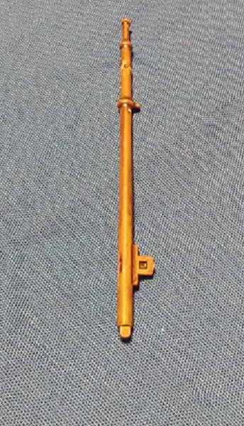

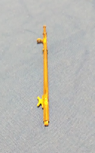

In my last update I mentioned oddities with the kit, mainly the mast. The mast and bowsprit attachment was a method I've never seen before. Here is the kit mast.
The base of the bowsprit was to fit in the box structure near the bottom of the mast and the tip of the bowsprit was to pass throw a ring mounted on the bow and extend over the bow. I removed the box and mounted the mast cleat that is included in the kit to cover the place where the box was at. I'm not using the bowsprit. Since the kit is in 1/72 scale I wanted to add whatever details I can. I attached the bowsprit ring to the mast to serve as an anchor point for a pully to mount the spar.
To add some details to the kit I sourced some parts from a Model Shipways wooden kit of the Phantom which is 1/96 scale, I think. I had completed about 3/4 of the kit about 30 years ago when a workbench accident destroyed much of the masts and rigging. I lost interest after that and placed it on my could've been shelf. The mast ring didn't last long so I removed it and drilled a small diameter hole through the mast and inserted a metal hook from the Phantom kit. I also drilled and added a hook to the spar. I got a wooden single pulley and threaded it with the running rigging thread from the Phantom. It's stiffer than sewing thread with no visible fuzziness. Here's the result.
Since I want to add rigging to the boat I needed anchor points so I used brass nails to make belaying pins. I drilled holes in the bulwark in locations that would not interfere with the oars. I added four per side. The most forward pin on each side will anchor the spar lines that keep the spar squared up. The next two on each side are to anchor the main stays and the last pin on each side will anchor the main sail sheets. The main bow stay will be anchored to the forestay iron mounted on the stem. Anchor and tow lines can also be tied to the forestay iron when in use.
Here is the mast and spar assembly. I'll be flemishing the end of the main sail halyard after installing he mast.
I've also added the swivel gun to the bow. Interference with the bow stay is avoided by swiveling the gun while at full elevation. Here are a couple views of the hull at present.
I'm going to have to restain the outer hull. In attempting to add another coat of enamel wash it removed most of the earlier layers so now I've cleaned off the residue and am letting it dry thoroughly before making another attempt.

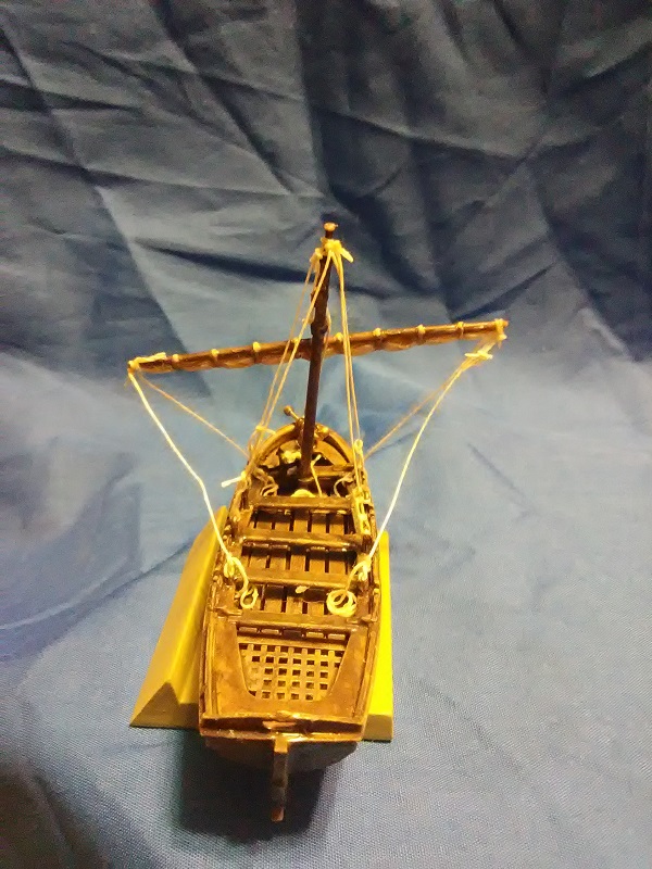

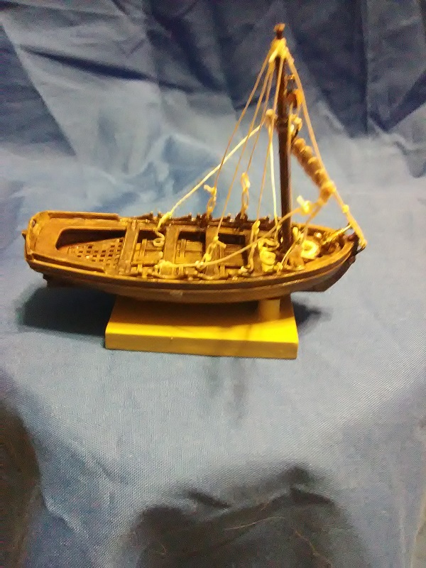

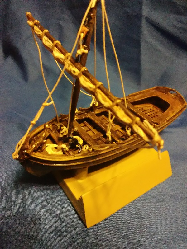

Hi everybody.
Thought I'd post another update on my lifeboat. Tim, I appreciate the info on the thinner. I tried Testors Thinner with my wash application and it came out much better.

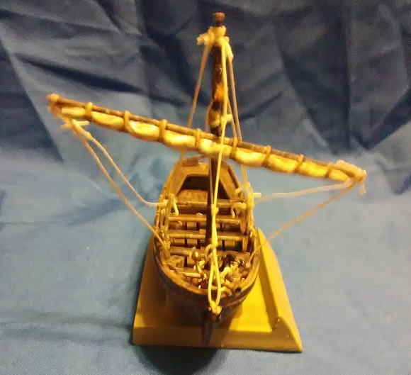

I have discovered to my dismay that when it comes to rigging a boat I make a good spaghetti cook. After stepping the mast I started with the bow stay. Didn't really have any problems other than the string from the Phantom kit is stiffer than normal thread so there was a lot of spring to it when trying to tie knots.
Then I thought I would go front to back in setting the spar lines and mast stays. After spending 5 very frustrating hours getting the spar lines on the belaying pins I decided to go a different route. I pulled out the other belaying pins and installed brass ring bolts. I also discovered if you wet the string it wasn't so stiff. I progressed with the mast stays but because the boat is so small and light I couldn't get it to stay put while rigging so I had to hold it in my hand while tightening the knots. Some of the lines got a little loose. I'm hoping the string will tighten after it dries.
The last lines were the spar halyards. These gave me problems as they got caught on the spar lines causing them to come loose from the spar meaning a lot of rework. And I wound up with some slack in the halyards as well. I have increased my respect greatly for the modelers who build sailing vessels.
I tried to coil the rope ends where appropriate which gives the boat a busy look. I also placed an anchor and rope in the bow. The boats of this period used grapnel type anchors. I found one in my spares box from an old incomplete Lindberg kit of the USS Monitor I got at a yard sale for a dollar years ago.
I've still got to add the rudder and other supplies in the stern. I've discovered that the kit oars are longer than the boat hull, about 20 scale feet long. I'm going to be trimming them to about 12 scale feet. The last items I'll be placing are the figures. Not sure how many I'll place. I'm thinking four rowers, a bosun or officer at the rudder and a couple infantry/gunners at the front. It will definitely have a busy, crowded look. The figures may not be complete before the end of the campaign but I'll try. Anyway, here's a few photos of where I'm at right now. Sorry about the lighting. When I take photos at night the room light gives everything a yellow tint.

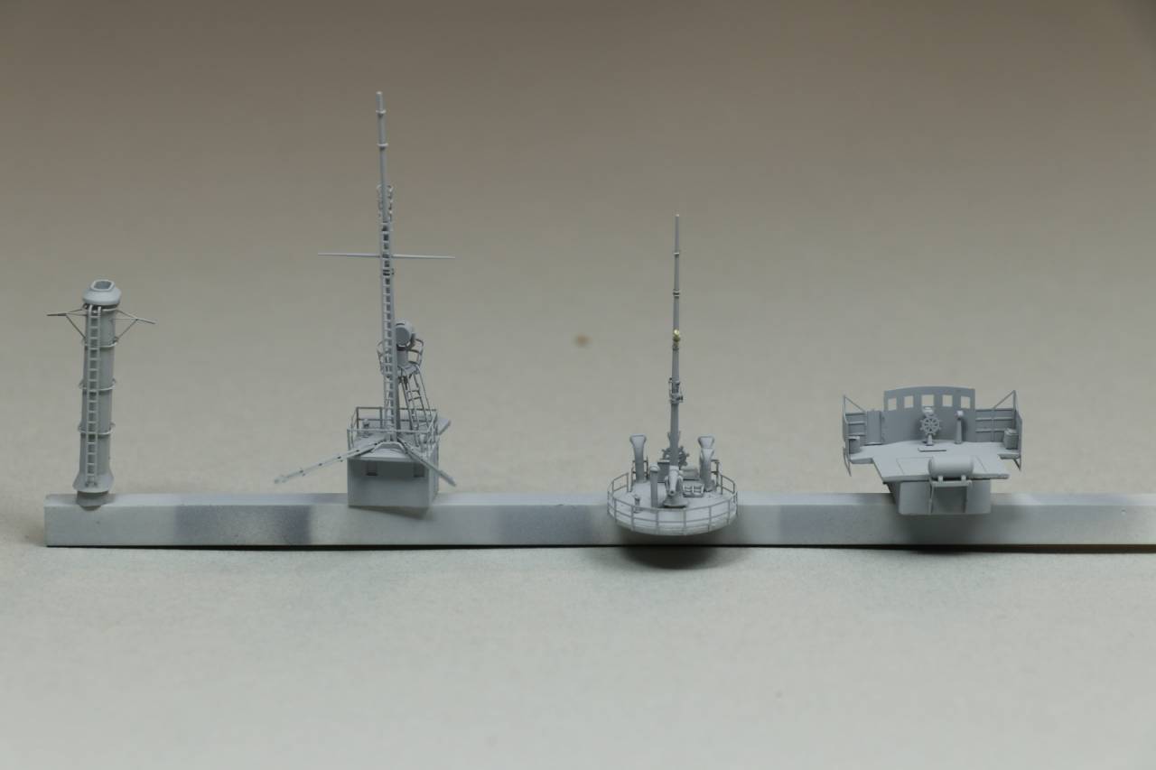

Had a good route through my spares today and found some boat davits from a Japanese Navy equipment set. These came free with a Destroyer I built several years ago. Not quite enough for all three boats. Got me thinking if any of the others in my stash had this set included. And low and behold, almost every one had it included! A huge thanks to Tamiya and Hasegawa. So plenty of parts to spruce these up. Will probably also replace the boats from the sets too.
