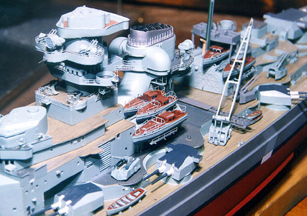

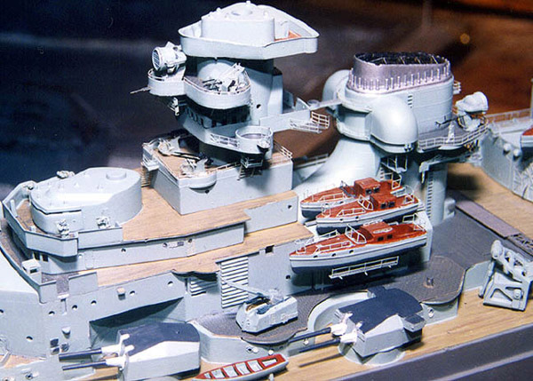

  With the major sub assemblies finished it’s time to put it all together. The superstructures are added deck by deck. Then the armaments. The boats are painted and detailed with WEM parts and added to the various locations. The masts are built and P.E. footropes and braces are added before they’re glued in place. Now the shop is mounted to the display base with the bolts inserted from underneath, through the pedestals and screwed into the hull. Using as many photos as I could find, the rigging was done with carbon fiber. These fibers are .004 thick, dark gray in color and are straight and will not bend. Each place is measured and each piece is cut to fit, the ends dipped in glue (white or CA) and set in place. The final task is setting the main deck railing in place and giving the entire ship a final spray of Testors Dull coat.
Wow, I'm really impressed. Good work!
I would really like to see this model in real. Those 2cm Flakvierlings looks awesome.

You can always expect first rate work out of Mikes stuff.  I would love to see some close ups as well, especially since I plan to do this one for my Dreadnaught campaign.  His rigging is exquisite.

Dang, that's one nice looking model. It lives up to the often claimed, but not always seen, "museum quality." Then I saw Mike's bio saying he build models professionally. You can tell.
I have one comment, or question. The side camo looks like a photo I've seen of th Bismark where the black and white stripes were painted over for the Atlantic mission, and were basically showing through the paint. At that time the fore and aft swastikas were also painted out. I feel like I'm trying to teach my  grandmother to suck eggs but is this paint job strictly accurate?
