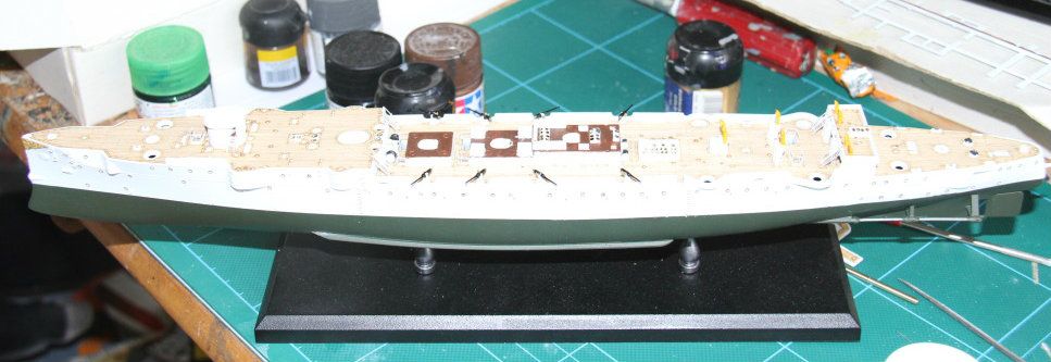

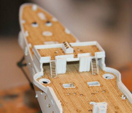

A Bit more progress,
The after superstructure, the skylights have been dtailed, the wood deck fitted and etched doors fitted to the Bulkhead.
These were fitted, a few minor issues, the bottom of the bulkead had to be sanded a thinner and the vents on the outside needed the bottoms trimming off to fitt the wood decking. Also the sides bowed inwards slightly, so i taped the deck in place a bit forward of where it should fit and the dropped the bulkhead in quite neatly.
The funnel casin decks were prepared next, again minor issue, the four vent supports on the smaller forward section, they need to be carefully placed so they do not foul the after section and the walkway / boat rack.
with the walway / boat rack test fitted.
A few minor issues, but nothing a bit of care and fettling did not get round.
More soon
More soon

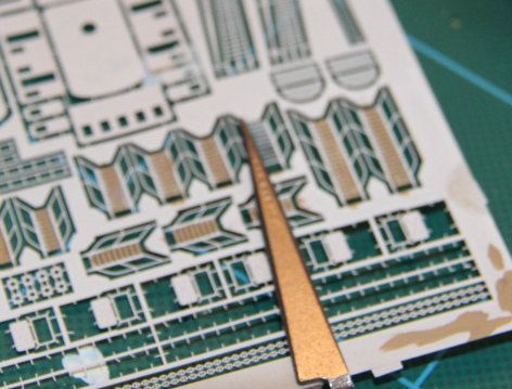

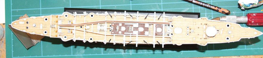

A bit more progress.
Work has started on the ladders, the steps are bent up whilst still attahced to the fret.
The sides are bent up using a simple folding tool.
and the ladders from the aft superstructure to the maindeck have been fitted.
More soon (I Hope)
I do understand what you mean, however, it is a small price to pay to for the effect. Swings and roundabouts as they say.
More soon (I Hope)

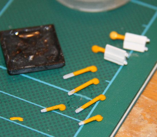

Painting the first of a multitude of vents has started, yellow can be a swine to brush, but Citadel colours to the rescue, golden yellow went on over the Skull white primer out of a rattle can very well.

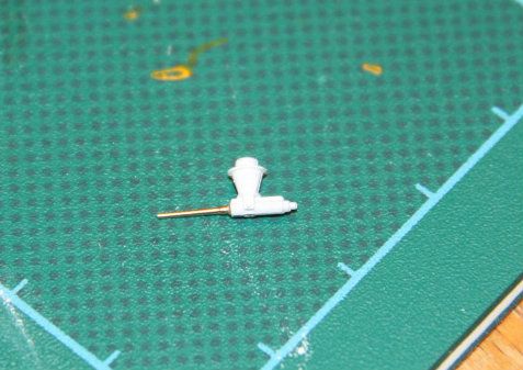

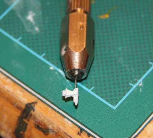

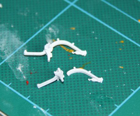

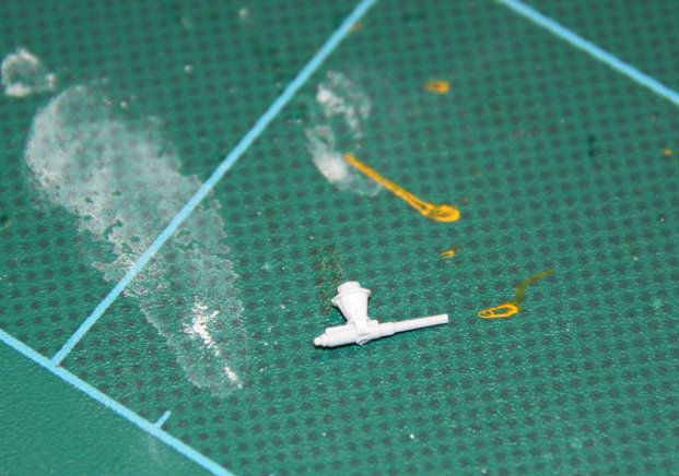

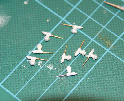

Next job replacing the barrels on the 75mm secondary guns.
The gun as suplied.
The barrel removed. (a file has been run over the cut to make sure it is square)
Drilling out for the brass barrel.
and the end result.
All eight done.
Finally, the vents fitted, citadel blood red for the vent interiors, also the etched guard rails for the stair wells have also been added.
More soon

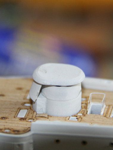

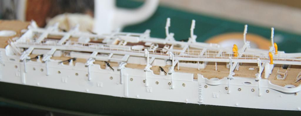

Sunday's progress:-
First a fit issue, and the only one to date. I followed the instructions and assemled the conning tower and test fitted it... OOPS.
Plan B, I fiited the rear piece th bottom of the tower, let it dry and filled to fit.
Whilst the glue was drying I painted & finished the secondary guns, Some spare handwheels were fiited as a bit of "creative gizmology" to add a bit of depth.
The secondary guns were fitted, along with the rest of the conning tower and it's ladders.
The boat rack / walkway had the then supports fitted to it's underside and then test fitted, even with the wooden deck it fitted well apart from a slight warp, a jar of tamiya paint held the front end down whilst the glue dried.
The large forward cradles / davits were cut down to take the etched davit sections.
There were some minor fit issues between the davits and the walkways which will not be too difficult to sort out with some offcuts of plastic strip.
More soon
