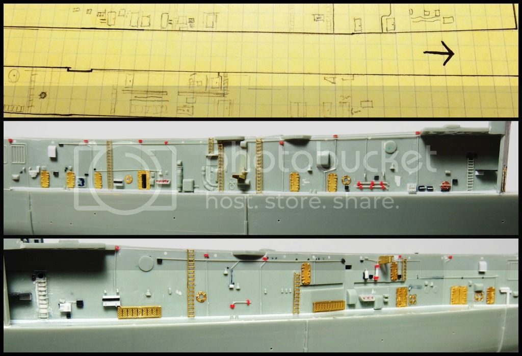

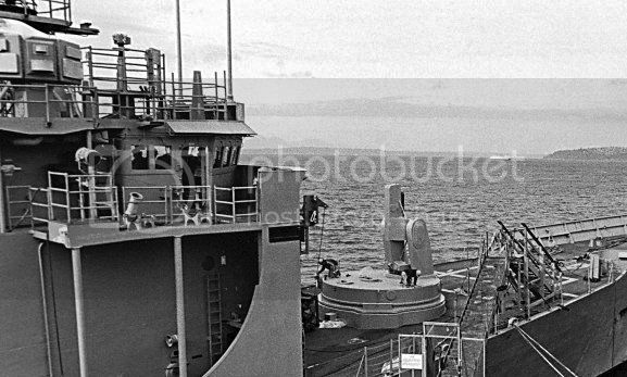

Thanks for the great support everyone, it makes this insane detailing a little easier to keep up.
Albert, welcome aboard, I hope you have a great time with the Academy FFG, Ive been very impressed with the kit overall. By the way, what kind of experience do you have with these ships, did you build them? Serve on them? Can you tell me where this is:
Id love to add the ships bell.
Today's update:
Superstructure detailing port and starboard. The open door will get added later, I don't want to break it off. I had a hard time bending the longer ladders but they came out alright. Im gonna have to buy a proper PE bending tool, its worth the 20 bucks.
Next up detailing around the hanger garage doors.
By the way I am petrified of painting/messing up this ship.
Thanks for your guys support,
Bryan

Posted: Wednesday, April 15, 2015 - 12:18 AM UTC
Great job Bryan,
That extra detailing is superb, looking forward to the next update.

Posted: Wednesday, April 15, 2015 - 01:37 AM UTC
1/350 FFG-57 Reuben James
Hi Bryan,
I was a civilian worker at the Long Beach Naval Shipyard and am old enough to remember when these ships were just artist concepts. I worked in the Design Division and my group worked on Main Propulsion machinery for the most part. I worked on the CRP Propeller system and some of the Main Propulsion Auxiliary Equipment. These were only one of the classes we worked on. I also did a bunch of design work for the 1980's Battleship program and did all the drawings for the new Fuel Oil System, Forced Draft Blower upgrades and several other jobs for both Missouri and New Jersey. Also worked a lot on the Spruance Class DD's, LHA's Steam Powered CG's and Knox Class Frigates. Probably some other I can't remember.
I'm not sure but I think the bell is just under the bridge windows. I didn't spend much time on the main deck on these ships. I usually just headed bellow to make my sketches and such.
It is a nice model. It's my first ship in years. I got into armor for a while but my first love is ships. I already have a stash of 6 or 8.

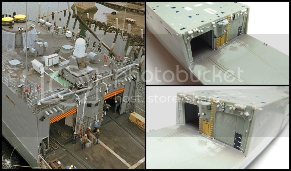

Posted: Thursday, April 16, 2015 - 03:55 PM UTC
Again thanks for all the great support everyone.
I had a Friday morning to myself so some progress has been made,
Today's progress:
Detailing around the hangar bay and doors, I especially like the stop light for helicopters. What does the yellow light mean though?
Next up, Forward part of the superstructure, here is the plan as a teaser,
Thanks for stopping by,
Bryan

Posted: Thursday, April 16, 2015 - 11:18 PM UTC
Great stuff Bryan,
Loving the attention to detail.
Keep up the good work.

Posted: Friday, April 17, 2015 - 03:52 AM UTC
Really nice work Brian, I cant remember the amber light over the Stbd hanger,  Possibly it was part of the RAST control??
I do know the 2 red lights near the CIWS up on 02 deck are the Helo wave off lights, they flash to abort the landing.
They sit either side of the SGSI, (Stabilized Glide Slope Indicator) which in that photo is powered down as its leaning to one side.
I think earlier you were asking about the cabinets (with white fronts) behind the CIWS mount, they house the ready use 20mm ammo for the CIWS. The painted areas are a separate panel designed to dissipate heat and stop the lockers from getting too hot.
On Australian ships, the ships bell was always at the aft end of the breezeway as you exit to the flight deck, near the aft gangway area as it was rung 8 times for colours in the morning when the stern flag was raised.
Posted: Friday, April 17, 2015 - 09:33 PM UTC
Hi Bryan,
great work, nice 'teaser', looking forward to see the results!!
The 'traffic lights' for the help are correct! As Ned already points out, for some reason - don't ask me why - USN refers to that yellow light as 'amber', and you have three deck status, green, amber and red deck. Amber is for engaging and disengaging the rotors. This is a somewhat tricky situation, as the ship needs to be quite stable when the rotor starts or stops spinning and during that time passes through some critical rpm's. Fro more detail you can check the link. Anyway - most other navies that I know, including German Navy, operate only with red and green deck.
http://navyaviation.tpub.com/14014/css/14014_290.htm
