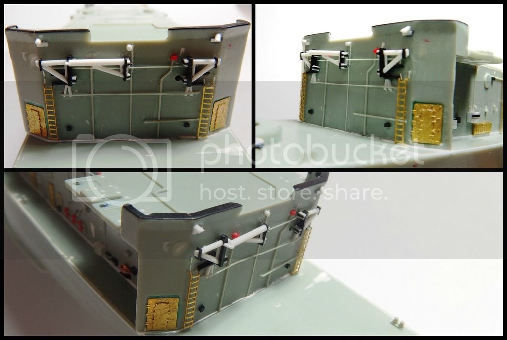

Forward bulkhead of superstructure.  This part has three yardarm constructions on it.  The center crane I think is for loading the missiles for the the MK-13.  The other two are less clear to me.  They are pretty complex in real life.  I tried to do them justice.  They came out a little misaligned but I cant imagine building them again.  There must be more than 15 plastic parts in just one of the yardarms.

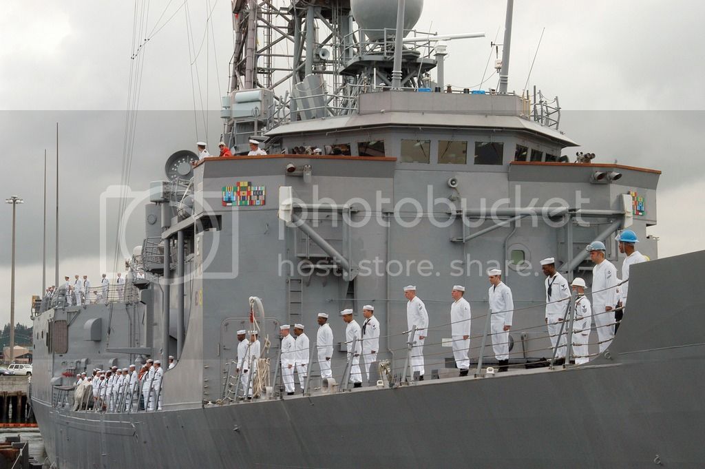

Here is the real Reuben James (a fairly modern photo as the MK-13 launcher has been removed)
My interpretation:

Posted: Wednesday, April 22, 2015 - 05:48 PM UTC
Some more fine work there Bryan!!  Big fun to follow along with this one coming together!!

Posted: Wednesday, April 22, 2015 - 09:54 PM UTC
Your yardarms look great. Once some paint is on they will be perfect.

Posted: Thursday, April 23, 2015 - 02:56 AM UTC
Excellent work Brian. The center support arm actually locks into the port or stbd arm depending on which side the replenishment is coming from. The fwd replenishment area wasn't ever used too much at sea. The flightdeck point was most popular.

Bryan,
great work on the yardarms - you definitely did them justice. They definitely don't look misaligned!!

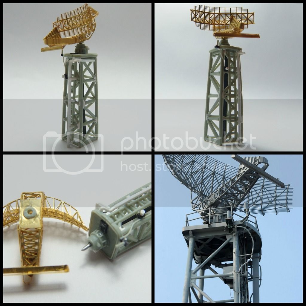

AN/SPS-49 Air Search Radar and Mast:
This was the most complex piece of PE on the ship but it wasn't to difficult in the end, which gave me some good confidence for the future.  I pinned the radar piece to the mast so that they can be painted separately, its a little droopy just dry fitted but it will allow for plastic to be glued to plastic in the last stages of the build instead of fumbling with super glue and fragile PE after paint.  Of course the mast got the standard upgrades based on the now very familiar photos.

Posted: Tuesday, May 05, 2015 - 05:42 AM UTC
Beautiful work on the radar Bryan!!  Sharp looking PE piece!!
Posted: Sunday, May 10, 2015 - 01:00 AM UTC
Great Work Brian,
The etchwork on the radar is superb,

Posted: Monday, May 11, 2015 - 09:21 AM UTC
Bryan,
I can only second Si and Todd here - outstanding work on the SPS 49!!

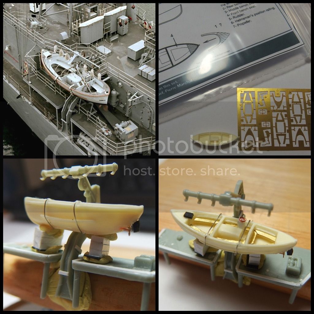

Whaleboat and Whaleboat deck.  I sourced the little resin boats from L'Arsenal and had to modernize it a bit by adding a rudder and a steering wheel.  I even put on a throttle which is so small its literally invisible.  All the parts are going to be painted and attached to the ship later.  By the way those ugly plastic blocks holding the boat have beautiful PE replacements, I used them just for the dry fit.  There will also be a lot of rigging between the crane and the boat.
Thanks for looking,  I have no idea what to build next but I am running out of sub-assemblies to make.
Bryan

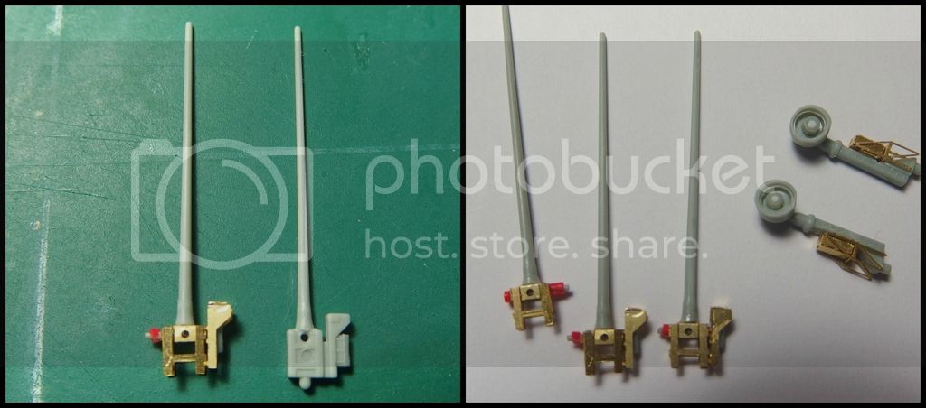

1/350 FFG-57 Reuben James
Today's update:
Whip antenna kit comparison and finished products in addition to GPS antennas:

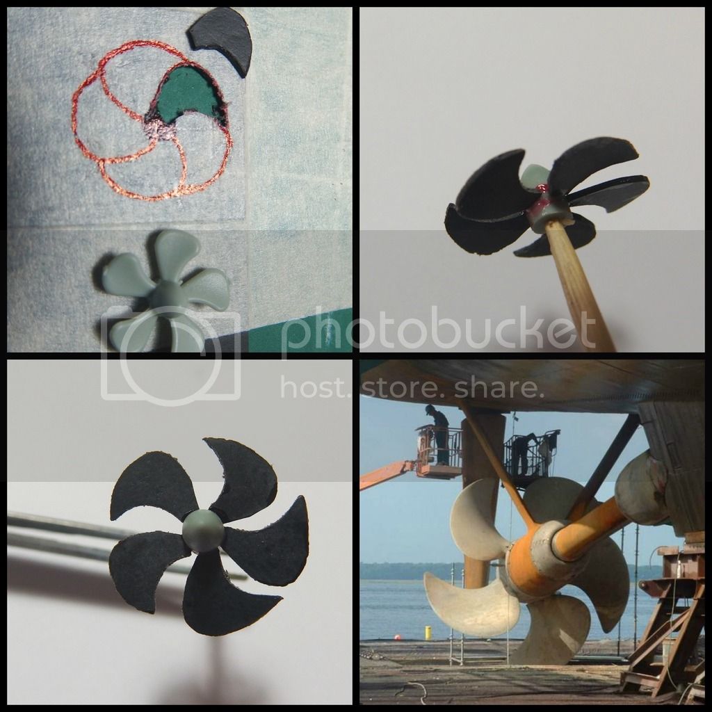

More interesting was the construction of a new propeller as the kit part is from some other model or something.  Apparently the FFG prop was a very special piece of engineering which allowed the blades to change their pitch resulting in increased speed.  In any case I cut a bunch out of plastic stock and glued them to the propeller base.  They need some fine sanding and other minuscule details but overall I think they came out much more aggressive than the kit part.

Posted: Monday, May 18, 2015 - 05:02 PM UTC
Great job on the prop refit Bryan!  Much better!!
Posted: Tuesday, May 19, 2015 - 12:58 AM UTC
Great work on the prop and the antenna Bryan,
Looking stunning.

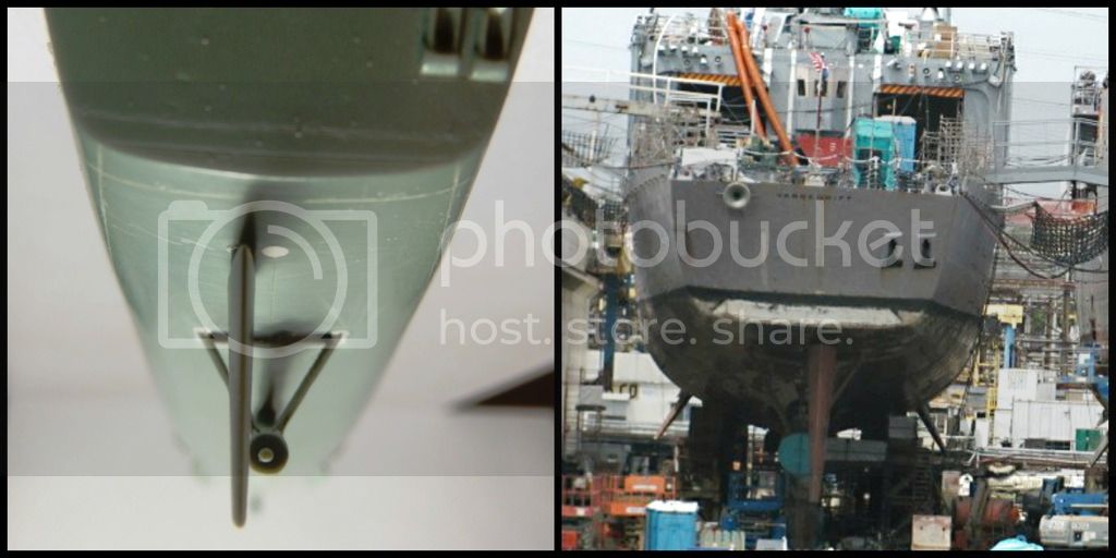

Posted: Wednesday, May 20, 2015 - 10:48 PM UTC
Todd and Si, thanks for the comments,
Of course the natural next step was to add the propeller shaft and Rudder.  If you remember the rudder needed to be offset offset starboard a bit (thats the exact measurement) so I drilled a hole and
oops...
F%*#, but nothing some putty and super glue cant fix,

Posted: Wednesday, May 20, 2015 - 11:59 PM UTC
Hi Bryan,
Nice work,
I presume the offset rudder is to overcome to torque from the single screw when going ahead?
Cheers.
