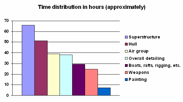

Totals
Time: 273 hours, 39 days
Kit parts: 553
Scratch parts: 1324
PE parts: 659
Resin parts: 112
Turned brass parts: 12
Laser-cut wood parts: 2
Cotton parts: 5
Decals: 132
Total parts: 2800
