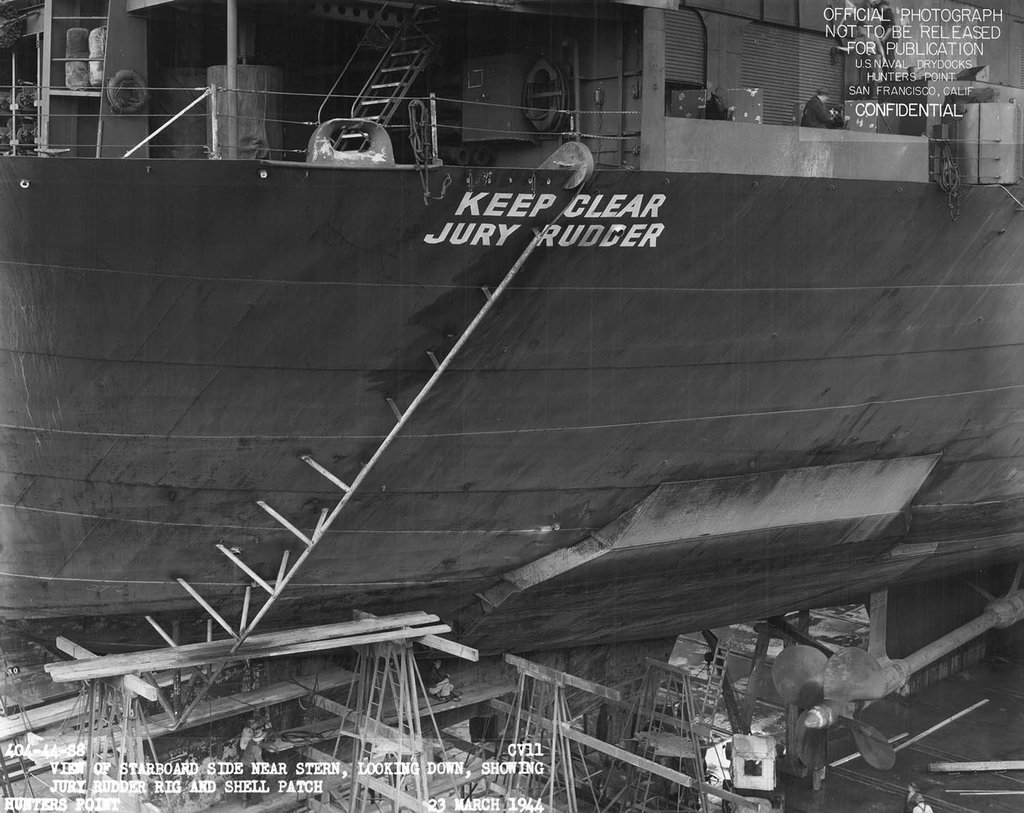

Main reference is
So I should be able to capture the most of the differences between the two vessels.
