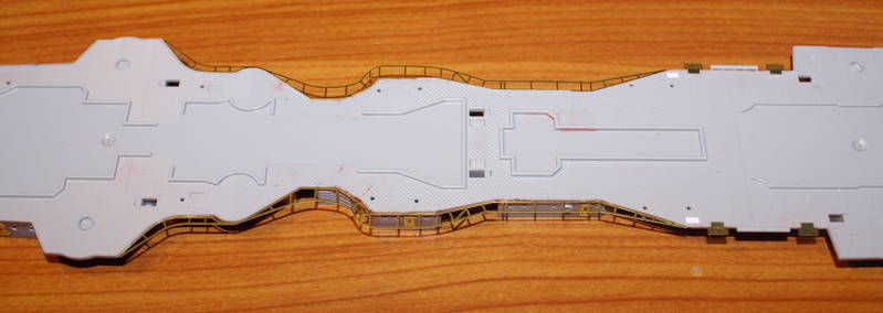

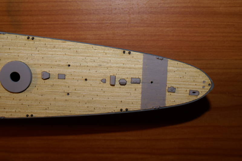

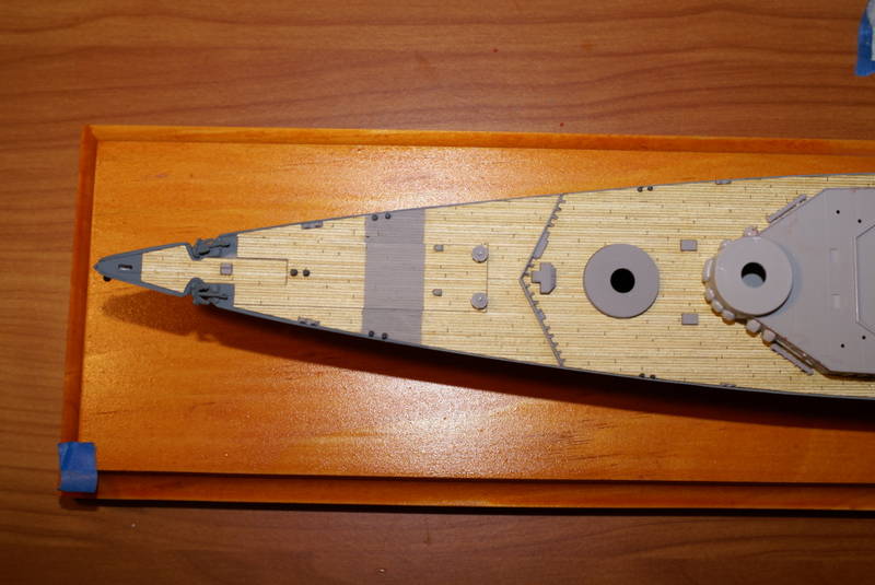

Now to the progress

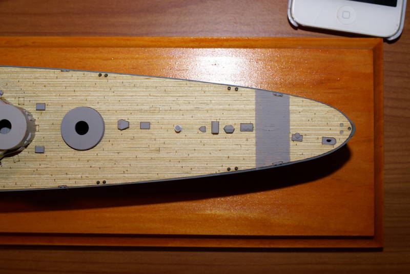

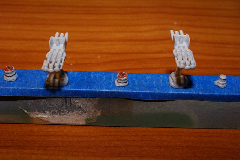

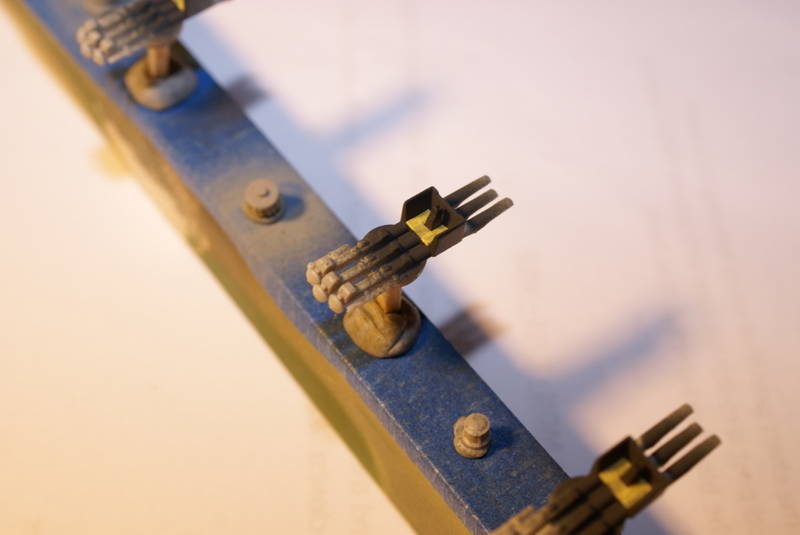

 The molded detail on the capstans was removed and a brass rod fitted, so that the etched hand wheel can be added later and it will sit proud of the capstan as per the real item

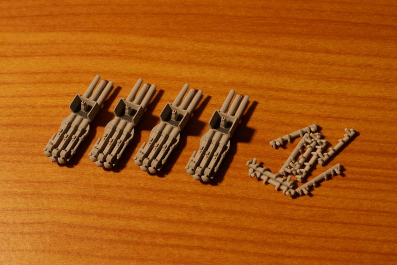

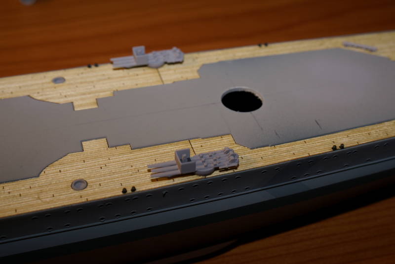

torpedo launchers prepped

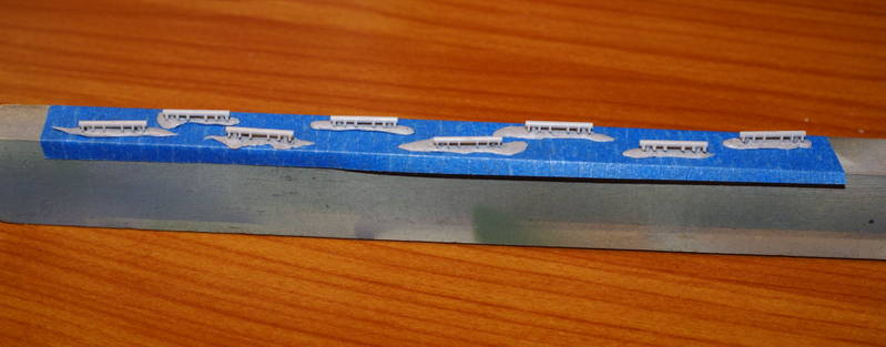

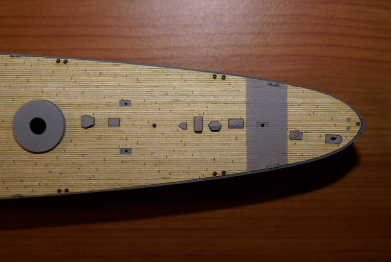

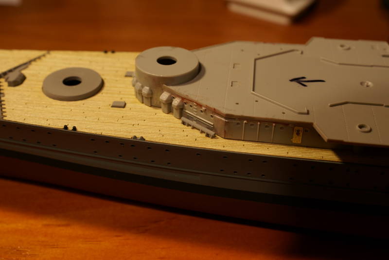

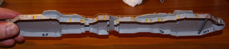

deck fittings

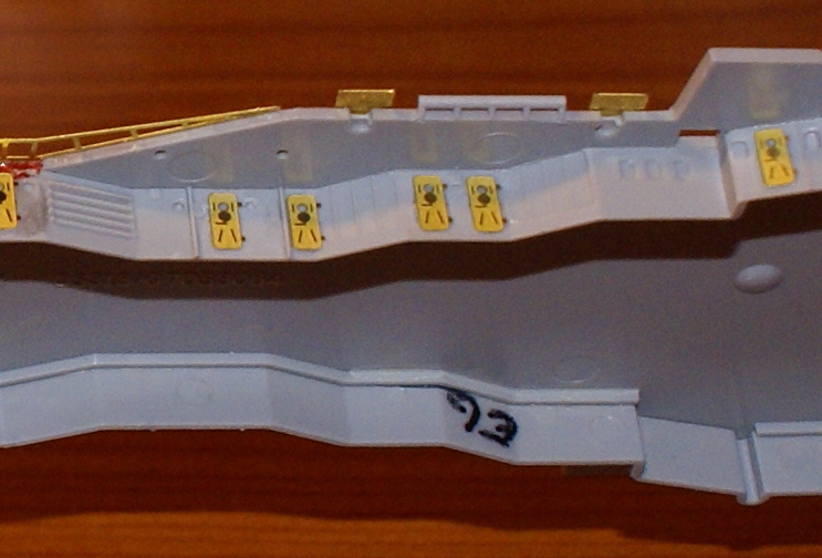

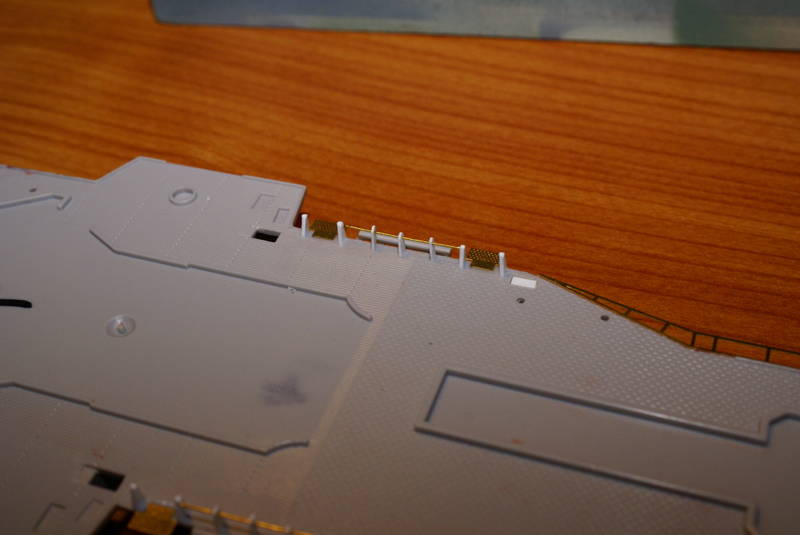

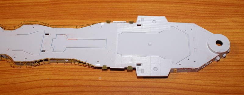

and the final scratch building added to the shelter deck (which is now ready for paint)
I won't be painting the shelter deck yet though as I plan to prep all the other super structure elements and paint as one, so for the meantime it will just be the deck fittings, capstans, and launchers...
