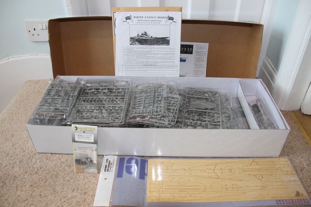

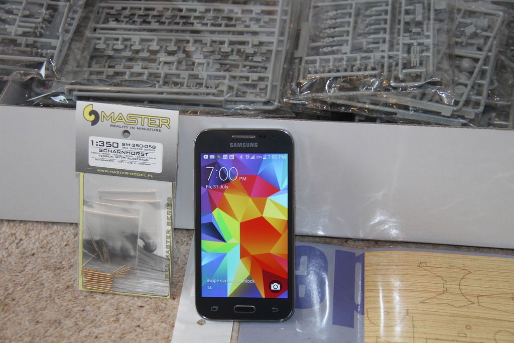

Here it is, official kick off tomorrow, but as it already tomorrow in some parts of the world here is the official thread.

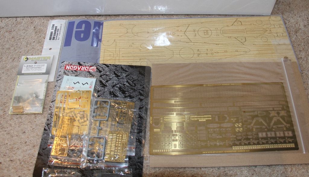

My start pics of the Scharnhorst.
A closer look at the add ons, WEM etch, Artworx deck and master barrels.

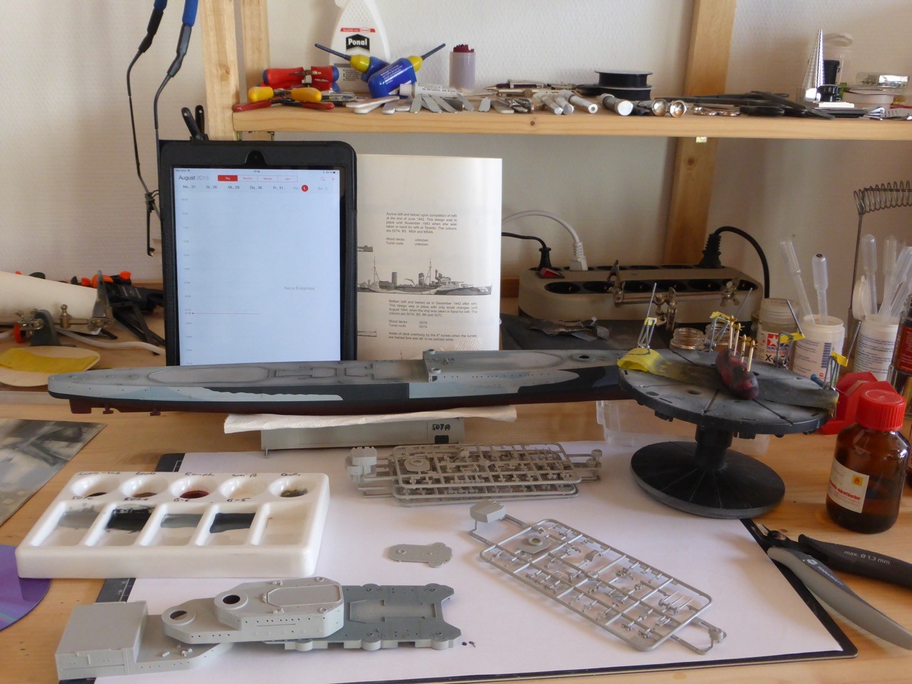

Two very interesting projects already posted - this should become a great campaign.

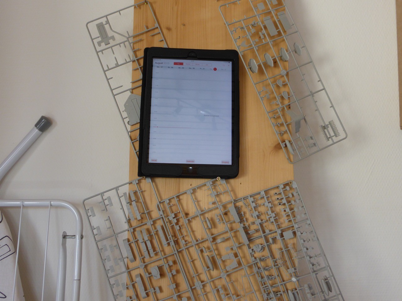

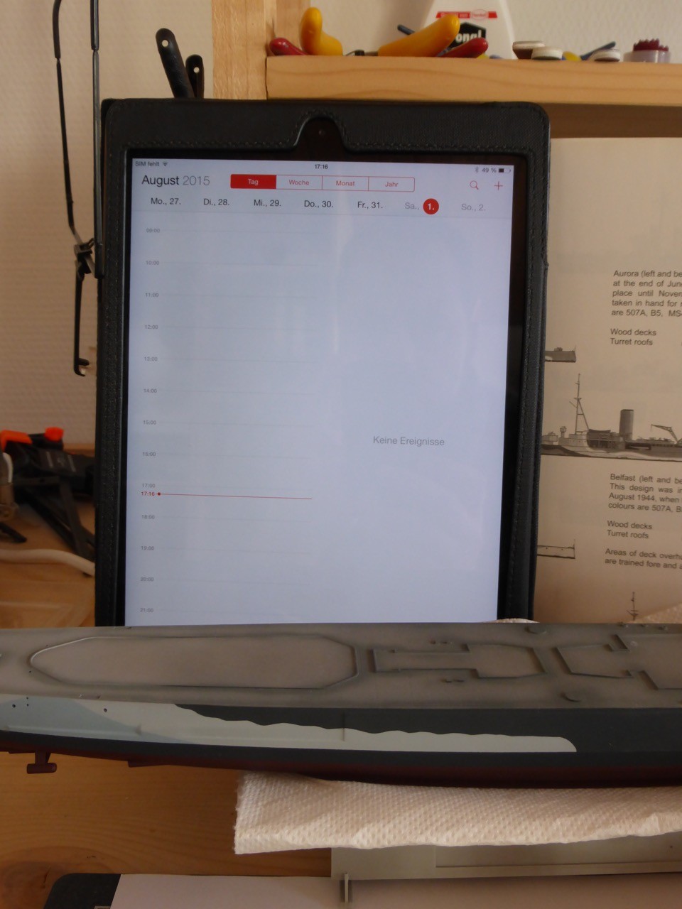

Now here's my contribution, my first campaign ever
HMS Belfast, 1:350 Trumpeter kit with WEM, wood deck from Artwox, Master barrels and various other add ons, partly cannibalized parts from older projects.
I will keep my updates short in here, my more detailed build log is already started here:
http://modelshipwrights.kitmaker.net/forums/234206 But no worries, there's more than enough left to do, and I am happy if I finish in time
Here's my starting post for the campaign:
Looking forward to our cruiser campaign!!

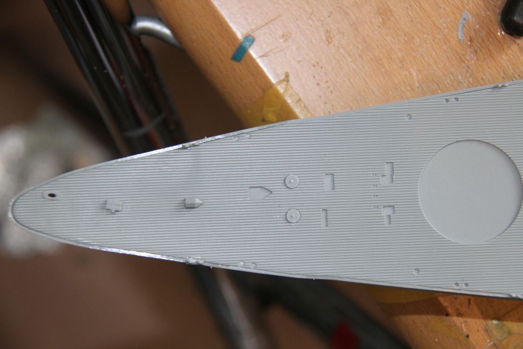

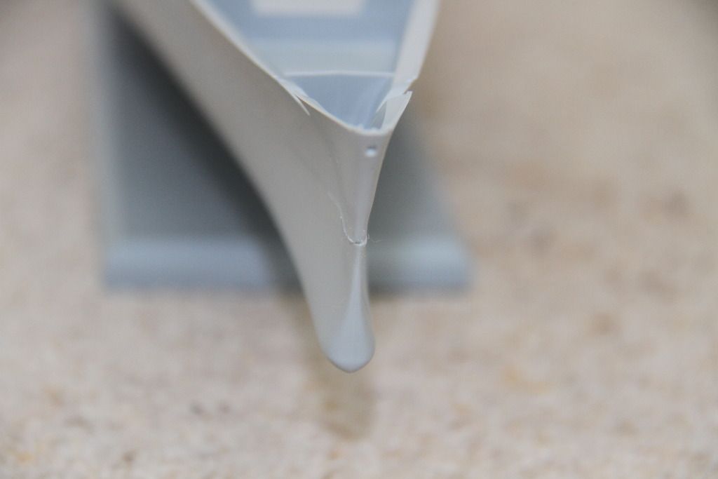

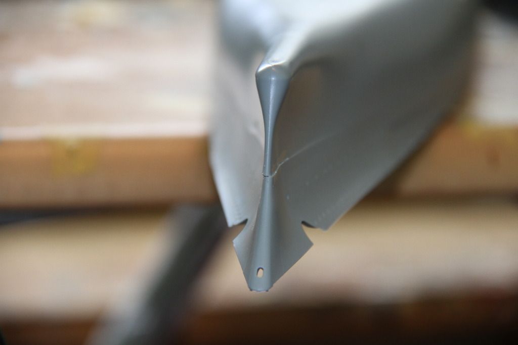

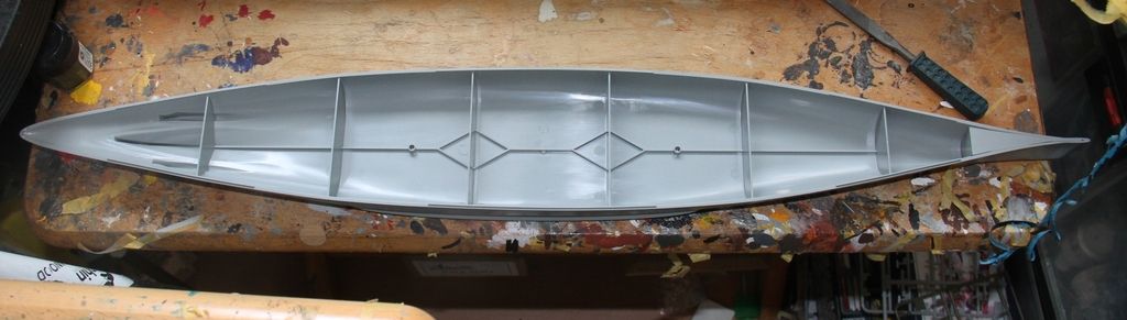

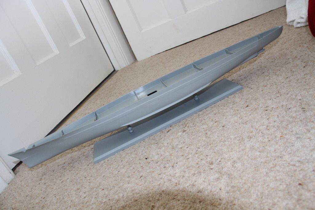

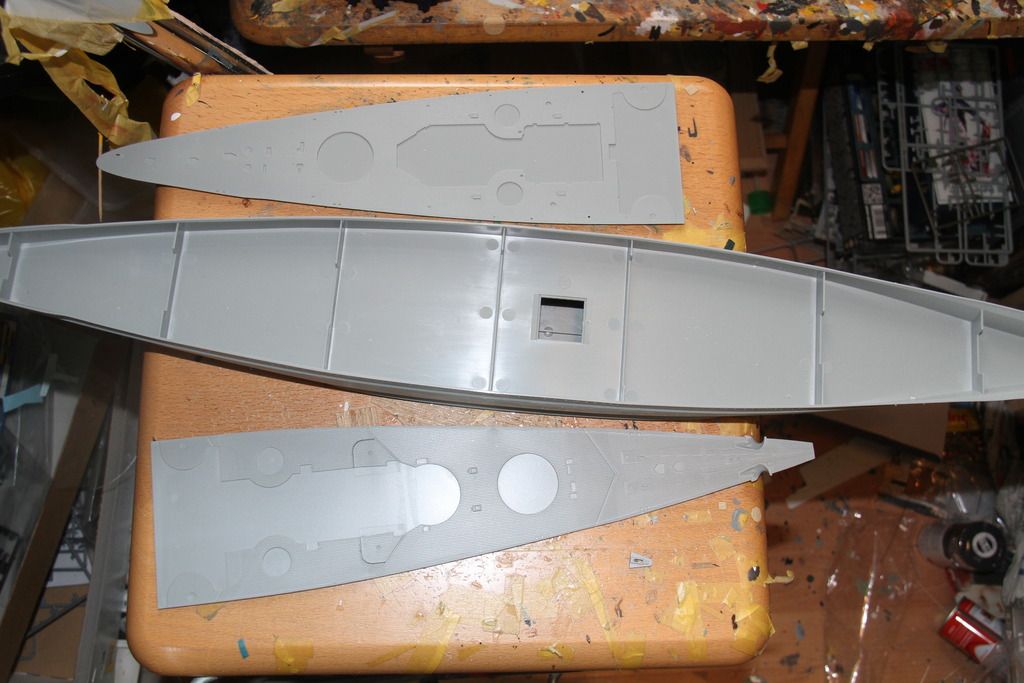

The Scharnhorst's keel is laid.
The fit of the upper hull is quite good except for right at the bow, which is slightly but noticeably out of alignment.
Fitted, not quite perfect, but will be ok after a bit of a clean up.

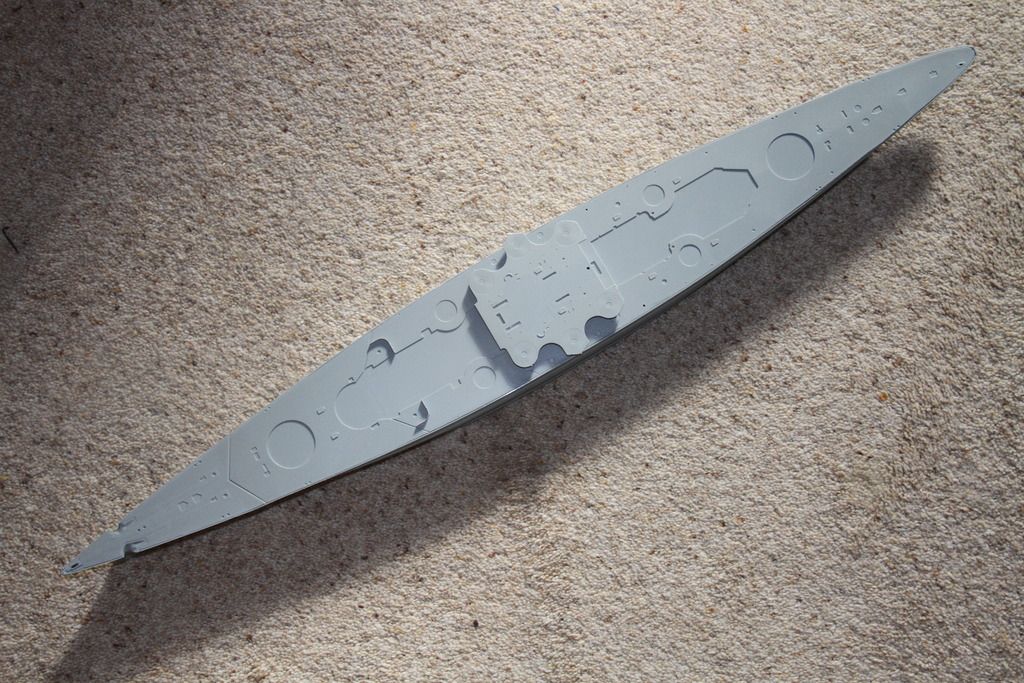

The main deck components cleaned up ready to fit.
Fitted, the midships 4.1" gun deck test fitted to check the maindeck fit.

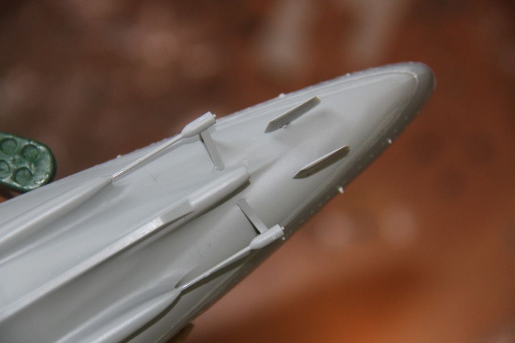

Prop shafts and rudders in place.

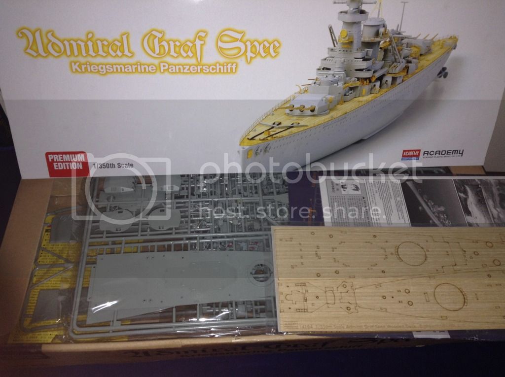

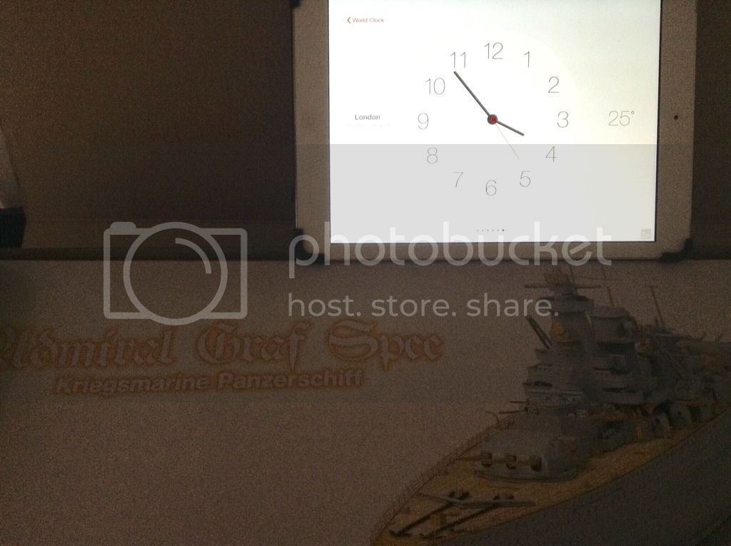

Posted: Saturday, August 01, 2015 - 08:35 PM UTC
Firstly sorry about the photo quality they were taken with my iPod instead of one of my cameras.
This is my entry, it's the premium version so comes with wood deck and pe as standard. The only additions will be replacement 20mm guns on the deck as the kit ones are poor.

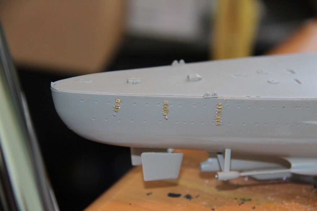

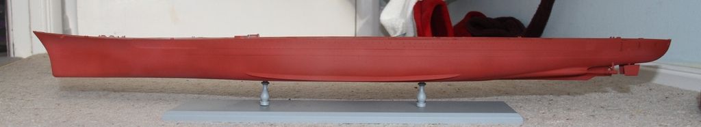

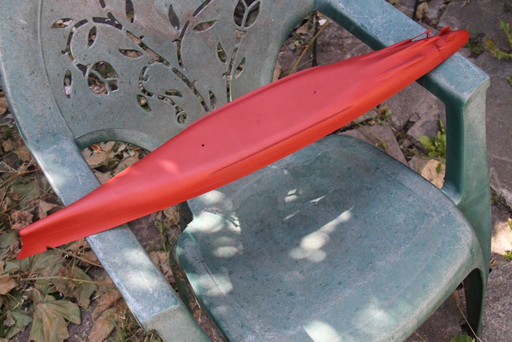

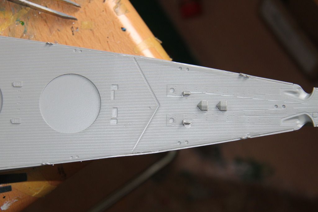

Today's progress,
Fo'c's'le and quarterdeck details that the wood deck will fit over, and deck edge fairleads fitted. This will reduce the risk of glue marks, and aid the fitting of the wood deck.
The iron ladded beefed up with some steps from left over etched vertical ladders.
The hull sprayed Halfords red primer.
and a top coat of Lifecolour German anti fouling red.
boot topping and camo next.
Cheers.

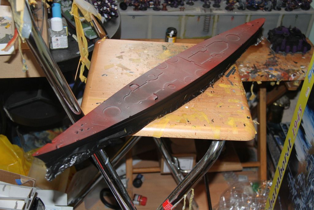

Posted: Tuesday, August 04, 2015 - 11:41 PM UTC
A small piece of progress on the painting.
the lower hull masked,
and the upper hull sprayed black, this will be masked off for the boot topping.
