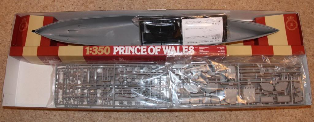

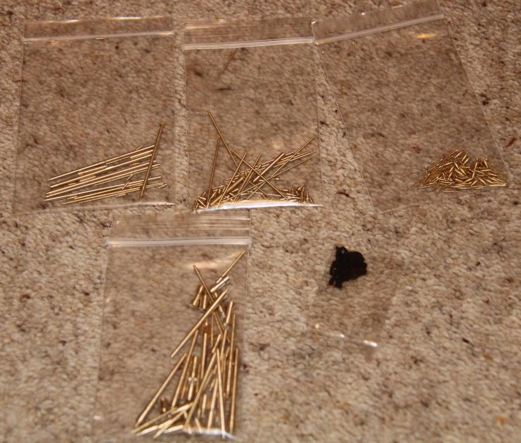

Well here's my entry: I'm building HMS KGV as of May '41 when she took down the Bismarck. I'm using the Tamiya POW as the base kit...
and modifying it to the KGV using these...

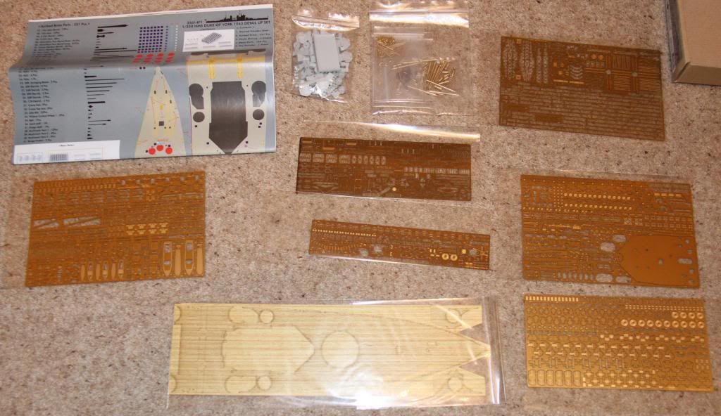

Shinsengumi wood deck and WEM PE
model master barrels and oerlikons

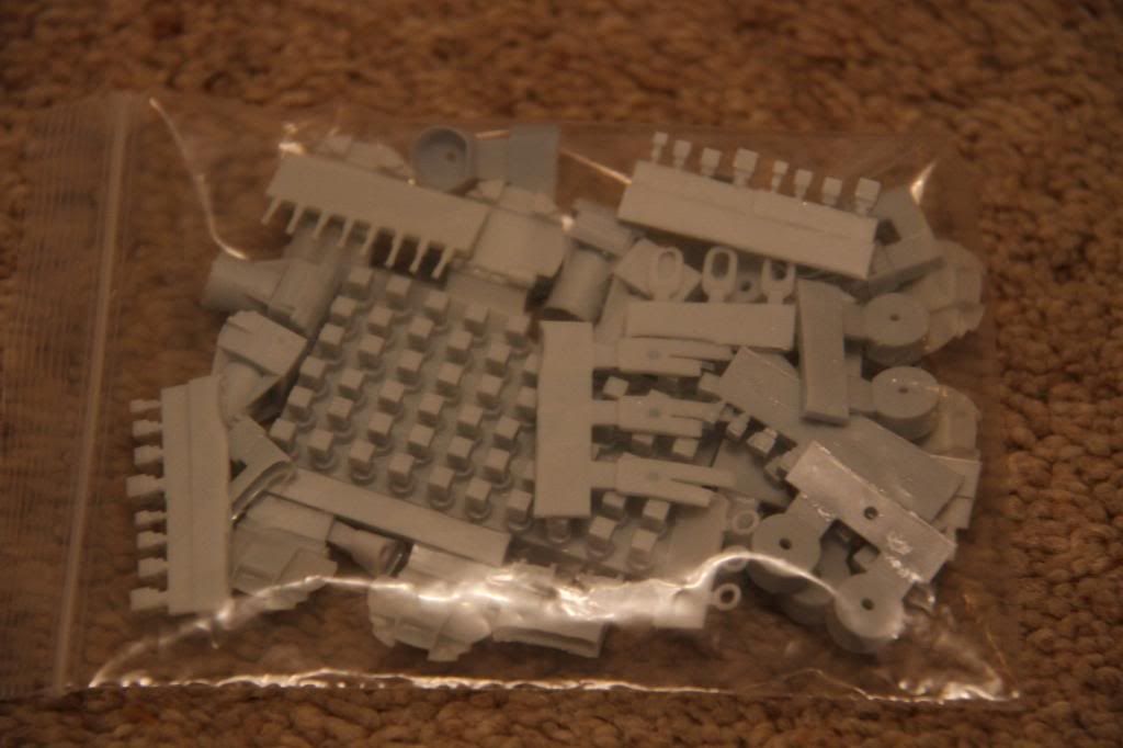

WEM Resin UP launchers and 8 barrelled pom poms
and for references
Happy building...

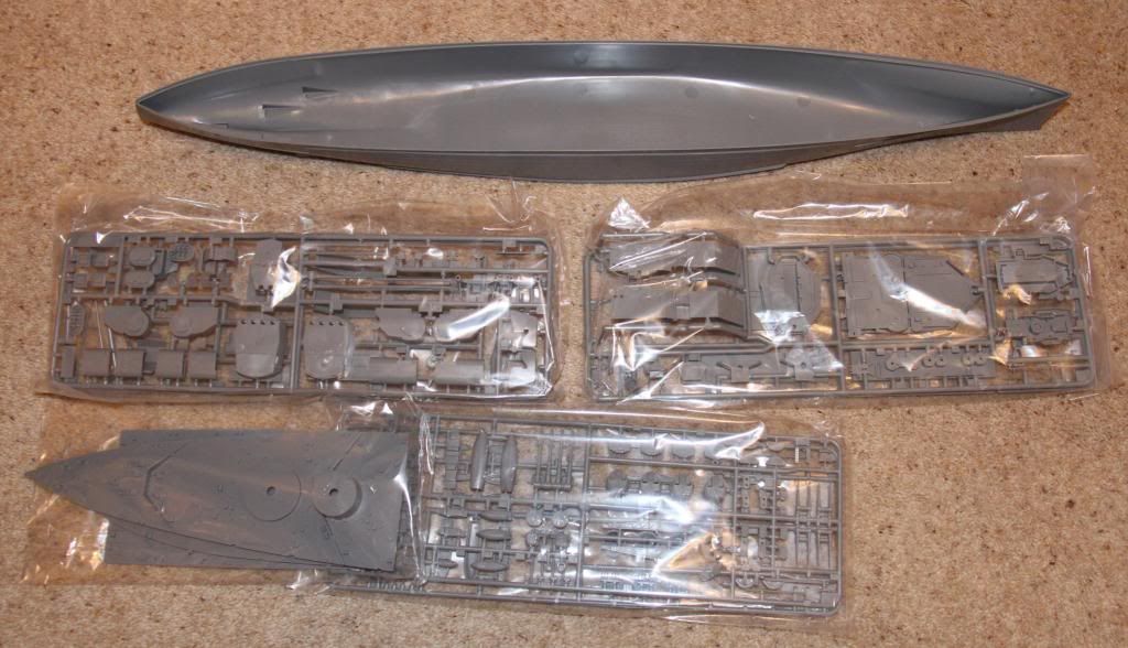

Well here I go as well and guess what I,am doing the KGV but using the Tamiya KGV with the white ensign PE set. This build will be more of an introduction into using the PE on a 350 scale model for the first time so will be asking for some help form Simon and Russell as well as others and just basic copying your work as I,am totally lost in this scale more used to 1/35 and 1/72 scale subjects so this is were the nightmares begin

Holy moley Si, that's a lot of aftermarket!!!

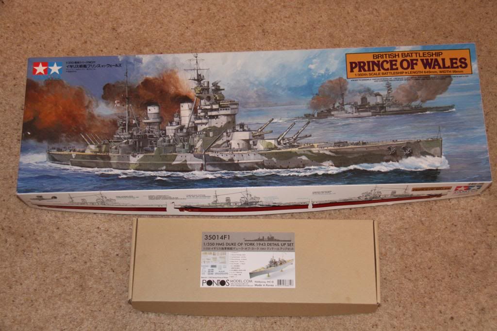

There is quite a bit Russell, and all comes in one box, your collection is non to shabby either.

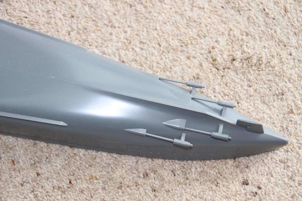

Kicking off the build, this one is going to be full hull, so propeller shafts & rudder first. don't know about you guys, but some quite heavy mould seams to clean up, but all went together pretty well.
Looking at the kit deck & the Pontos deck, most of the detail is going to need to be removed, and that will have to be done prior to fitting.

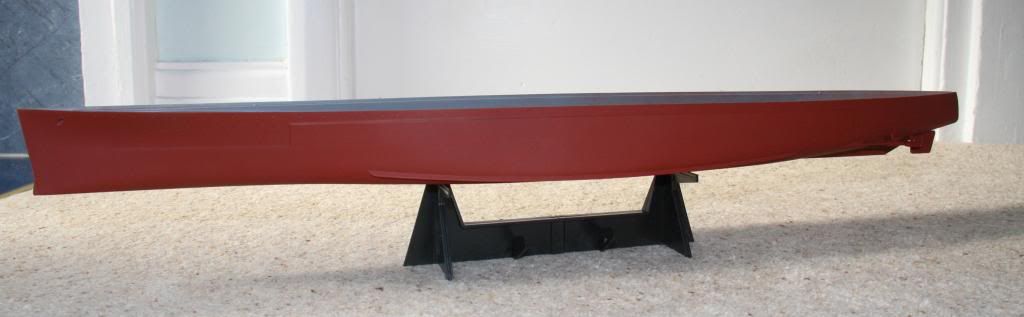

But as it was a nice day, out into the garden to shoot some Halfords red plastic primer at the hull.
I will be using this as the anti fouling colour.

Wow Si, talk about clearing the decks! Pontos sure do expect you to replace a fair bit don't they?

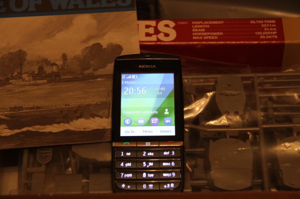

3 tries and I couldn't get my cellphone time and date to comeout in the images I took. I may have to go low-tech and but a newpaper.

Must have been unlucky with my pop shafts then. There is a stuff to replace the removed detail, and incorporate all the differences between the POW in '41 and DOY in '43

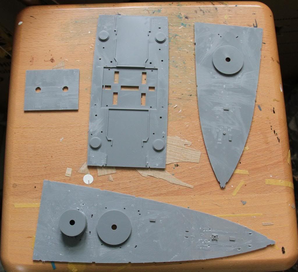

All the maindeck components cleaned up.
and fitted, almost perfect, just a lick of filler at the very bow, all down the sides and the three transverse joins, perfect.

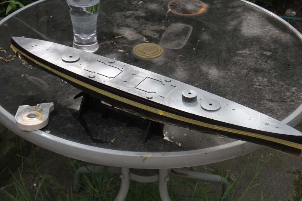

The lower hull masked off and sprayed with Citadel Chaos Black. (I know it looks grey, but it is black, just the light)
The boot topping masked, the black does look black here.

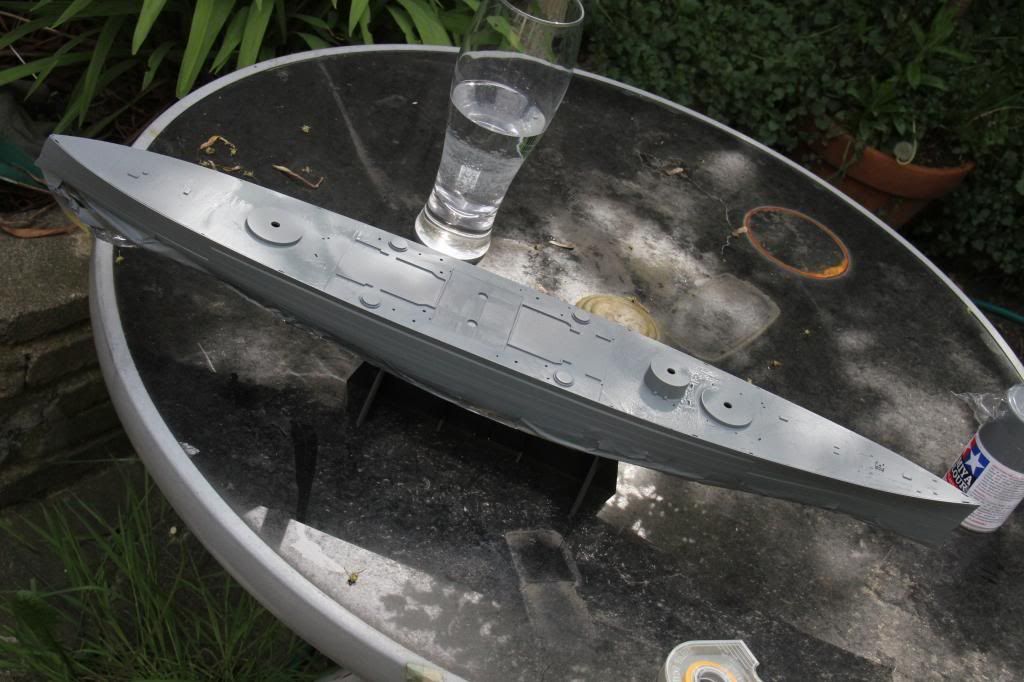

Then shot with Tamiya TS66, yes I know it says Kure Arsenal grey on the Tin, but it is so close to AP507B, especially over a black base it works for me.

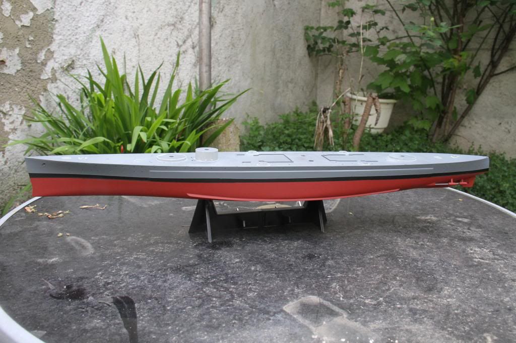

Finally the masking removed and the barbettes, main & secondary picked out in XF80 (AP507C).

Simon very neat paint job and decking fit

Thanks Keith, The deck was a very good fit, as long the bow & stern sections are fitted first. The Halfords red plastic primer is good stuff too, and close enough to anti fouling red as to make no odds,
