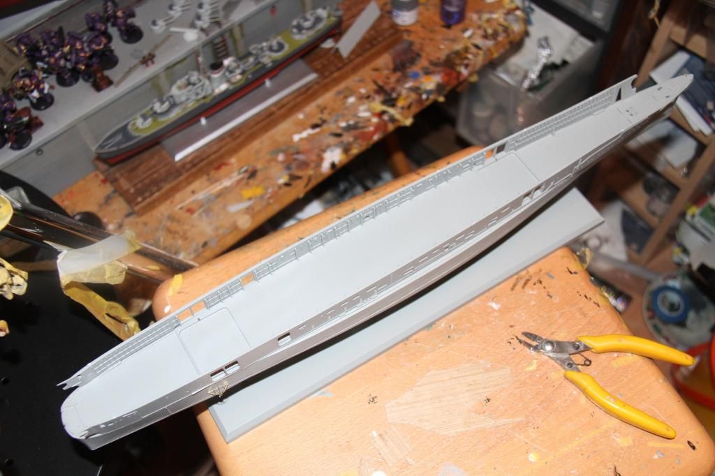

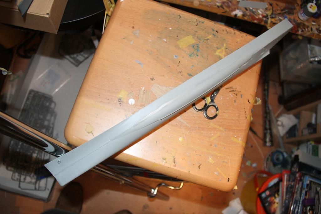

Posted: Sunday, November 09, 2014 - 01:19 AM UTC
Getting the Independence under way.
First the scary bit joining the upper lower hull, did not look to get off to a good start.
but with some gentle easing and some trusty "Mr Cement" no real issues.

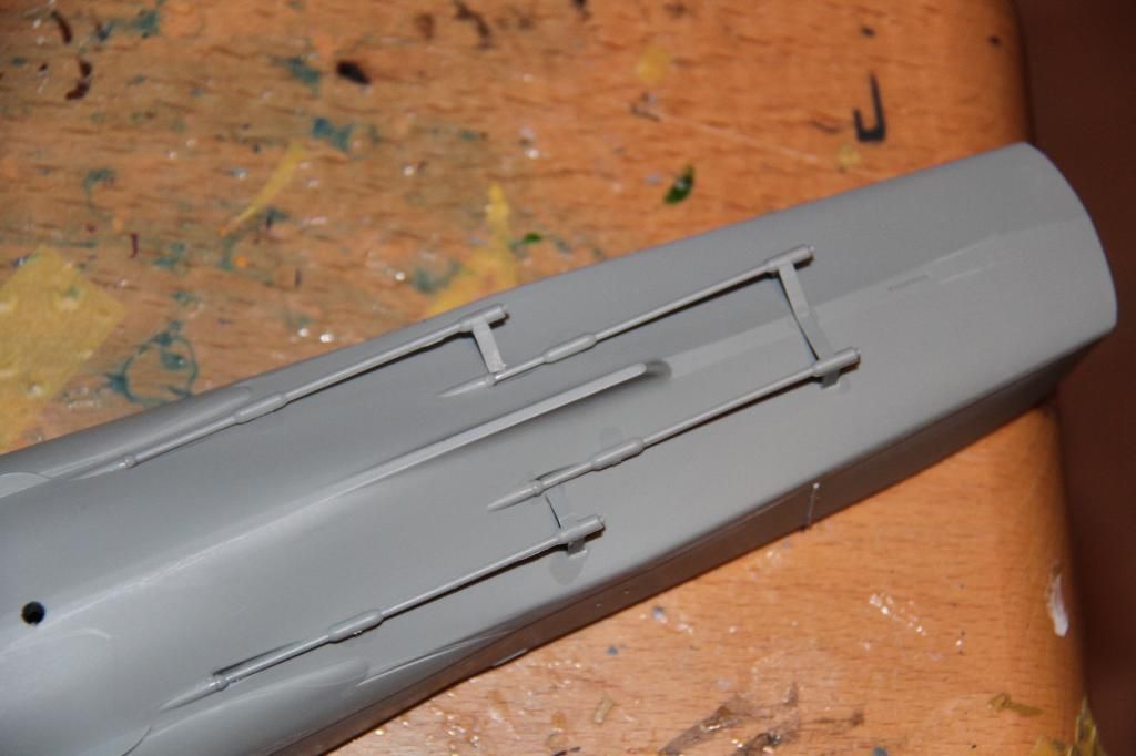

Prop shafts fitted.

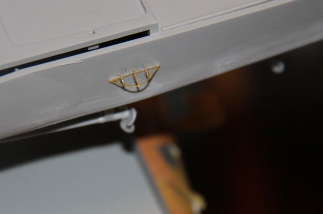

The WEM prop guard built up on the fret.
and fitted.
Props, just visible, and rudder, not visible have also been fitted.
Next thing is to work out how to paint this thing. I think the hanger deck first, build up the hanger interior pre paint that, fit the hanger bulkheads, mask the interior than the paint the hull.

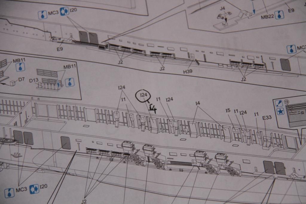

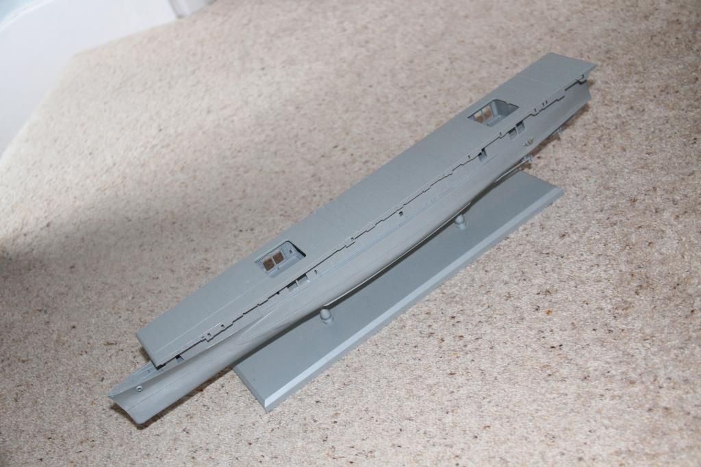

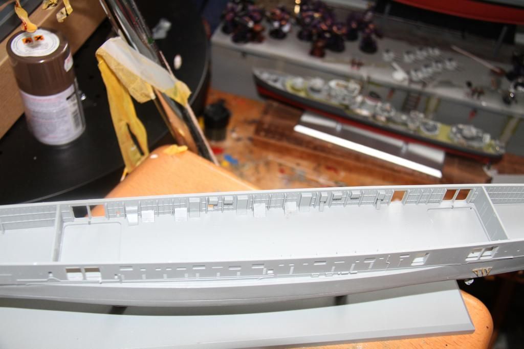

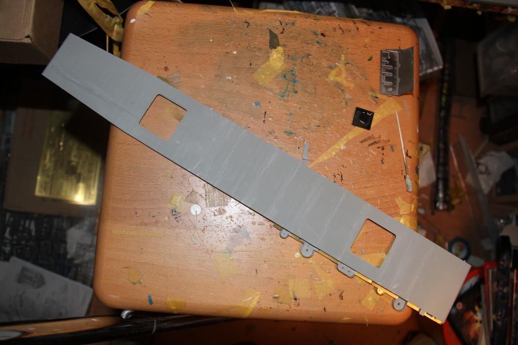

Posted: Monday, November 17, 2014 - 01:59 AM UTC
No problems Dave, as away.
First numbering error in the instructions, this one is obvious,
Will keep annotating the instructions as I go along.
Detail added to the starboard side, no issues with the instructions on this side.

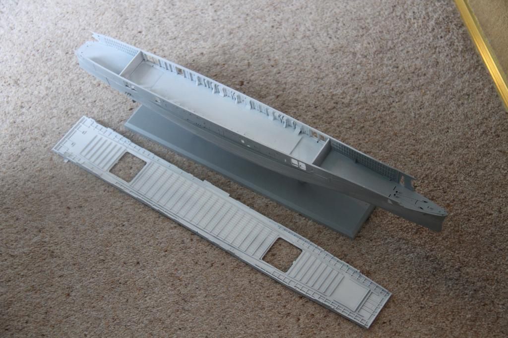

The flight deck test fitted.
and a good fit it is.
the hanger bulkheads and the underside of the flightdeck sprayed with citadel "Skull White", Ths ill be masked and the deck sprayed deck blue.
Stated to remove the moulded on detail is being removed to take the pontos pre stained flight deck.

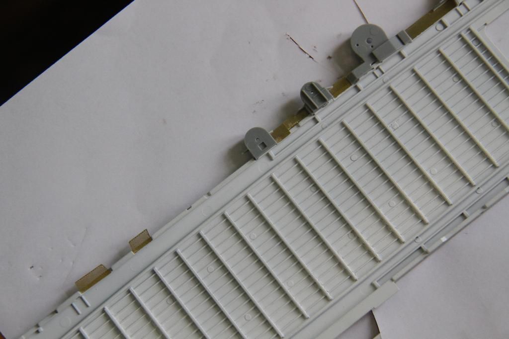

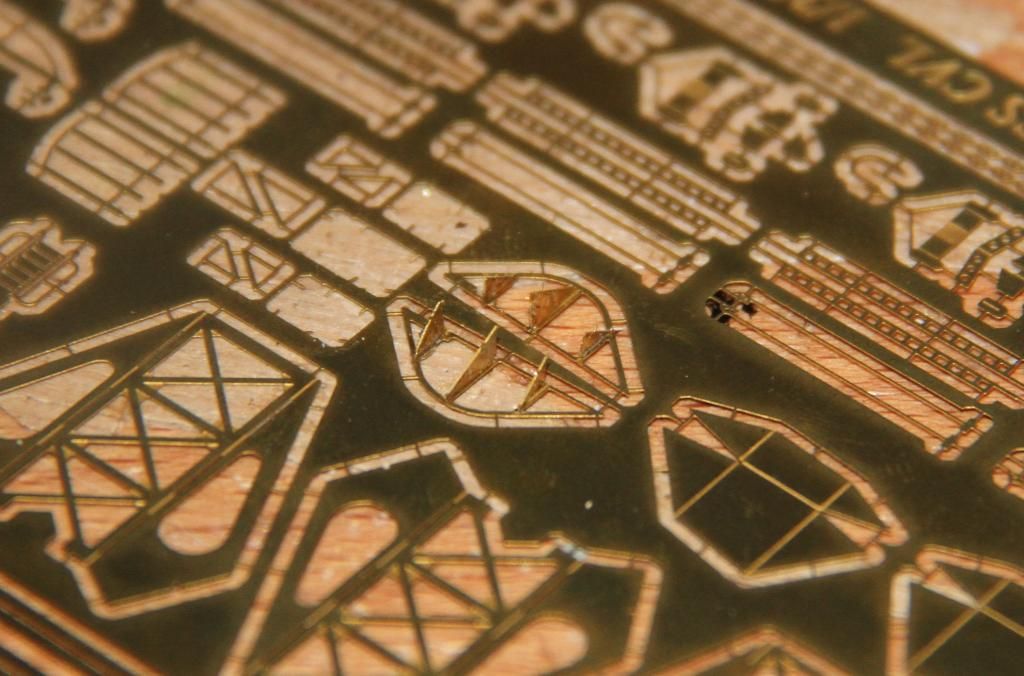

Posted: Sunday, November 23, 2014 - 04:20 AM UTC

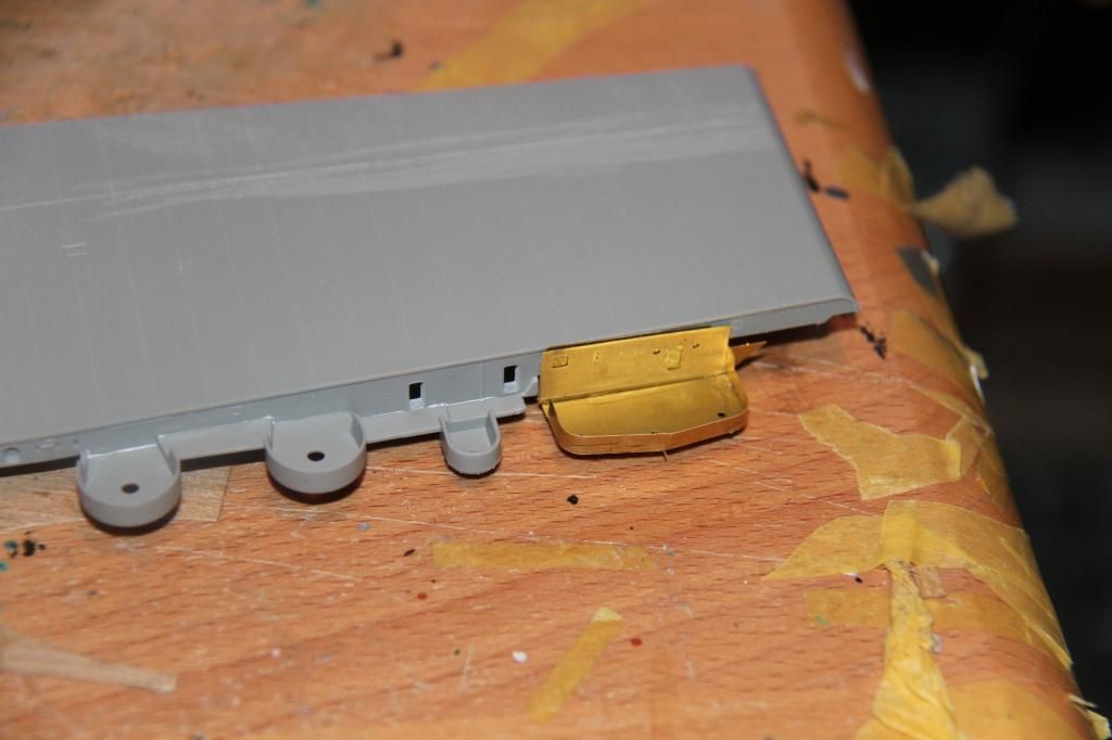

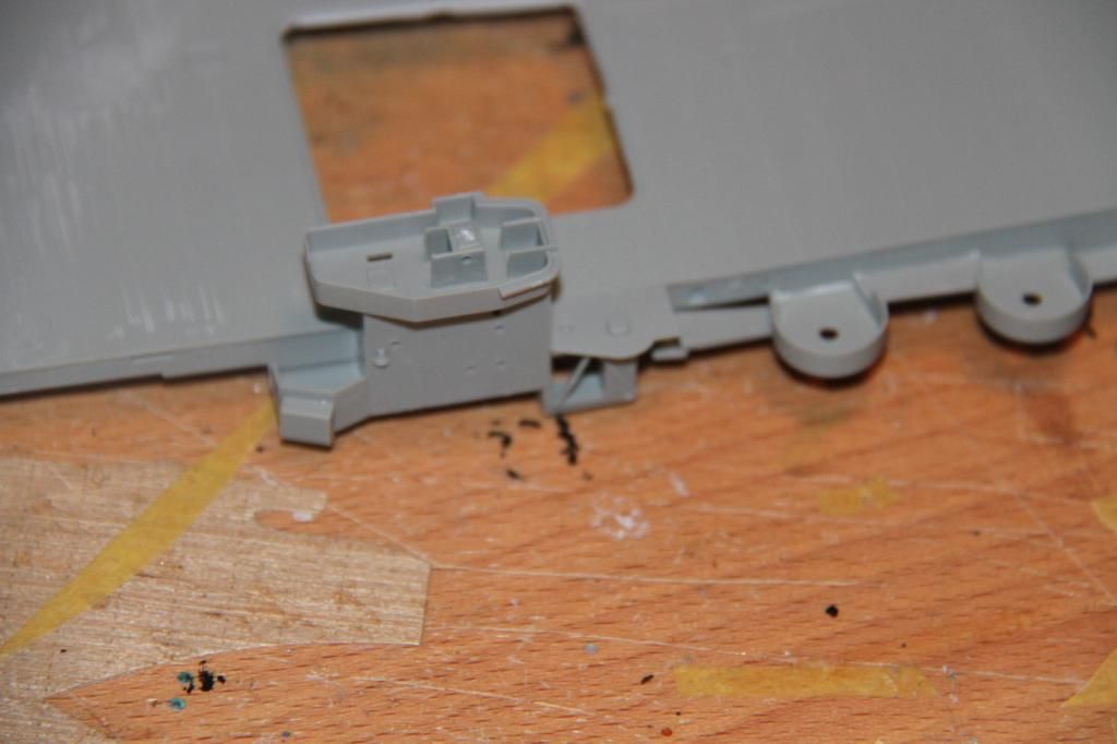

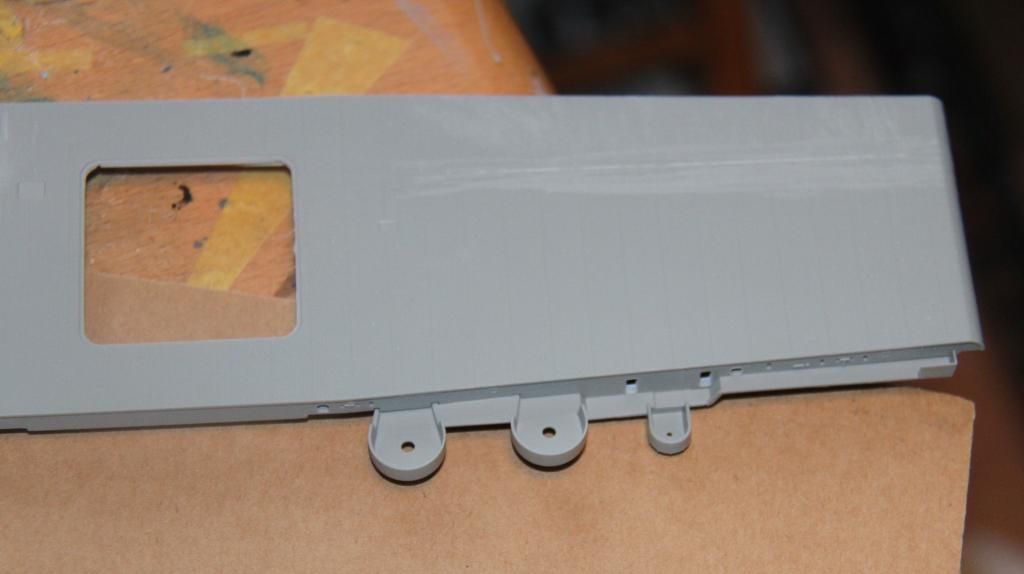

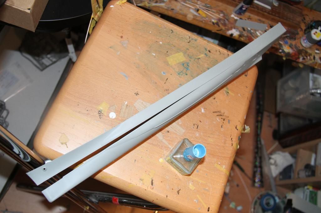

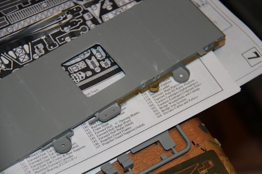

In preparation for spraying the deck blue, all the catwalks will need t be fitted to the flight deck. starting starboard forward. Not 100% sure, but I believe she had the extra gun tubs fitted forward at the time of Leyte Gulf,
The starboard forward catwalk test fitted.
the WEM brass parts under construction.
The forward catwalk shortened to take the new gun tub, the WEM brass did need a little fettling to get to fit.

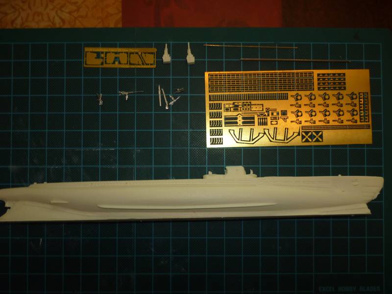

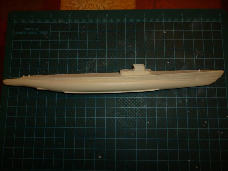

So I started with the USS Dace, a 1/350 Yankee Model Works USS Gato.
I cleaned off the resin seams along the bottom of the hull and removed the 20mm pedestals on the front and aft sections of the conning tower and cleaned up some other seam issues. The area where the rudder connects to the bat had major mold issues so I removed that and will scratch build a replacement.
Im pretty happy with the initial cleaning and will continue to clean of additional molded details like the anchor and the escape trunk hatches and opening the forward torpedo tubes. I plan on replacing the kit 20mm with Model Master 20mm, a veteran or L'Arsenal 3"/50 main gun, and a single 40mm bofor if I can find one.
I am waiting on a copy of the build plans from Floating Dry Dock, should be here within the week which will allow me to get a little more in depth.
Once I get the Panther's done I will add the IJN Maya to the Dry Dock and begin building the scene. I still haven't decided on a above/below diorama yet but I do plan on depicting the USS Dace torpedoing the IJN Maya. Just not sure how I am going to build the scene.
Well that it for now. Again hope everyone's build is going well. As always comments and suggestions are welcome and desired.

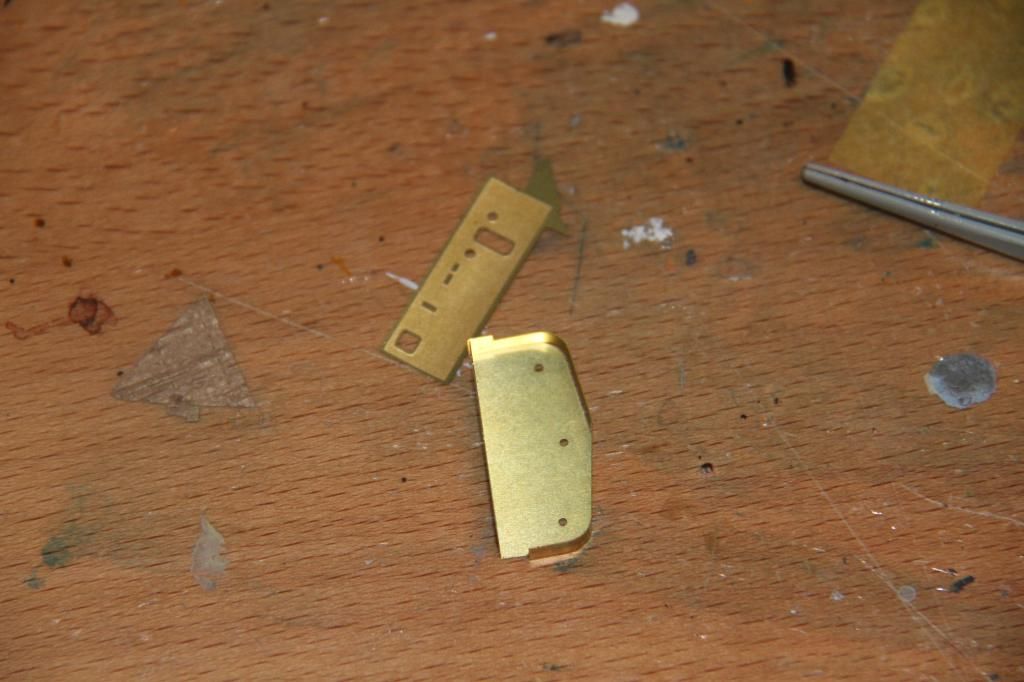

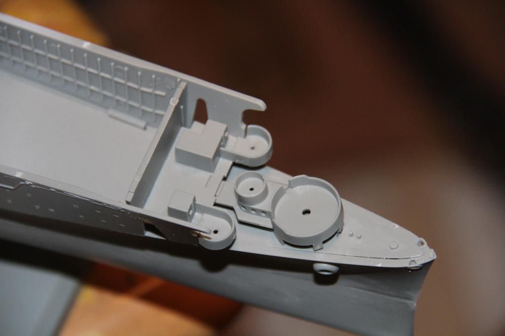

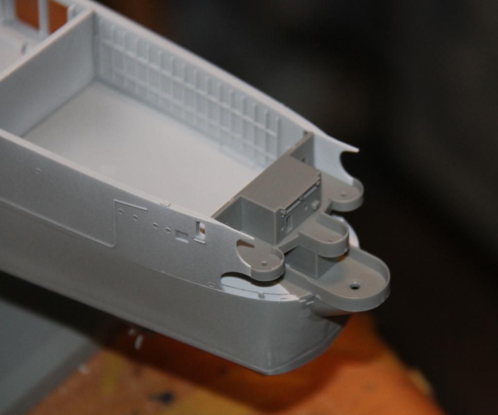

Posted: Sunday, November 30, 2014 - 02:24 AM UTC
Interesting looking kit Dave, good luck with it.
On with CVL22. Master plan No.2, get everything that has deck that needs spraying Deck blue ready so I only need to spray that colour once.

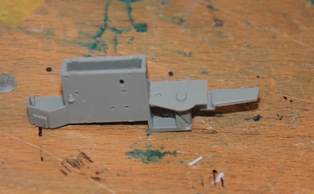

In that case on the the Island is started.
basic assembly done and test fitted.
my eyesight must be off this weekend, second pic out of focus. The other issue with this build apart from Dragon's overcrowded and from time to time mildly inaccurate instructions is WEM's instructions, which are, in my opinion slightly short on detail as to the fitting of the catwalks, at this point I have missed two sections.
Stern bulkheads and gun tubs basically assembled and test fitted.
Same thing up forward.

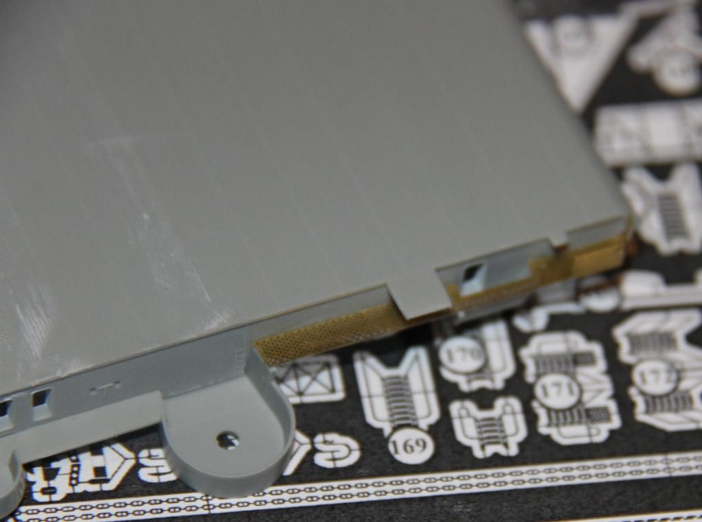

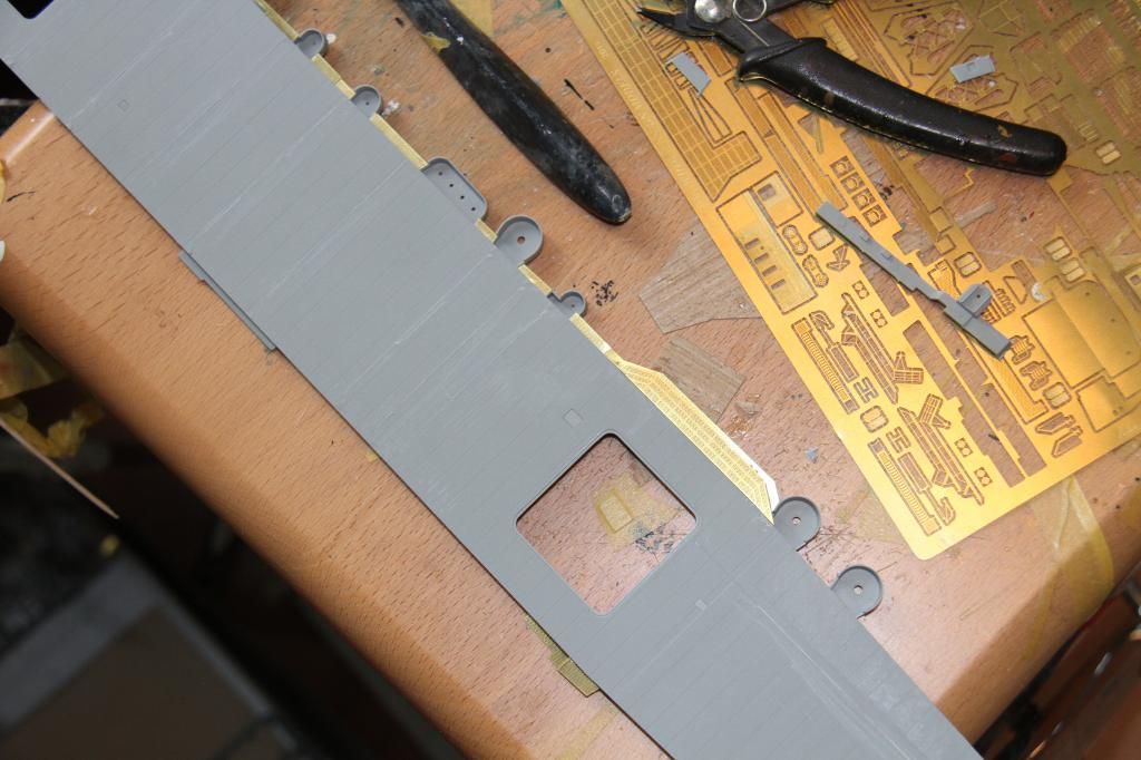

On with the catwalks, starting port side aft.

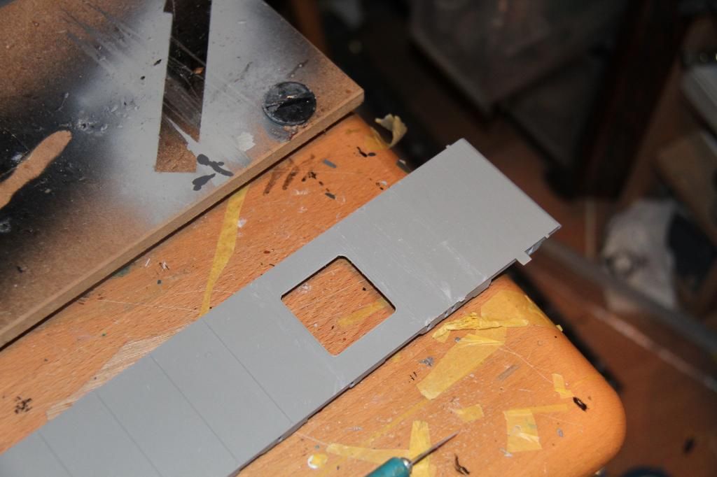

progressing forward, in removing the horizontal sections of the moulded catwalks, all the vertical supports have to be carefully left behind (Or scratch built replacements made)
Where the flightdeck is at, Starboard side forward tubs have be carefully removed now I know I have etched bits to fit, and a section of the Island catwalk (etched) you can just make out starboard forward,
This mildly infuriating in places, but I am having fun with this,

The Yankee Model Works Gato is a fine kit. The molded detail is good but since I am transforming it from the USS Gato to the USS Dace I will need to remove some detail and add others.
I plan to purchase some AM for the USS Dace, but unfortauntely L'Arsenal USA is out of stock of the single 40mm Bofors and the 3"/50 main guns that were mounted on the USS Dace. Hopefully they will have a decent restock date. So far that is the only AM company I have found with both the single 40mm and the 3"/50 so my options are limited.

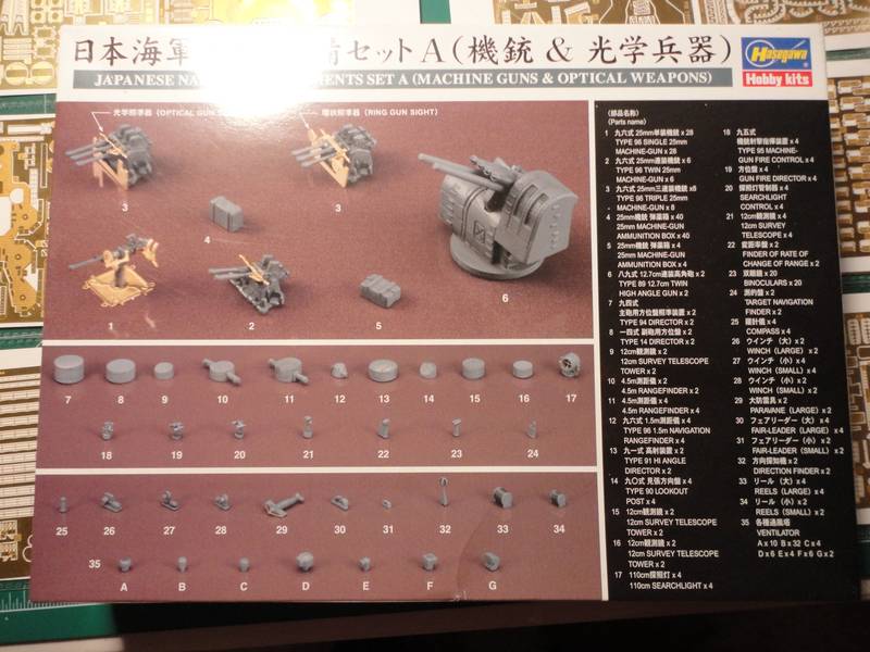

Hope your builds are going smoothly. So here is the second part of my update. Below are the AM kits for the IJN Maya.
Hasagawa's Japanese Bat set. I may not use much from this kit as the ones in the IJN Maya are not bad. The FlyHawk PE kit addresses those to make them pretty.
Along with the Boat Set is the Hasagawa Optic and Weapons Kit.
I will use some from this as the kit weapons are not that sexy.

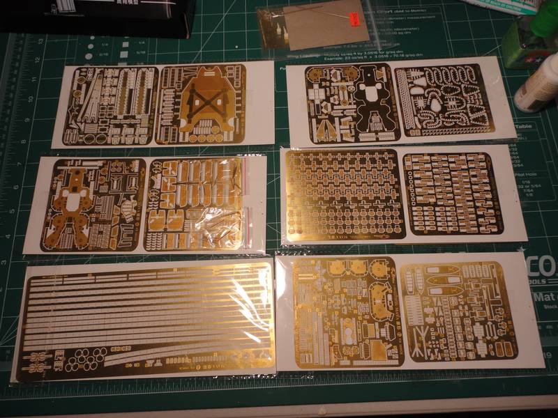

and now for the FlyHawk Kit:
Very extensive kit. with 8 sheets of PE. The two not shown are on the backside. This kit goes so far as to address the support beams under overhangs. I am excited to start working with it.

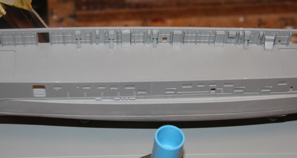

Small progress on the Indy.
underside view.
nearly there on the port side.
