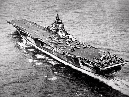

Ok.  Calling all armchair admirals!  I've got Dragon's Lexington that I'm going to build as the Hornet.  Sailing with her will be Dragon's new premier grade San Diego.
Question...how many of each aircraft would sortie on a strike? I've done some research through NavSource, but the numbers don't sound right for a major raid. 16 F6Fs, 5 TBFs and 7 SB2Cs. I know I've seen deck loads of aircraft warming up. Does have any info that can help? The only action reports I can find are for the Enterprise CV-6.

I think the answer is "it depends".  Specifically, on what the immediate and follow on taskings are for each ship in the task force.
For example, keeping some the "strike" aircraft (TBMs and SBCs) in any air group aboard on any given carrier might make sense if the intent is to launch a follow up strike against the initial target at a slightly later time (to keep planes over the target constantly) OR to keep them ready for a separate target, perhaps one not yet known or perhaps anticipated. But by the time of the Leyte Gulf battles, Task Forces and Task Groups had enough carriers, that this tasking could also be done by launching a full group from ONE carrier (which had worked together) and keeping another full carrier "on-call" and still send the same number of aircraft to conduct the strike. The trade off would be that you can launch 80 planes twice as fast if you send them off two decks.
As far as the fighters on board, the two major jobs they had were escorting the strike and air patrol over the fleet, and again the air plan would dictate how to do that. I would think that the flexibility of having multiple decks conducting the same tasks (partials from each group for both strike and CAP) would make more sense. It's faster to launch and recover, and mimimizes the risk if one deck becomes non available due to damage from an enemy attack.
I'm not sure if there was an established "doctrine" about full group or partial group strikes or not. I DO know that several carriers, like Enterprise as she became less of a "first line" carrier, WERE devoted to specific missions, such as having night fighters to cover the fleet at night. This allows each ship and its crew to have a cycle which allows for "down time" and not have to operate the air group 24 hours a day.

So Tom, what I need to do is find out what was the Hornet's strike packages were.  I did find this photo of the Hornet from 1944.

Seems strange that operations reports from that far back would still be classified.  I don't have "biographies" of any of the WW II carriers hanging around the house, so I don't have any quick way to look for any details about specific carriers and what the composition of a typical package would be, but seems to me that over the course of the reading I've done, something must have been mentioned about it.
I know that the Air Operations Officer's job is to work with the mission requirements and figure out just exactly how to accomplish it and while you always have "doctrine" to guide you, there's a lot of ways a mission could be planned and I'm not really sure if every ship and air group did things the same way.
I have a lot of back issues of "The Hook", which is the magazine published by the Tailhook Association. (Yes THAT Tailhook association, and yes, I'm a card carrying member) Over the years they've had some terriffic articles about ships and battles from WW II, and I'm going to dig through the files and see what I can find.
One doctrinal thing I do know from that period is that normal practice was to work from the flight deck rather than from the hanger deck. Planes were generally refueled and rearmed topside rather than being struck below for that. So carriers typically carried what they planned to use on the flight deck.
When you look at the photo of the Hornet, you can immediately see that as she currently is, she can only launch planes and not recover them. If those planes spotted on the fantail aren't going to be launched, then they'll have to be moved to the bow in front of the crash barrier before any planes can be recovered. And with only one deck edge elevator, it's hard to cycle planes between decks if you're doing flight ops, because taking time to use the elevator to move a plane takes away from the interval to either launch or recover because the deck isn't ready.
Modern carriers with angled decks and all deck edge elevators offer a whole lot more flexibility. Not to mention the fact that unlike the old straight deck carriers, if you miss a wire (or your hook breaks), you at LEAST get the chance to go around again.
Look at the old photos of planes recovering. Most of the time you'll see the entire front half of the flight deck packed with planes. Any missed wire and you went into the barrier, because you had no place else to go.
Anyone who flies planes off boats isn't like the rest of us!
